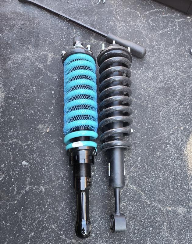

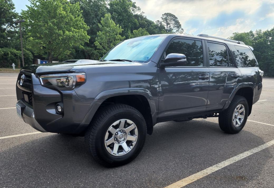

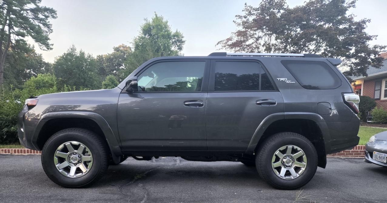

Lift received and installed same day!
Recap on what I got:
Front coils: C59-238
Front struts: IMS59-50700
Rear Coils: C59-323
Rear shocks: IMS59-50705
Installation was a cakewalk thanks to the truck being new and Mike's videos. The front went on easily with the lower control arm cams loosened and the whole arm dropped down; had to adjust the bushing eye a bit with a 3/8" extension to get the lower spring perch detent to the rear. Those lower cams call for some serious torque in the FSM - nearly 120 lb-ft. I'm sure no alignment shop does this but it wasn't much fun with the truck on the ground.
The rear was trickier but not hard. I disconnected the rear sway bar and pushed the axle down some with a little bottle jack to get the springs in. The shock upper mount area is TIGHT but I was able to get in there easily enough with a ratcheting wrench; not sure why people cut metal. The provided Dobinson top nuts were large and an odd size (18mm?). Didn't have an 18mm wrench so used the stock 17mm nuts. I did get a startling bang when tightening the shocks. I think the lower washer wasn't completely seated in the frame, but then suddenly it was. I might have had the axle jacked up too high during installation.
Measurements from center of wheel to fender are below. This is after around 20 miles of driving, so it may settle a bit more. I'll update if it does. The rear is sitting higher than expected (as in no lift), but this is on a bone stock truck otherwise with 265/70/R17 Michelin street tires. Even if it doesn't settle, I'm happy.

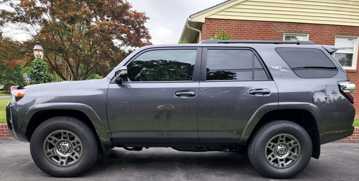

BEFORE
  • Front: 20.5"
  • Rear: 22.125"
AFTER
  • Front: 21.25" = 0.75" lift
  • Rear: 23" = 0.875" lift
Ride quality is excellent - firm and controlled but not jarring. My old 3rd gen T4R had an OME 880/906 lift with Bilstein 5100s and this is much smoother. It doesn't have the impact harshness of the digressive Bilsteins but it certainly doesn't wallow around either. Nose dive is much better and body roll is no longer alarming. My truck does not have KDSS.
NOTE: I also changed my TRD wheels to a set of 2016 Trail wheels. I got tired of the grey on grey and also seeing those wheels literally everywhere. Same tires.

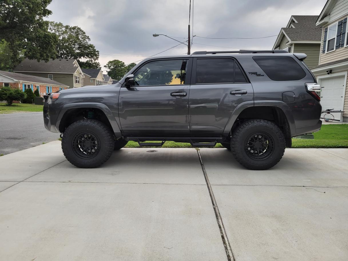

No settling in the rear so far, about 100 miles put on the lift.

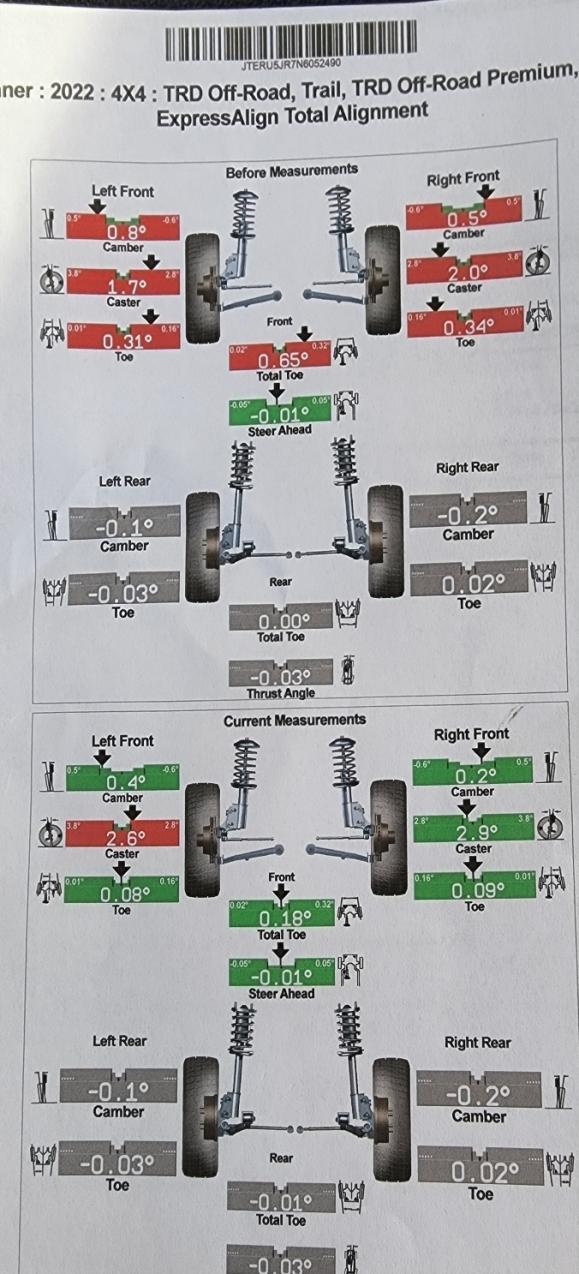

Did get the alignment done. I was a bit surprised that they weren't able to get the left front caster back in spec. The tech said there was no adjustment left.
The tech should not have let you leave without at least getting the left and right specs much much closer. You have a lot of negative caster on one side, and positive on the other. Essentially the wheel is further forward on one side than the other, which just isn't right.
Step 1. Turn the rear cams all the way outward.
Step 2. Turn the front cams all the way inward. Now it has maximum caster.
Step 3. Set camber and toe to factory spec. Caster will be reduced when these are set, but it still leaves it at max caster.
It's not hard when you do it in the right order and start from a "zero" starting point, getting the wheels in the same position to start.

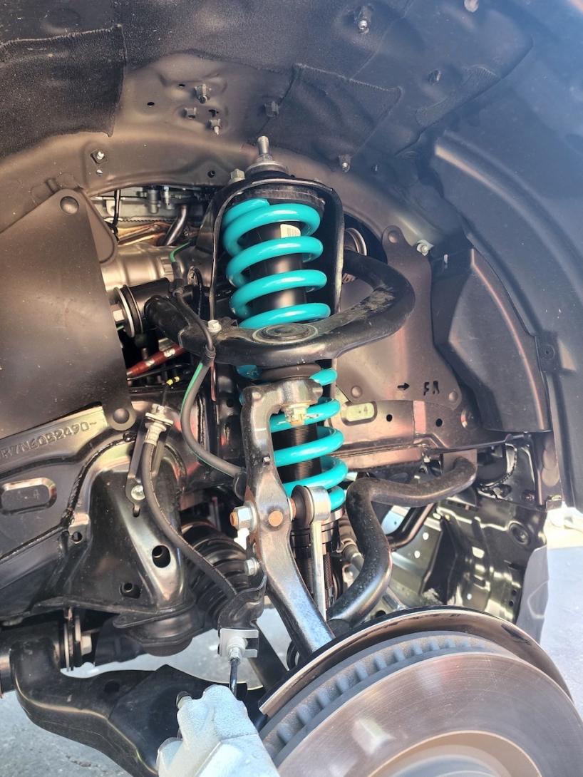

2 questions:
1) How is this bushing doing? I was told it was shot. It has 105,517 miles on it.
2) I was in the Oregon dunes over the weekend and under hard compressions in the whoops only the driver's side UCA and tire would hit the wheel well. Did I just knock it out of alignment or is there a bigger problem? Is it related to the above bushing (it is also the driver's side)? Tires are P285/70R17, and I do have durobump bump stops which are longer than stock.
2 questions:
Yes it looks like the bushing is going out. If it was torqued not on the ground, it preloaded the bushing and causes it to wear out sooner. Although you have a lot of miles too.
Replacements here:. Dobinsons Lower Strut Bushing - For -700 -574 -642 -648 -644 -228 - Exit Offroad
Your alignment probably isn't even. One wheel probably further back than the other. See the last post I made
Roger. I did the install myself and don't remember how I did it so I'm willing to take the blame. Bushing ordered. I have access to a press so I'll try my luck doing it myself. I'll get an alignment afterward.

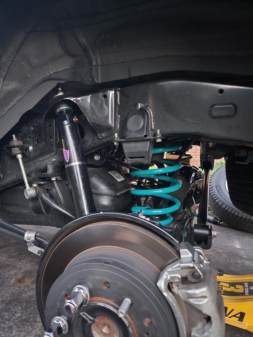

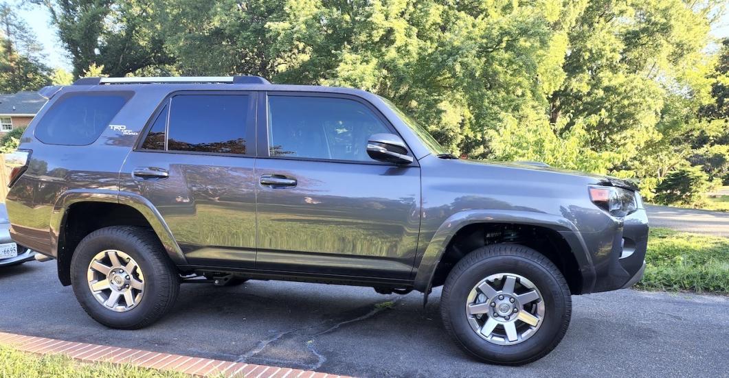

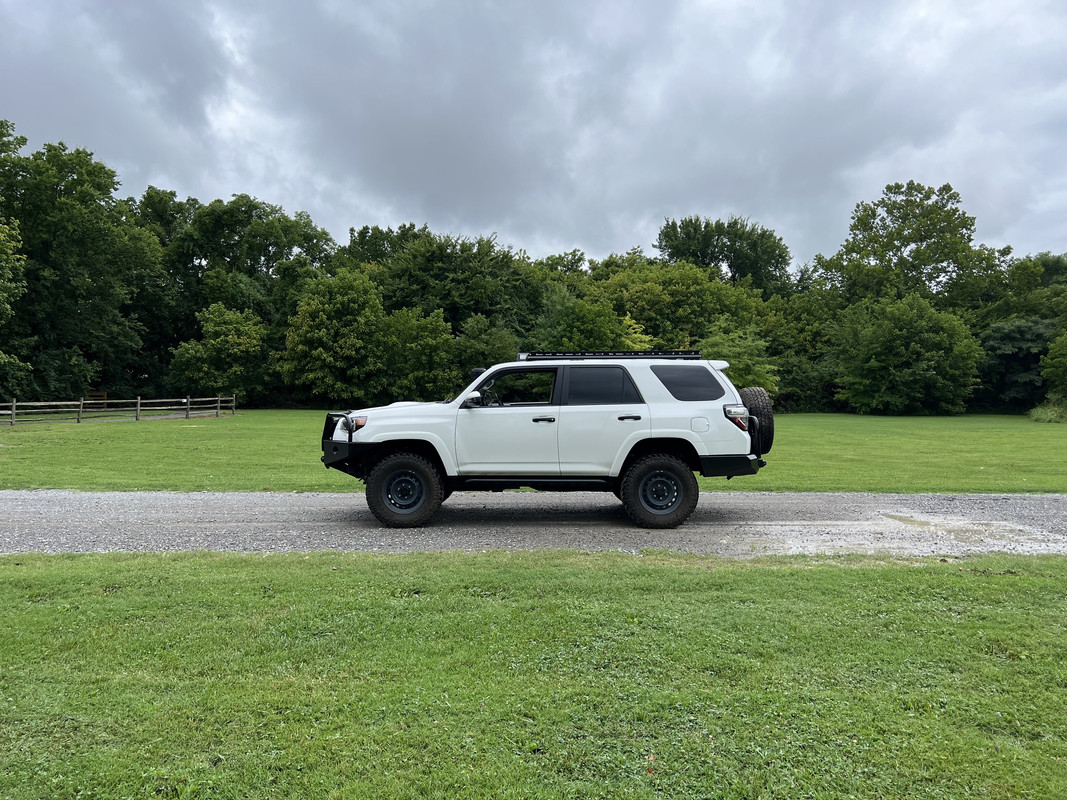

Finally got my Dobinsons lift installed with dobinsons uca.
c59-314 front coils
IMS59-50700
C59-325 rear coils
IMS59-50701
Dobinsons uca
Mike was super helpful and good advisor.

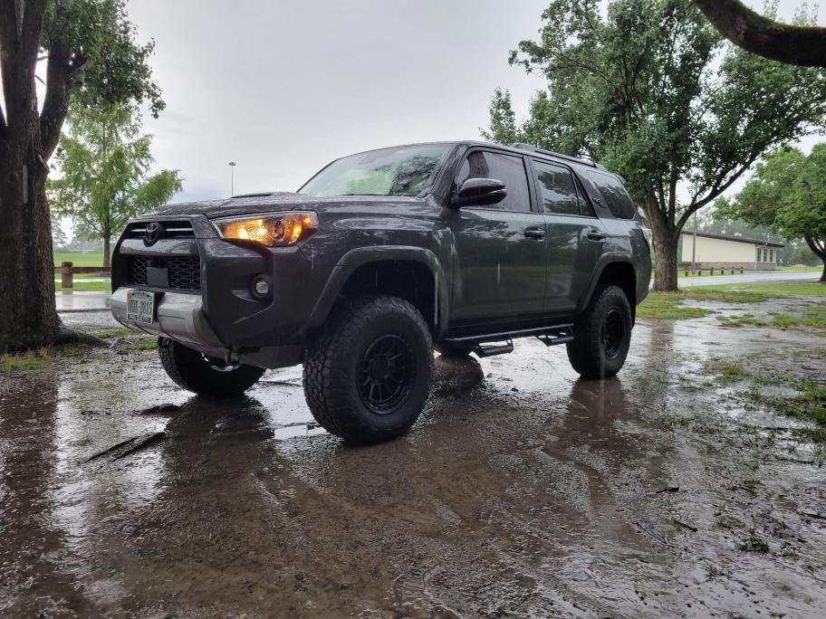

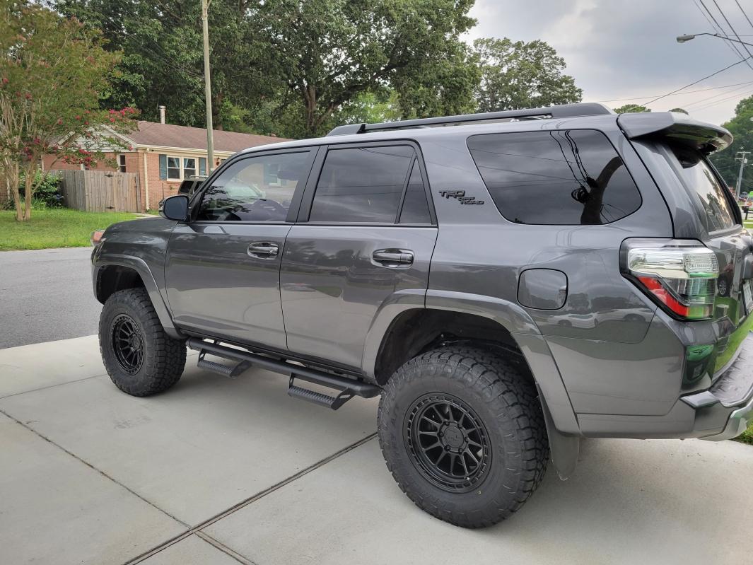

C59-354 up front and C59-327 in the rear.
Was perfect with drawers (200lb loaded) but added the Shrockworks rear bar and dropped down to about 23.5" so lost 1/2 an inch.
Spoke with Mike this morning (thanks for all the texts!) and ordered up some 701v's for the rear. Should get it back to some rake and rid the saggy butt.
Got steel trans / t-case skids, sliders, 7/8ths roof rack, drawers, shit in drawers, and bumper.
#400 of that is the drawers and bumper alone.
