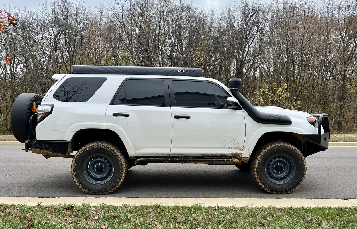

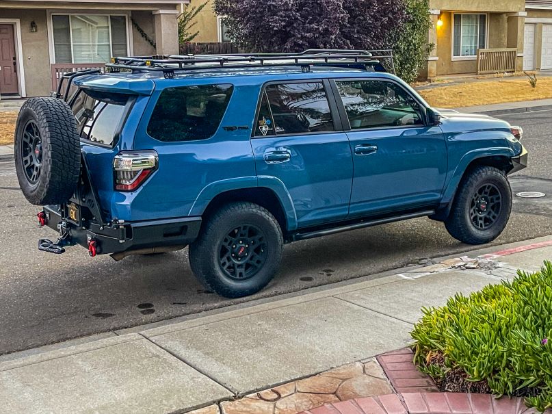

701v's:
Sliders, skids, drawers, rear bar.
Solid 3", but loaded down its perfect. The cut of the bumper makes it look taller than it is as well.
