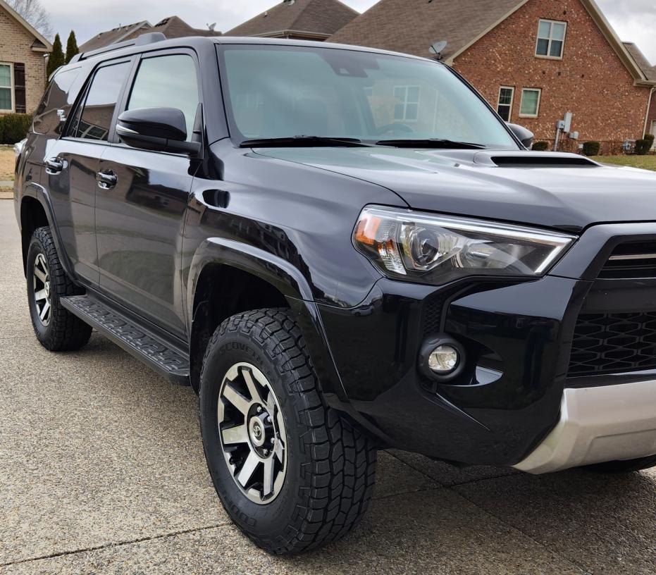

Just installed on my 23 ORP Dobinsons C59-300 & C59-599 with comfort valved GS shocks and couldn't be happier. Ordered the Exit Offroad pre-assembled. I installed it in my garage with hand tools in about 5 hours by myself. Includes a break and clean up. I have very little experience working on vehicles so I triple checked everything.
The set up is exactly what I was looking for. Mild lift and rides so smooth, not stiff but took away some nose dive and lean in corners. I've had 5100s, OME, and Ironman on other vehicles and this has been by far the most comfortable. Not apples to apples because it's different vehicles though. 275/70r17 Cooper AT3 LT going on now. Vehicle is our travel vehicle but I also go on unimproved trails and farm land every now and then. I really can't recommend this setup enough for people in the same situation.
That's great to hear!! Sounds like it's setup exactly how you wanted it. Post up some photos when you have some to share!!
5 hours is not bad at all, especially when others have taken double the time in the past on here. I'm working on another project here at home, I took 5 hours yesterday to mark and drill 6 holes!! LOL
C59-300 & C59-599 GS shocks comfort valved.
Pics don't do it justice, love it.

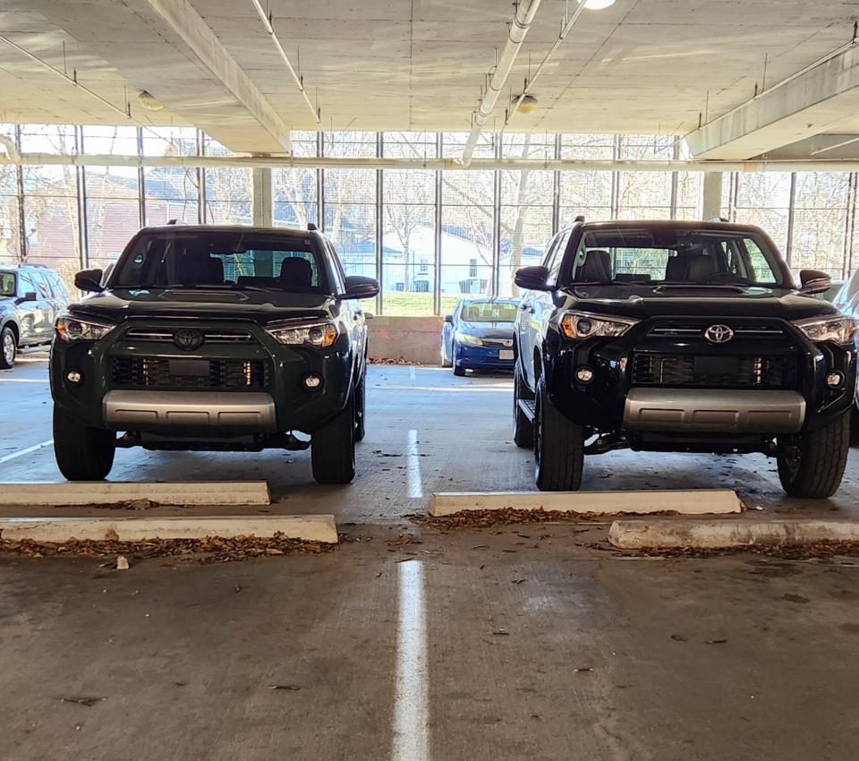

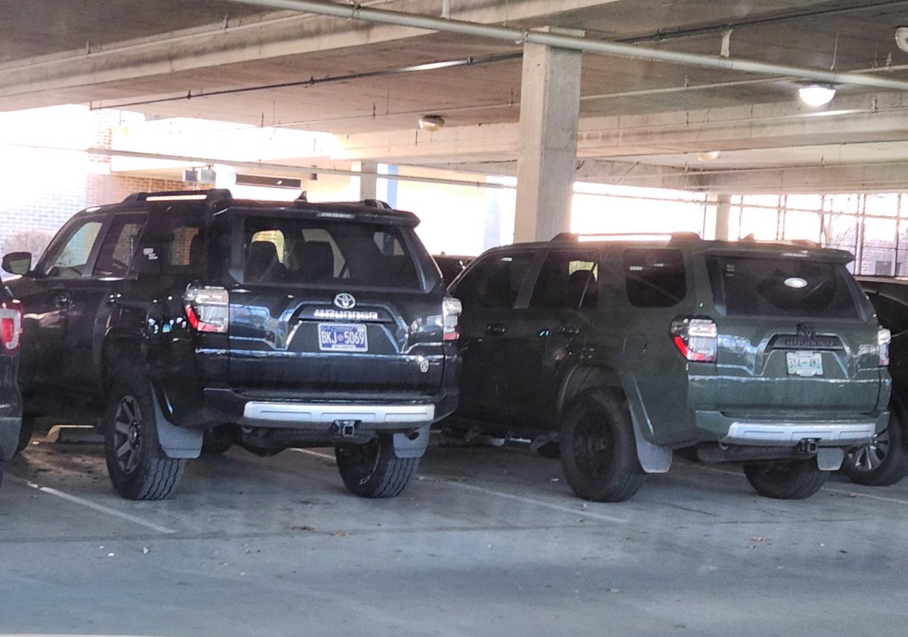

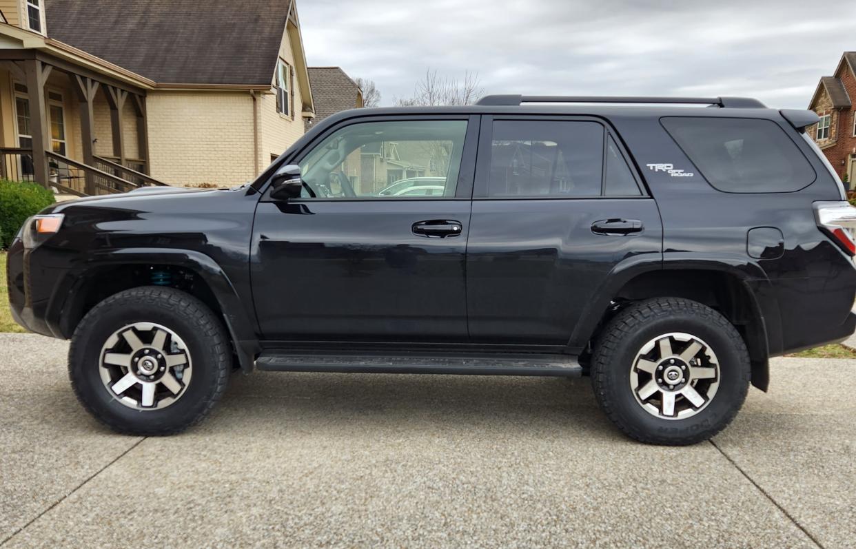

Got a few pics next to a stock TRD ORP Army Green
My set up on the black TRD ORP:
