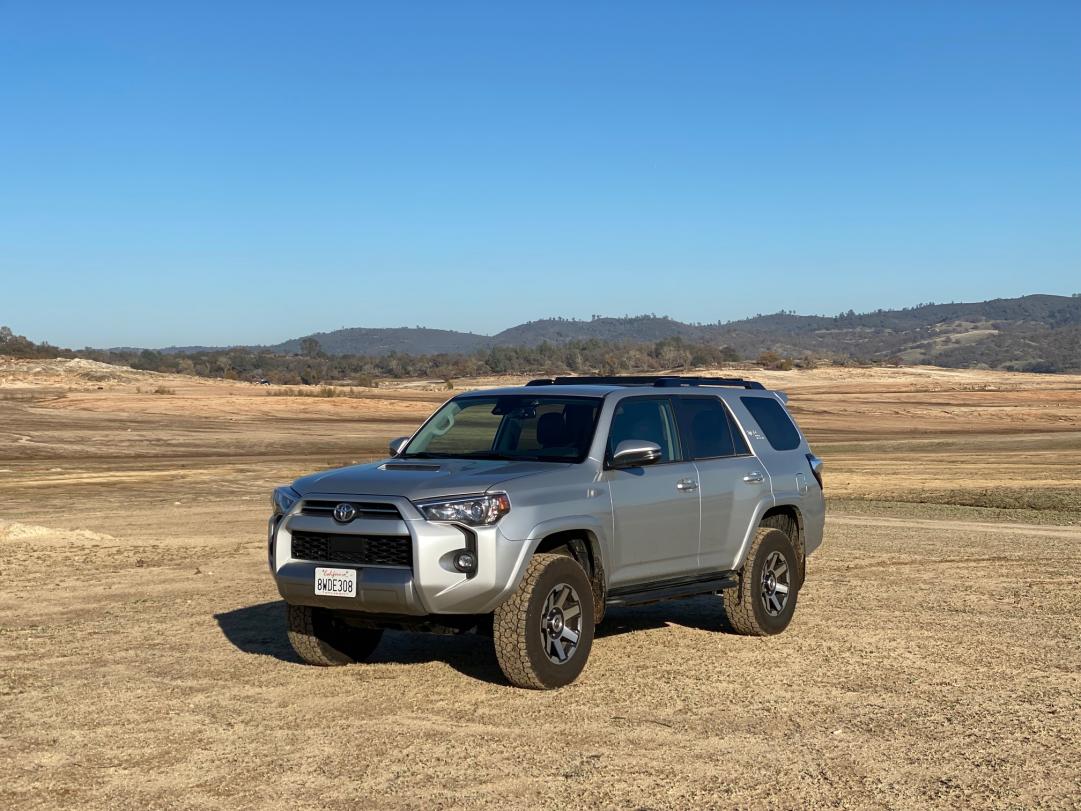

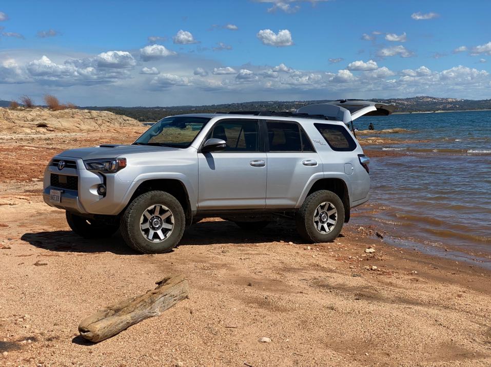

I'm running the MRA's, but have the spring setup of C59-300 in the front and C59-323 in the rear. It gave me a true a 1.75"-2" up front (which is adjustable of course with MRA's or IMS) and 1" in the back. I've included some photos, this is running stock size tires as well. One photo has my old Toyo AT3's, the other has Wildpeaks. With this I have just a small amount of rake built in there.
