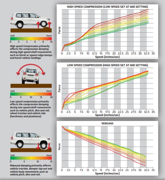

Yes I know how progressive works. I asked if having the 3 way adjustments makes the shock able to be also linear and digressive because you're able yo change the the high and low compression or if it is just different firmness of progressive and essentially just changes the curve of the progressive line because it's a progressive valve.
Progressive is in the piston and the way it functions on the inside. Digressive is a different animal, as you already know.
Changing the 3 valving adjustments makes them softer or firmer in each of their own ways, but it doesn't change the way the piston operates. It modulates the speed at which the oil can flow through the HSC, LSC or Reb valves.

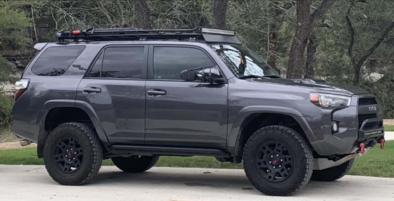

For reference I installed the FJ TRD Pro kit + daystar 1.25" perch spacer + OME 10mm spacer. Wanted to eliminate sag on heavy loads so I replaced my Wheeler T13 with the C59-327 rear springs and here's what the stance and measurements look like:
With Wheelers T13:
With C59-327:
Ground to fender measurement with Wheeler T13
FR - 36 4/16
FL - 36 4/16
RR - 38
RL - 37 15/16
Ground to fender measurement with C59-327
FR - 36 7/16
FL - 36 7/16
RR - 40
RL - 39 12/16
