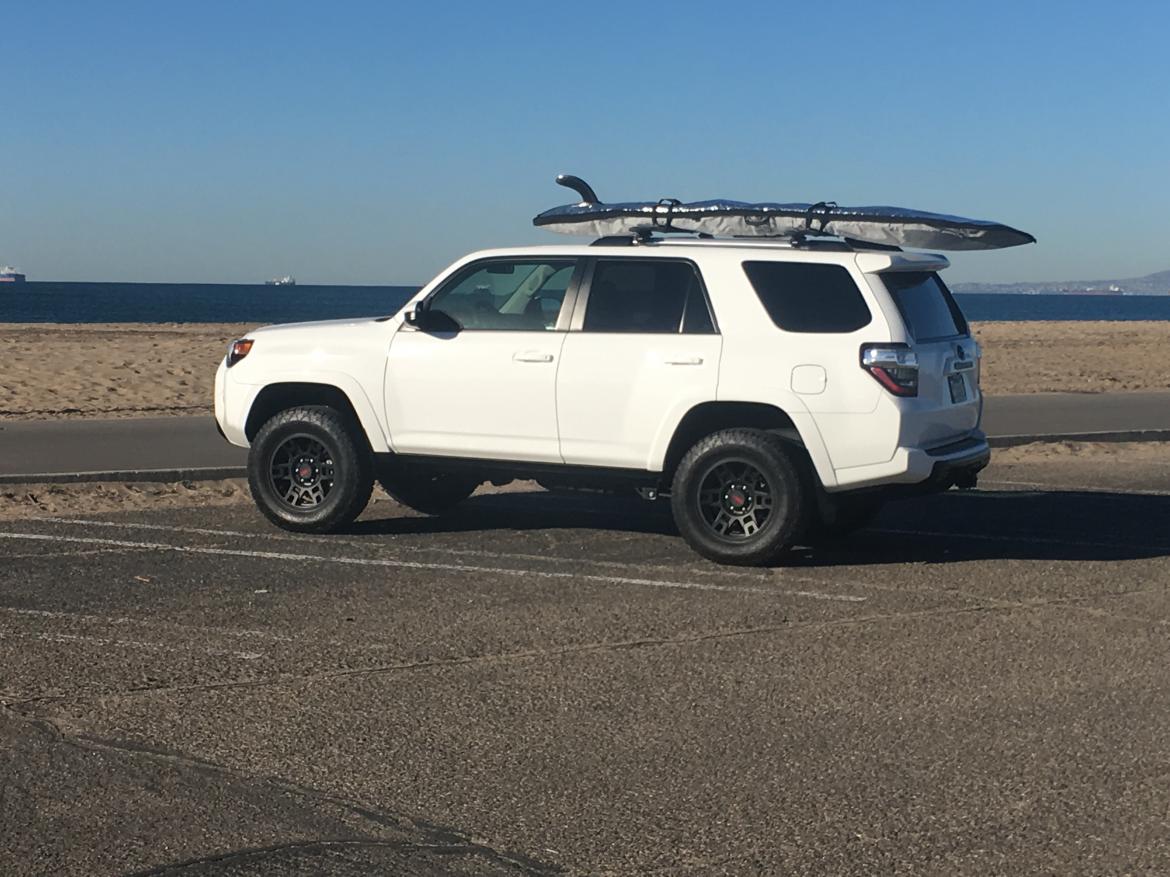

That Dobinson's setup should be smooth enough for your needs. I've installed 300/599 combo with comfort shocks on my TEP and absolutely love the ride quality/ stability improvement. Firm without being harsh. No towing (yet) but I'm certain that would not present any challenges.

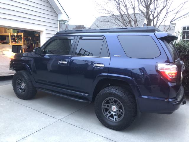

Current setup:
2014 Limited with 3rd row, daily driver, 90-95% on road, east coast trail rides, no desert runs or rock crawling
OEM XREAS with 3”/2” spacer lift & diff drop kit
285/70/17 tires
Pelfreybilt aluminum front bumper (probably +40lb net over OEM bumper components)
Second battery, +25lb
(4) Aluminum skids, +50-60lb (complete guess)
Roof rack, +90lb
Sliders, +90lb
What are your complete system recommendations for same amount lift & similar ride quality if I dump the XREAS system? I would plan on getting aftermarket UCA’s.
Thanks for your input!
On the front:
GS59-574 with C59-302 for 3" lift with the extra weight. Then add UCA's and keep your diff drop kit.
On the rear, C59-325 with GS59-701 for 2" lift with the extra weight.
You'll gain a much better ride with new longer coils and shocks than using the spacer lift that you're currently using, as it really won't compare.

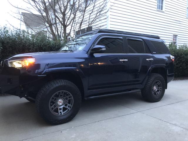

Got system as recommended by Mike above installed over holidays, except for UCA’s as they are on back order. Will install once I get them. Very happy with result. No real difference from XREAS suspension in daily driving and normal road bumps. But more compliant with larger obstacles like speed bumps and humps. Haven’t taken off road yet. Really Like the red coil and black shock color combination.
With the front setup, the sway bar just barely rub the coils. Have ordered a sway bar relocation kit to fix this.
Before ground-fender measurements with 3”/2” spacer lift:
LF=37”: LR=37-1/2”: RF=37-1/4”: RR=37-3/4”
Dobinson suspension:
LF=37-3/4”: LR=38-1/2”: RF=38-1/2”: RR=39”

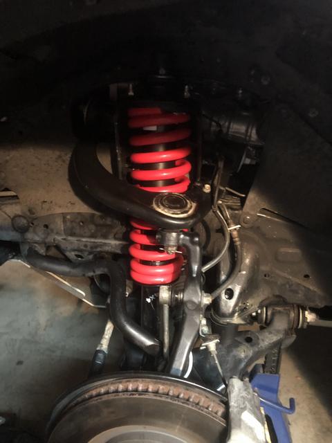

Installed c59-300 In the front and c59-723 along with dobinson struts and shocks over the weekend, rides exceptionay better then stock on and off road. No noticeable lean with the taller passenger rear springs.
Thanks for posting the pics--just ordered the same set-up, can't wait to install it.
