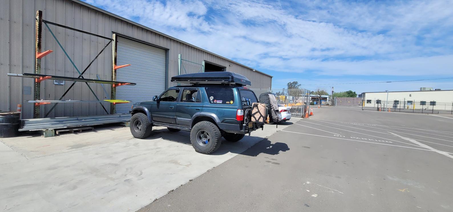

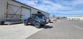

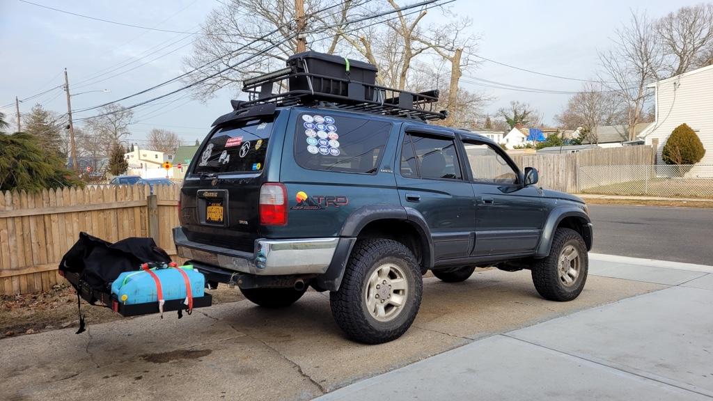

More than the 150? If I’m going on a camping or off-road trip yeah. Plus the 150 add about 30lbs for cooking stuff, about 50lbs of wood and 5 gallons of water( about 50lbs) and all that is on my back rack which itself weighs 50lbs and is hanging about 2-3 feet front the back of the car so the weight is multiplied(idk how that works with vehicles)
When I’m fully loaded there’s quite a bit of crap that’s pulling the rear end down.
Here’s a photo of what my setup is almost full loaded. Only difference now is that the hitch is not flipped yet in this photo
Also keep in mind the OME 890s only had ~5-10k miles on them in that photo. They now have 25-35k on them so the sag is a bit worse. Sorry I don’t have exact numbers

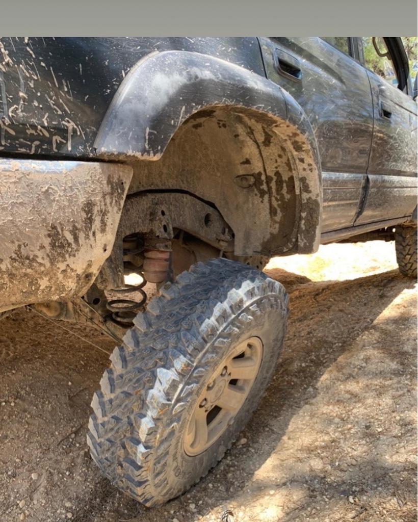

Here is a current photo of the 890s with roughly the same weight on them. Also keep in mind my tires are 1 inch taller in this photo 255/85 vs old 265/75. The cooler weighs about 60lbs and there’s no wood on the rack but probably 10lbs of garbage in that black bag. You can see there’s not much gap left from these coils

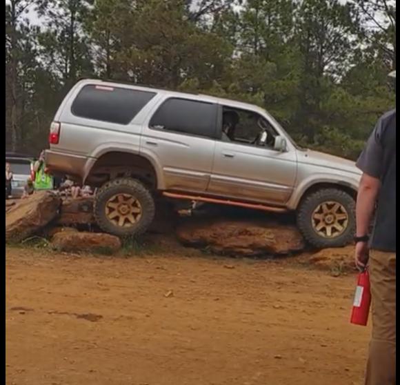

I run Airbags and OME 906's with the Nitrocharger shocks..
I can max my flex no problem...
I think my shocks are longer than the nitrochargers. My shocks drop my 33” completely below the rockers. I also run no swaybar in the rear anymore since a link snapped. What’s involved with running airbags? How have they been for you?
The go inside the coils, the air line runs out the top of the coil bucket through an existing hole. I ran individual air lines through the frame, and put the valves in the bumper step pad. I was actually aired up to about 30psi in this photo.
I ran all over the Ozarks fully loaded at 40psi and it was great. I would not run a heavier spring to compensate for temporary loads. I have had these on 3 different rear suspension setups now on this particular 3rd gen.
