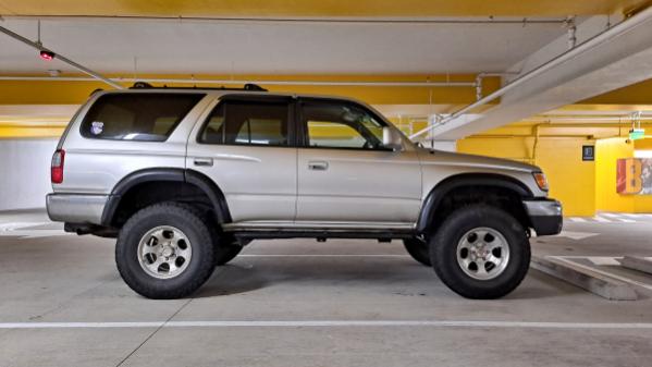

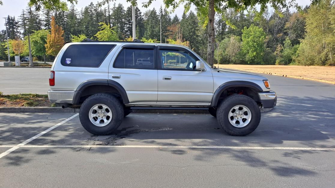

You may want to look into the LC80 springs. I had mine on for over 100K miles and right before I swapped them out they were settled quite evenly with the front, or at least I thought.
Here's a picture with the LC 80 springs. But again, still lifted in the front. Not sure how this would look with no front adjustments.

Here's a great photo of the rear loaded down with probably 10 sandbags or so. They were about 30 pounds each, maybe? But I think this might be a good reference point in terms of weight and sag.

How much lift would you say you got from them? What size tires are you running in the photo?

Sorry to let you down brother but I don't have exact numbers for you. I know this isn't helpful at all but I was hoping that at least a visual representation could stand for something for you.
The tires in those photos are 285/75/16's with 1.25" wheel spacers.

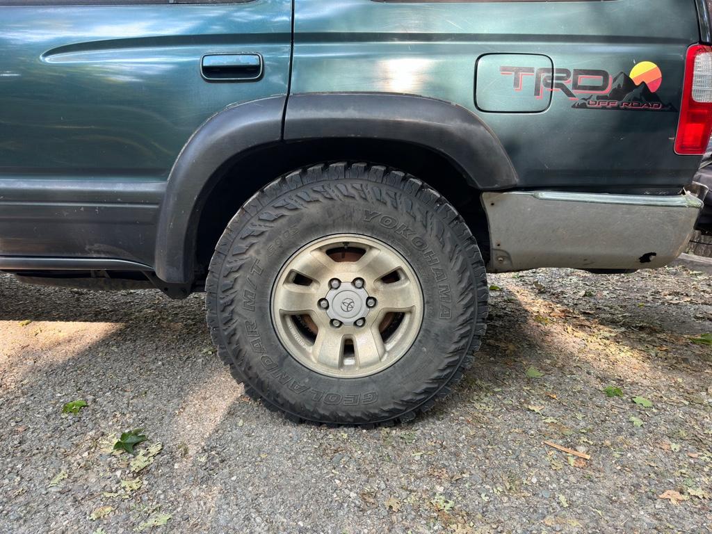

I have LC80 7.5 wraps on the back of my 4Runner. You can see my sig for my whole setup. 2+" in the front with the Eibachs. You'll be REALLY high in the rear without a load and no lift in the front. I'm nearly 2" higher than the front without 100 lbs of sandbags + subwoofer + tools sitting on the wheel wells with the 7.5 wraps. I have a hitch and 285 spare back there as well.
22.5+" in the front from the hub to the bottom of the Bushwacker flares
23.5"+ in the rear with all the aforementioned stuff in the cargo area
I have a set of 891s with less than 5000 miles on them. They have a spring rate of 210 lbs/in vs your 890s @ 190 lbs/in. Want 'em? $100 and they're yours, shipped.
Top pic is with the LC 7.5 + sandbags and the bottom pic is with the 891s and no load in the back other than the subwoofer and tools.
