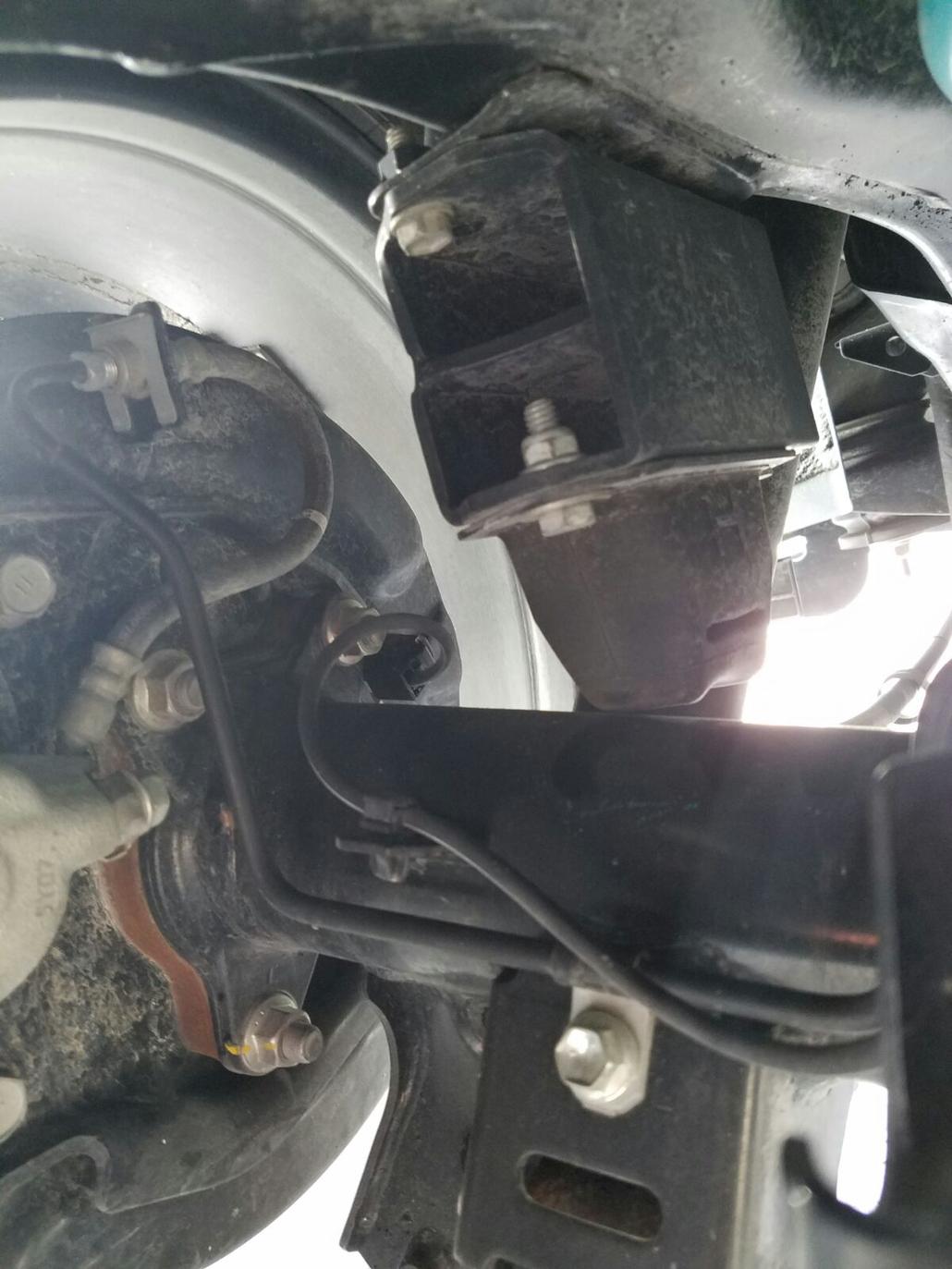

Alright, here are some more details to show the bump stop (with the 3" extension on there).
1st photo is bumper stop just touching and remaining shock left is about 45mm

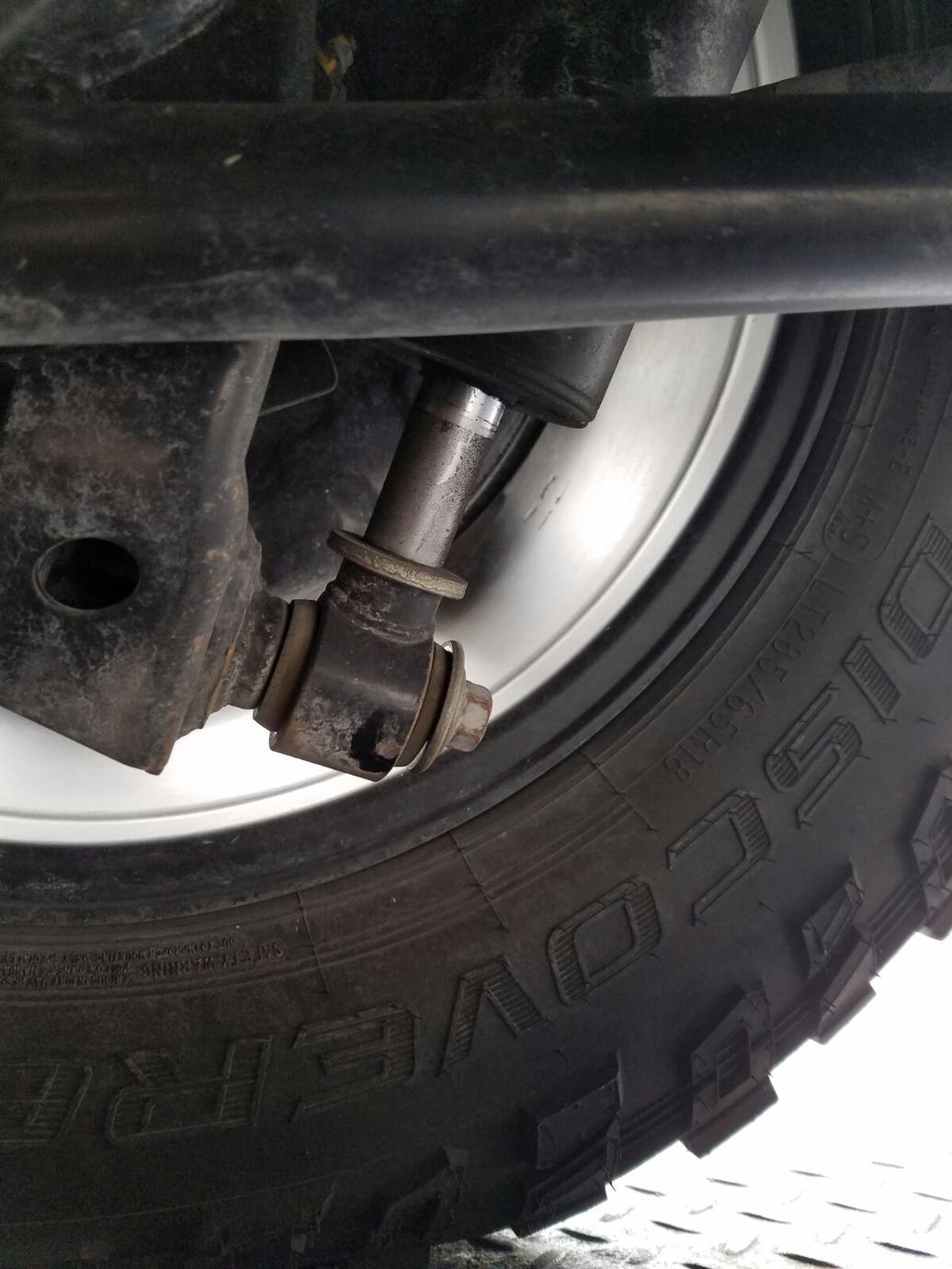

2nd photo shows shock remaining, 45mm

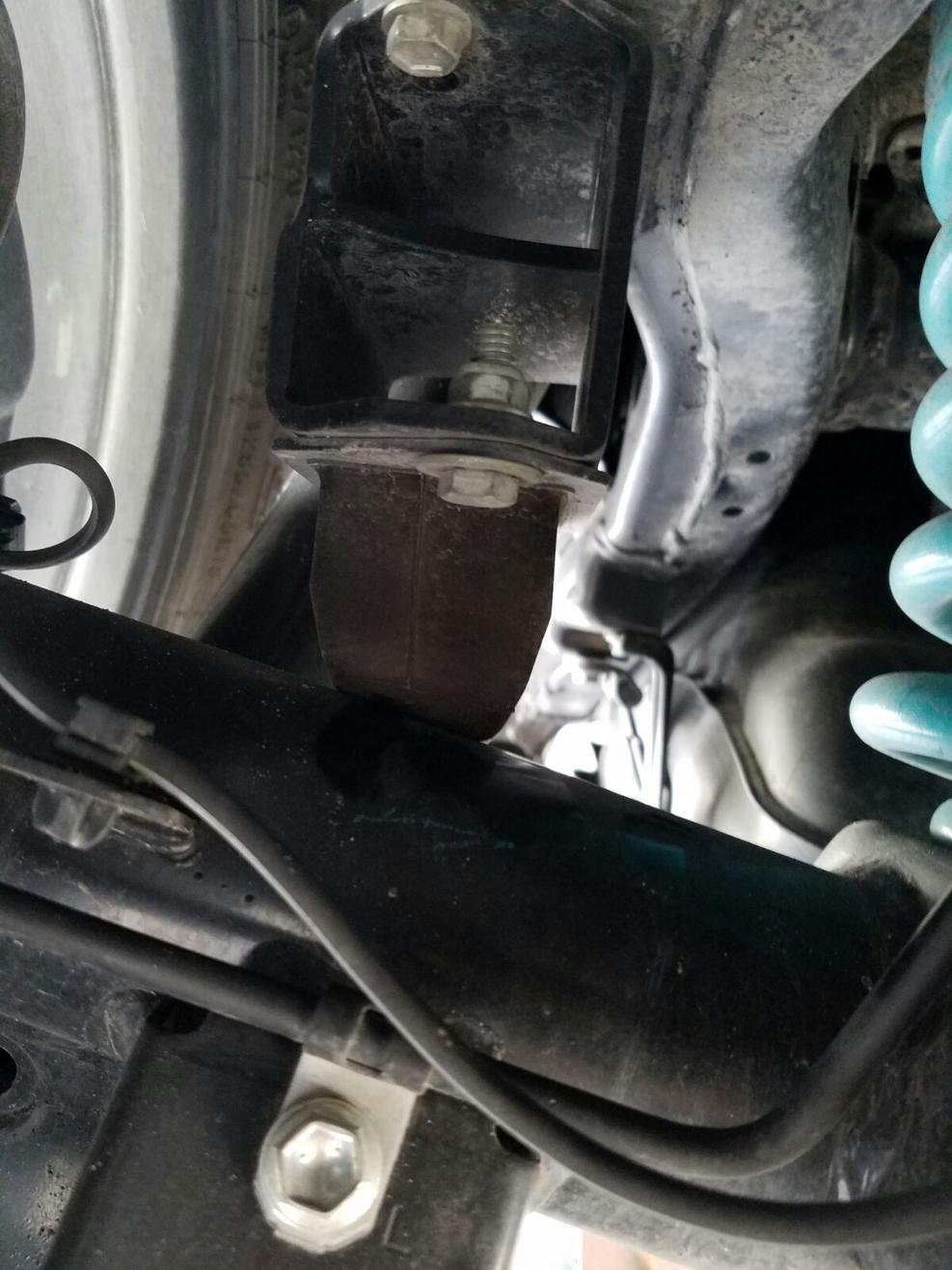

3rd photo bump stop compressed quite a bit

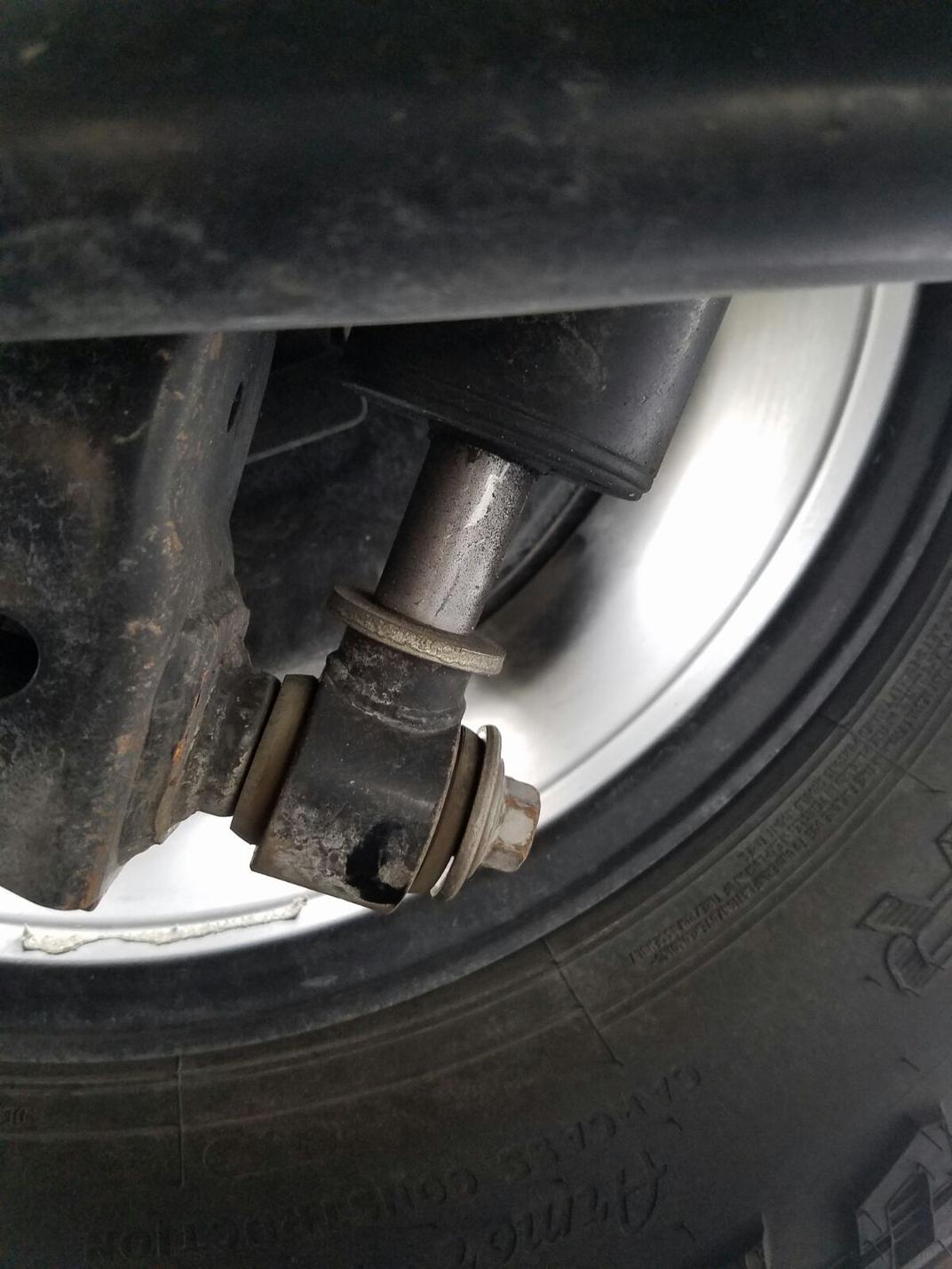

4th photo shows shock remaining, 40mm

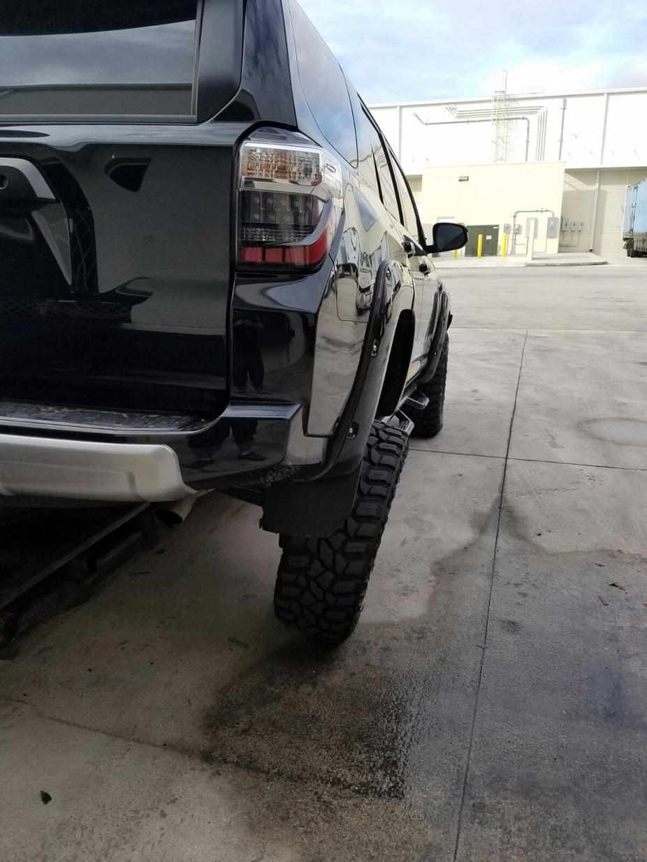

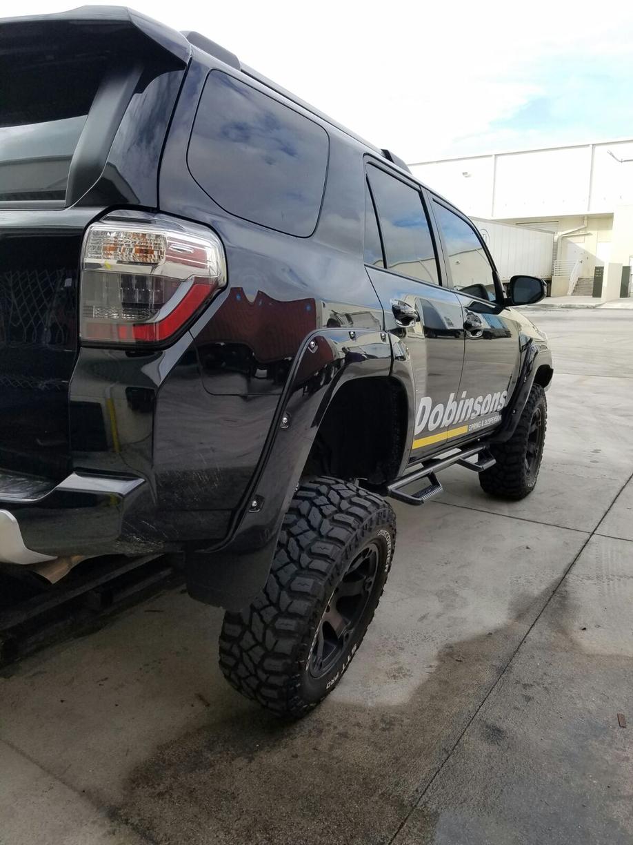

5th and 6th are just 2 other angles to show droop/down travel
With only a 2" bump stop extension, it wouldn't be enough, especially since the bump stop can compress further.
Also - the shocks we have on there now are our rebuildable shocks that we have been using to get all this stuff right. The twin tubes we're offering won't have the exposed shock rod like in the photo.

Seeing the photos showing the rear suspension at full droop prompts me to ask this noob question.
What component/s limit the maximum downward travel for the rear and front suspension?
I lifted my old 2WD pick ups but there, the leaf springs limited the downward travel in the rear and bump stops for the upper arms up front.
Nice looking ride, btw!

In the front, the control arms and strut length limit the front travel. The upper control arm reaches "maximum down travel" at a point too. The strut length is the main limiter again though, so without the right parts up there, CV's would be screaming.
In the rear, it's a combination of control arms (they can bind up if allowed for too much droop), and the shock length (this is the main limiter). Basically, the shocks are the limiting straps. If these shocks were installed without the right combo of parts, the brake line would snap, the coils would fall out, and the shocks would bottom out prematurely causing the mounts to snap or shock to bend out, and all sorts of nasty goodness.

So the dampers are the downward limiters. Then, as long as one is traveling slowly enough (not launching the truck with enough speed to get full on air), the shocks and struts can hold up to the stress of fully extending?
Yes, that's correct. A longer travel front strut allows for better down travel, meaning the strut shouldn't top out as much, and not kick itself to death inside. If the strut length is short, and the lift is high, then it's literally trying to pull the strut apart whenever it's at maximum down travel (jumping or wheels off the ground).
In the rear, this amount of flex is more for those needing to keep the tires on the ground for slow crawling. With that much down travel, getting the tires off the ground will be fun, but it can still be done.
Yeah, the shocks definitely need to be very strong to support all that axle weight when the tires do get off the ground. Of course limiting straps could be added to relieve the shocks and struts of that stress. I think Total Chaos uses them on their front IFS long travel kits.
In most cases, the shock/strut is the limiting factor for downtravel. And it can take this abuse without issues.
Bumpstops are the limiting factor for uptravel. Shocks/struts won't live very long without them, they aren't designed for those forces.
