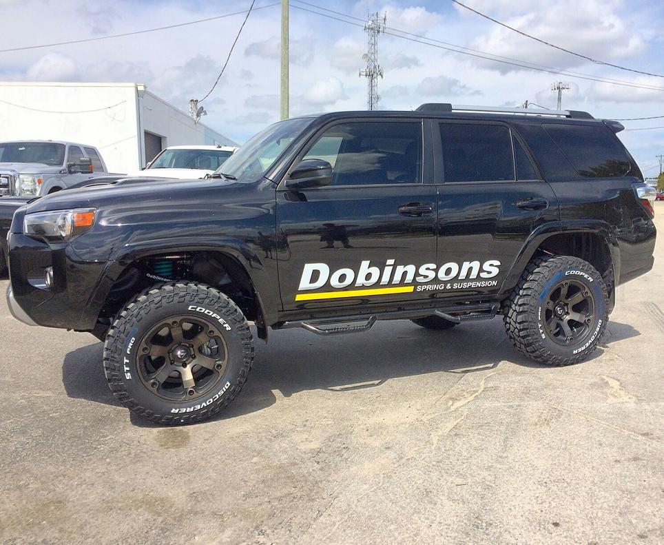

Could you post some pictures of the truck NOT flexing? Id like to see the static 3" lift, especially how the back sits relative to the front.
Thank you!

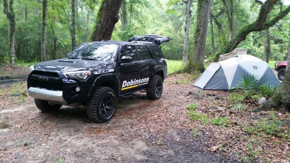

Here's one right after we put the new tires on last summer, and the front coils, but these were the heavy load 3" coils, so we were at 3.5" here. After we put the bumper on, it came back down. That's the closest I have to a level photo.
The camping photo is with the 3" variable rate front coils, but that's the only good shot I got of it that weekend.
I'll grab some more shortly, we're changing the wheels on it right now.

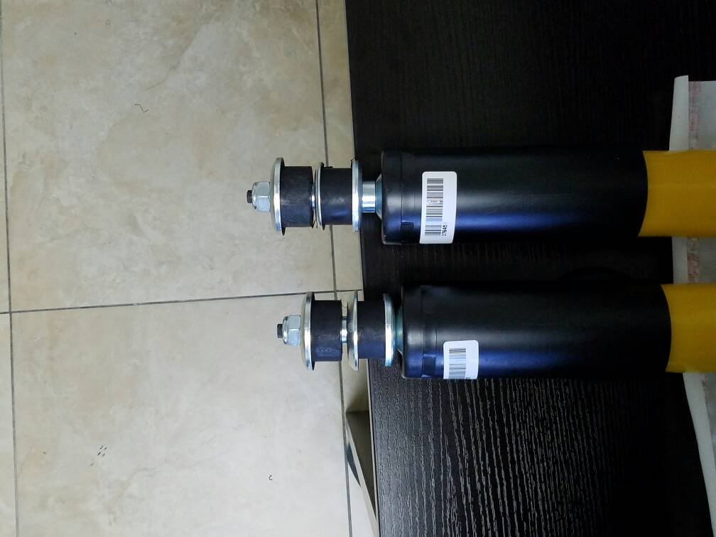

Here's a side by side of the longer vs standard 2" length struts. I tried to get the straightest photo to show how the coil seat is 10mm taller on the 574 strut.20170131_132700.jpg
