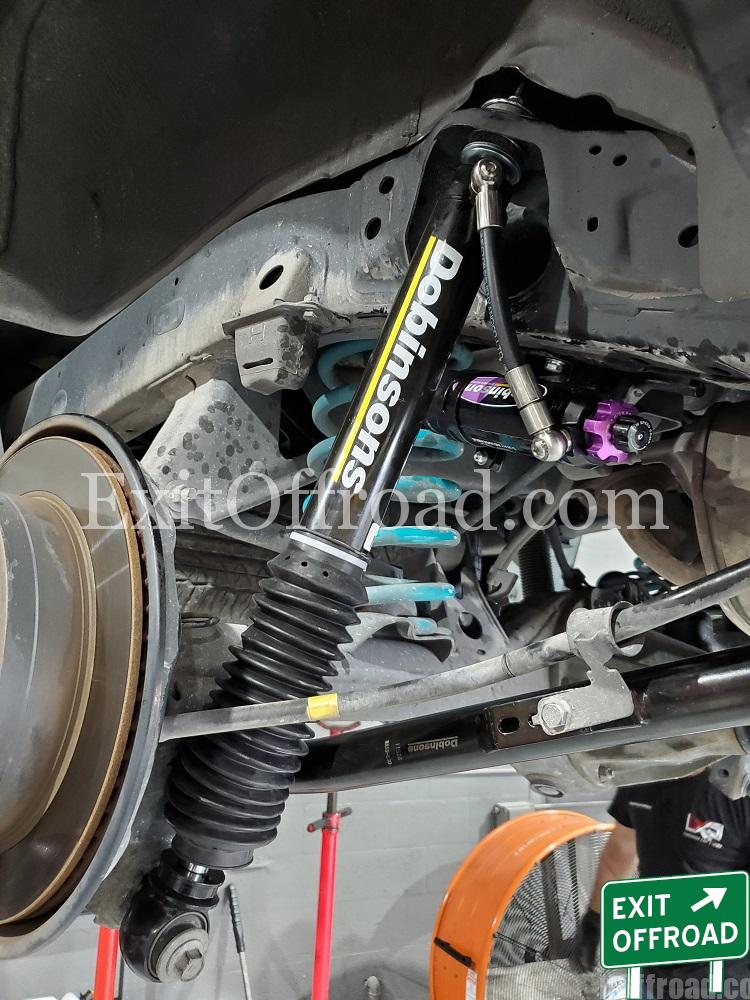

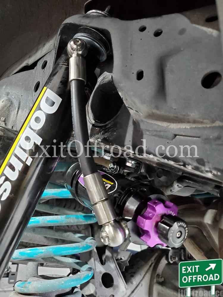

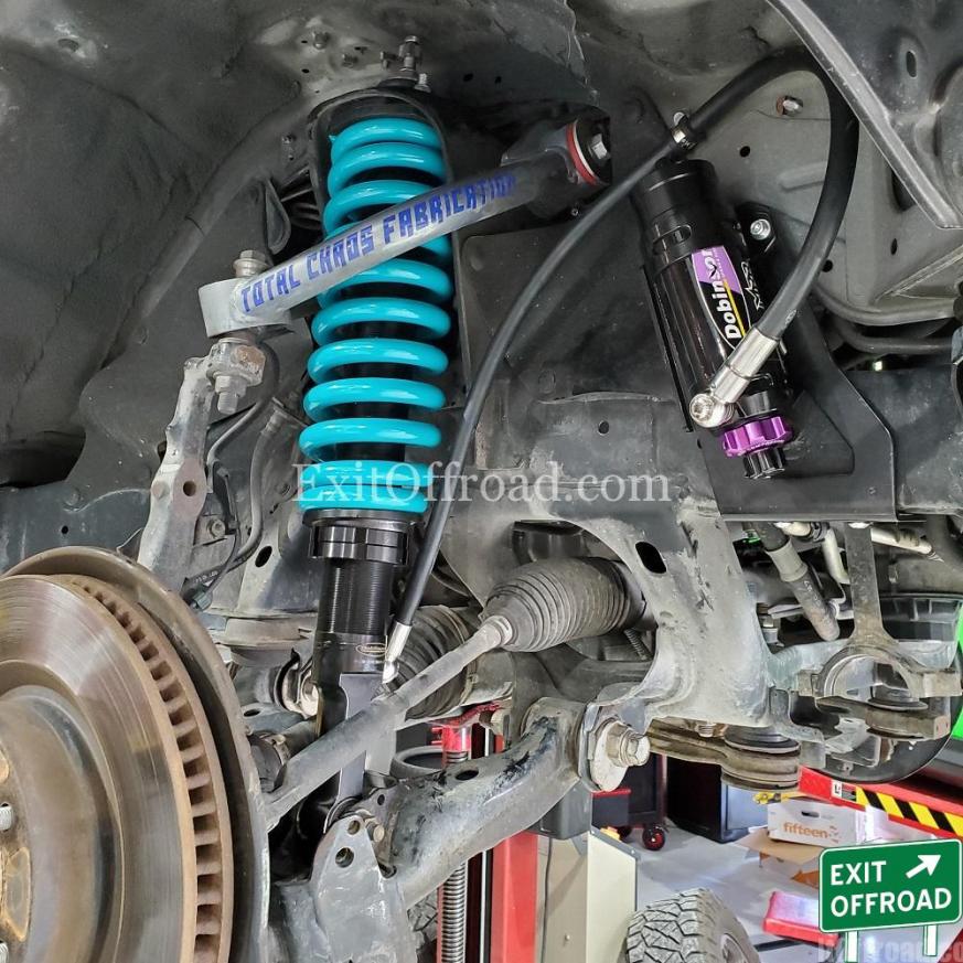

Photos of MRA59-A700 front struts with C59-354 coils and MRA59-A701 rear shocks with C59-725 coils mounted on my 2014 4Runner w/KDSS

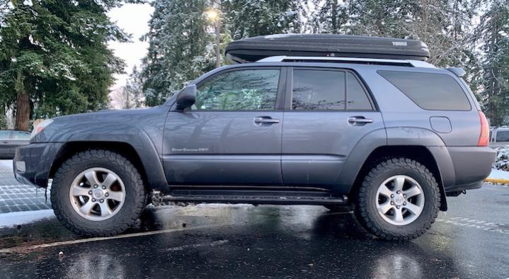

What rear coil shall I choose ?
I have a 2004 V8.
4WD
4,515 lbs curb weight
For the Front I will use
C59-314
MRA59-A221
I’d like 2.5” front lift.
For the rear I’m second guessing what I should choose because I
Want 1” - 1.25” of rake (no more) after my rear bumper and tire carrier is installed.
but not loaded with luggage or gear in the cab (empty).
The bumper/carrier accessory is 140-200 lbs. +/-
For larger camping trips When I do load my roof rack, luggage, and "precious cargo” ,
I will have added about 550-600 lbs
I am fine with it being
Level with no rake when that load is added, (do not want reverse rake if it can be avoided under this load)
When we get to our destination and set up camp we unload besides essentials….
When we go out to offload together my family weighs 435 lbs. (including myself)
(285 lbs. not including myself). (They’re petite)
For the rear shock I’ll use
MRA59-A701.
What Coil = ?
Thanks
