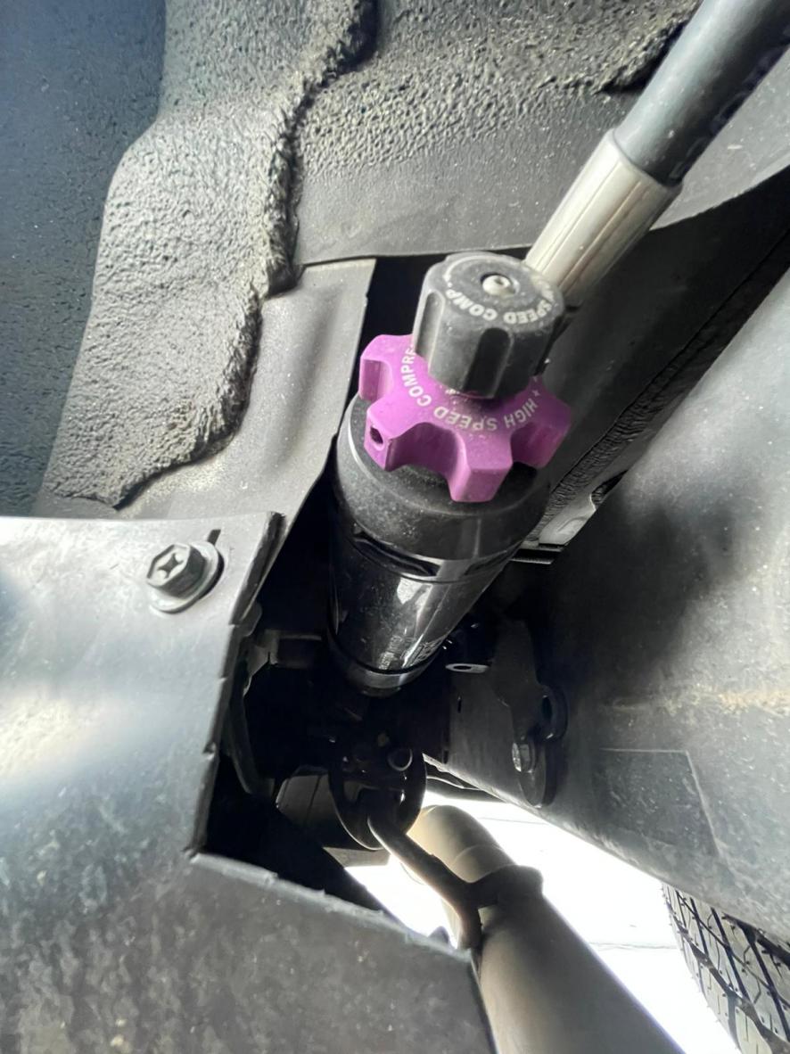

The driver side reservoir knobs were super hot due to it being blown by all the engine heat. I'll have to put on a splash guard to protect it.

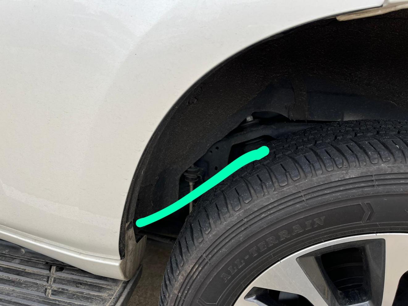

Hey, Mike. Just wanted to check if I got the right hardware. The mount looks like I received the ones for up front. Just looks different from the instructions is all. Hose is quite longer compared to the one in the manual and your pictures at the beginning of the thread.
I could make it work and drill the mount into where I'm holding reservoir?
*Edit
Not sure if making that bracket would work. Sticks out pretty far from the side of the frame and unsure if the tire would rub against it while flexing.

Hey, Mike. Just wanted to check if I got the right hardware. The mount looks like I received the ones for up front. Just looks different from the instructions is all. Hose is quite shorter too.
*Edit

As it should. I found out real quick the shock makes contact with the tire when the suspension articulates ��
I figured I'd try to adapt with the stuff they provided but it didn't work out. Pretty sure the mount I received is what is for the front shocks. I didn't get anything similar to what was on the instructions and I figured they just updated the design with the longer hose.

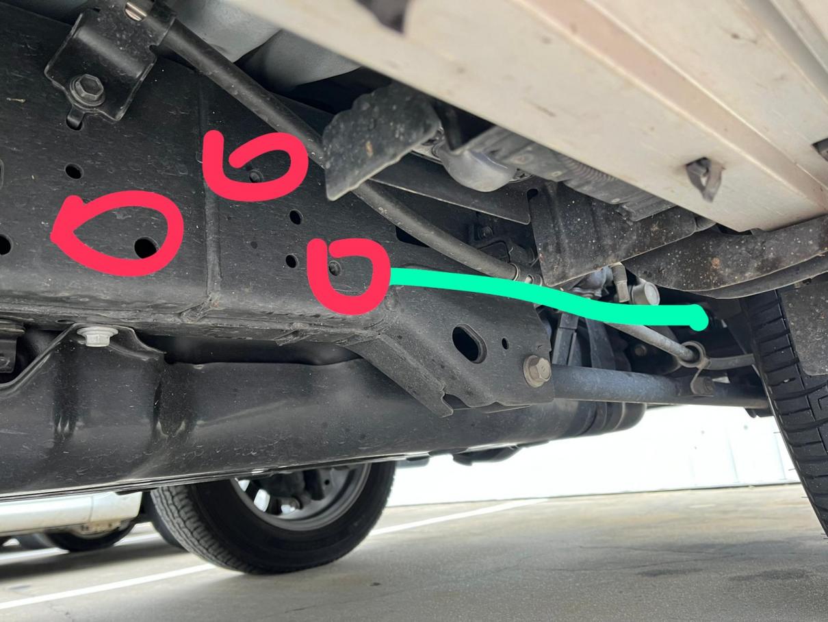

Dobinsons changed the hose length in this latest delivery so that the resi could be mounted further forward or rearward in the fender to be able to reach the adjusters easier. It comes with the universal bracket (same as the fronts). It requires just 1 bolt to hold it.
The way you're holding it in the photo looks pretty close, but flip it around to push the resi further back and clear the tires.
It can also go forward to the front of the vehicle and down on the frame
**edit: I've seen your email and seen you've sorted it out.

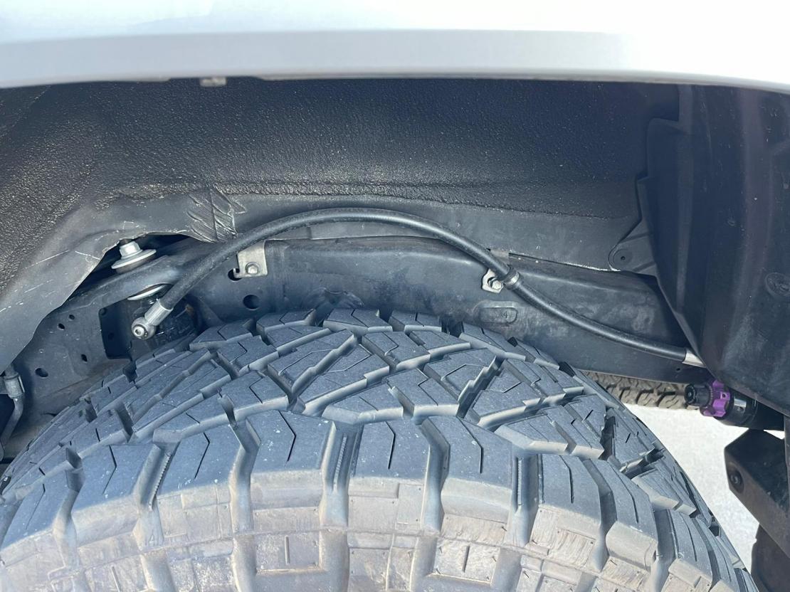

Thanks for all the info and help!
I moved it all this morning, had to do some metal cutting to the passenger side body that holds the mudflap for ease of fitment. Driver side was only some fender lining cutting.
The ride feels super plush on the road. Very excited to try these out at Jambo! Thanks again [MENTION=148378]Crikeymike[/MENTION]!
Here are some more photos
Dang! this looks so much better that the first batch, I have an hard time to reach the adjusters lol
Yeah. After further talks with Dobinsons, they're also suggesting to bring the resi forward on the frame, and use one of 2 threaded holes that are available. I'd probably do it this way, better to be in front of the tire than behind it.
Crap photos, but all I have at this moment.
