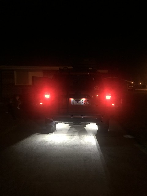

From the rear:
(Note: That the Tailpipe is blocking the throw of the light to the passenger side. not a big deal. I ended up mounting the lights about half way on the rear crossmember of the frame on each side. you will see an extra mount on the side of the frame it was almost inline there. I did not have the correct rill bit nor drill to make a pilot hole in the frame. I ended up using some self tapping screws that I had already to not mess up the stainless ones in the kit to start the hole. I would recomend doing a pilot hole though with a good drill and bit for a perfect install. Another option would be to use just marine adhesive. Yet you will need to have it on both the bottom of the light and the bottom of the rubber mounting pad and will need to secure it with a zip tie until dry. I out it would go anywhere. Wiring was simple following the frame all the wy to the front using points along the way to secure the wire with zip ties.)

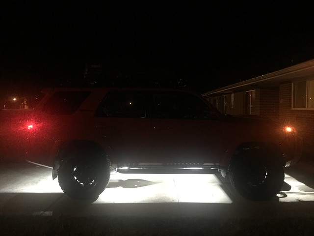

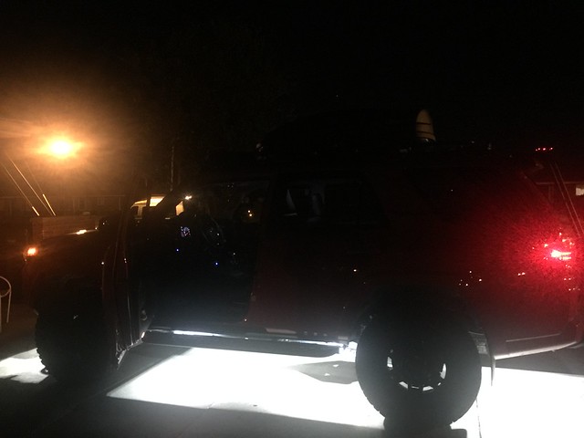

Drivers Side:
(Note: Lights where mounted about 6 inches in on the front and the rear in the sheetmetal that is a "box" you will know this spot by the plugs underneath the body. Not on the outside by the sliders. You can use the plastic cover for the bottom sill to put up the wire into (a tool like audio installers use to pull body panels and push wires into, a pice of plastic.) Then after both are run and pushed up use some asset type sealant every 12 inches to put a bead of approximately 1 inch to prevent the wire from backing out yet still makes it where it can be removed for replacement easily.)
Passengers Side:
(Note:Same as the drivers Side)

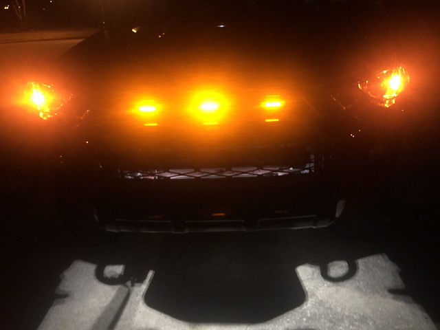

From the Front:
(Note: Best place I found to mount these would be about 1" Center of the outermost edge of the radiator in using the lip of sheetmetal there with the supplied self tapping Stainless screws and marine adhesive to waterproof and protect the self tapped part as well as to add extra hold.)

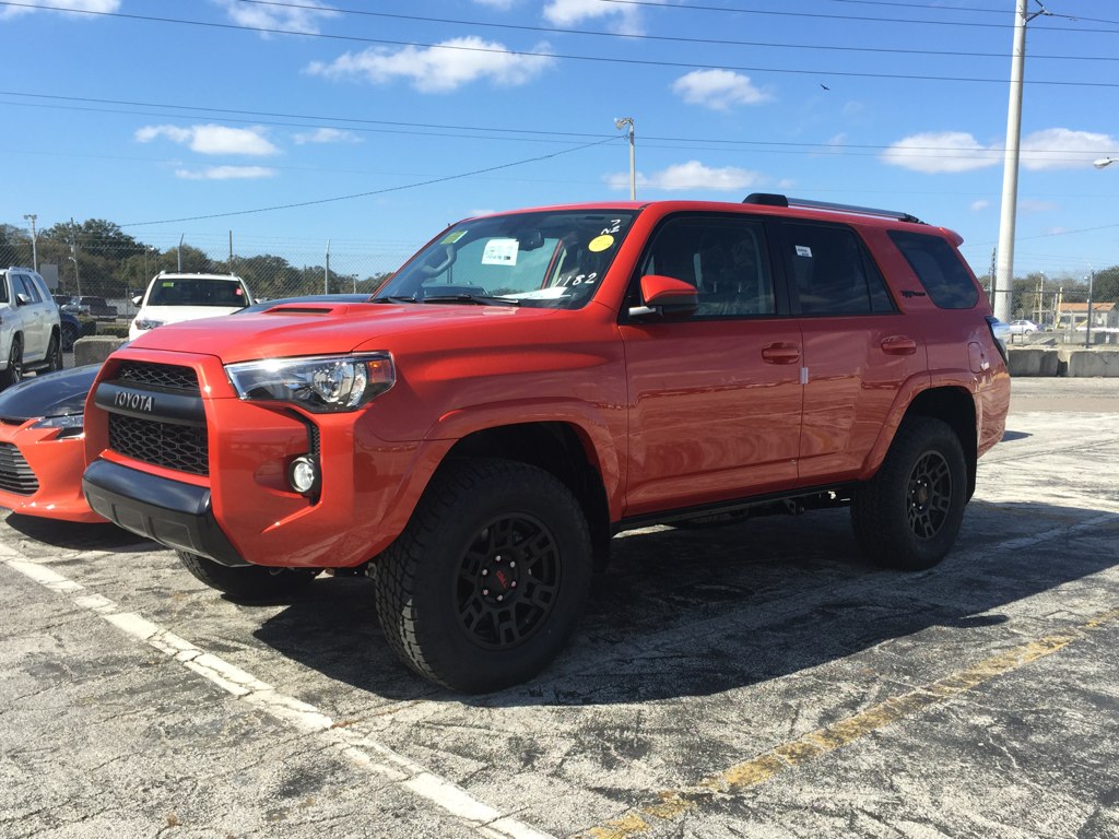

Well it looks like my truck came in to the port 12Feb15 and made its way into the Tire/Suspension shop at the port 13Feb15. Also, had the suspension done and the wheels and tires installed. Was told still needs an alignment, skid plate and Pre-Delivery Service done before it is on its way to the dealer. We are going to head down to Florida to pick it up on Monday hopefully missing all the snow and crap weather that is hitting the Blue Ridge Mountains. I'll start to do lots of little mods while I am down there. I will take lots of photos and notes.

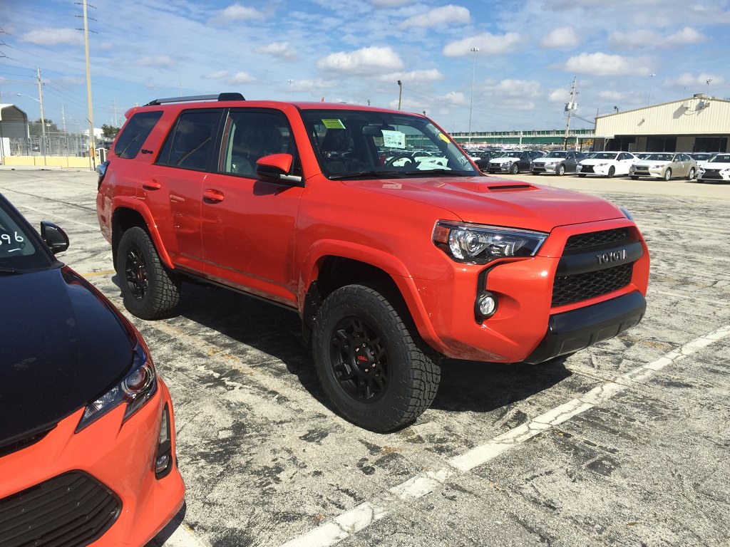

Here is a picture of the 4Runner right off of the Ship into the Tire/Suspension Shop for the Port Accessories.
Here are some pictures after the Suspension is installed. As well as the tires and rims. Note the orange colored Scion to the side, just for those who always wonder how the color Orange compares to Inferno.
We are heading down on 16FEB15 to Florida to pick up the vehicle.
