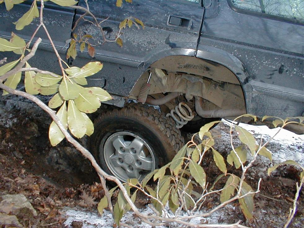

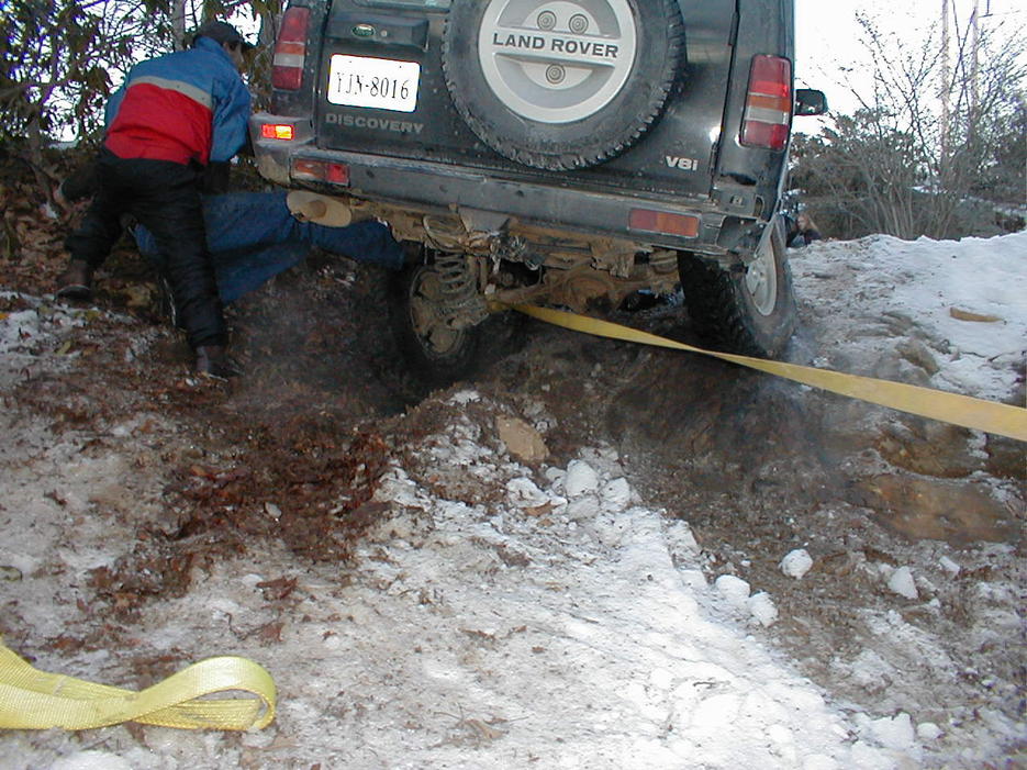

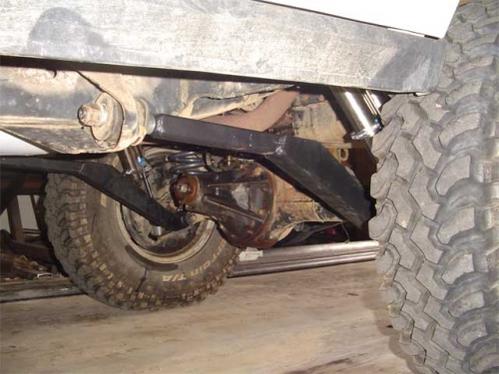

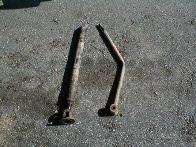

A long time ago and in a landrover, I had the misfortune of almost being stuck on a snow and ice covered trail in Connecticut after a stock rear trailing arm bent and sent my rear driveshaft into a rock, snapping it in half. Luckily someone in our group had a spare and I made repairs and made it home. I replaced them with ones made by rovertym and not only were they 1/4 inch steel with reinforced plates, they were angled to give higher clearance. Is there a 4runner equivalent?
Pics attached for reference. The metaltech or the rokmen pro seem like the strongest I've seen but none of them are angled. open to suggestions.

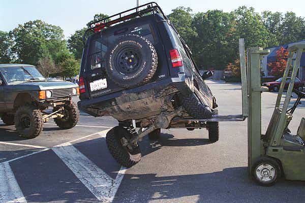

that post you put up answered all of my questions, please thank your brother for me too. looks like one company made the design i like but went under (wild west offroad) as far as droop or travel I think it depends on a few factors. they do tend to bind on certain designs but on the rovers at least we could max out 14" travel rear shocks. Here's a shot of a truck with those same arms during some fork lift testing.
