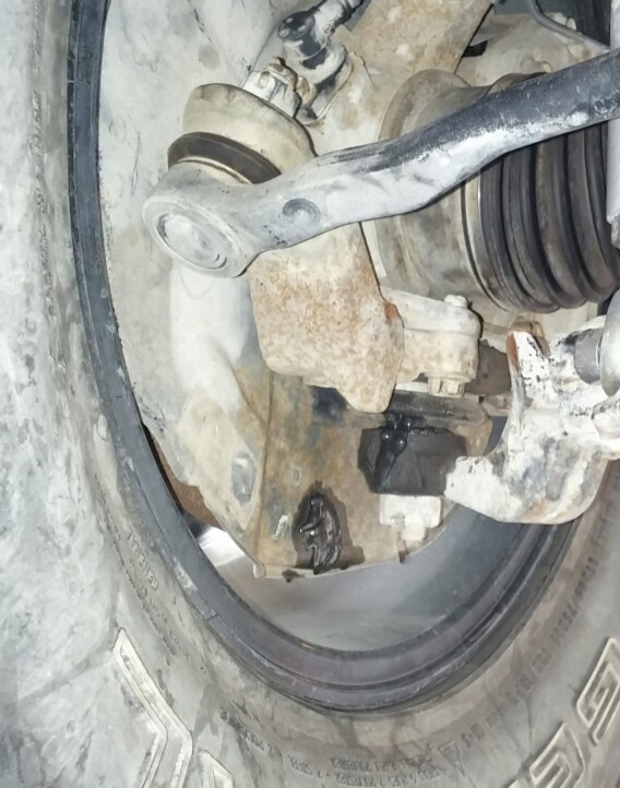

Just replaced my UCAs on Friday and drove less than 100 miles now ONE of my ball joints is leaking. It wasn't before the change, I'm sure of it since I looked under the truck last week.
These are Toyota Ball Joints with about 70k miles and they were installed in mid 2008.
I actually had them tested 2 weeks ago (not leaking at that time) by mechanic and he found no concerning play, said they were good.
1. does leaking ball joints equal about to fail, and if so how soon?
2. I need to drive at least 100 miles this weekend so I can get smogged on Tuesday. Battery was disconnected and I cant smog until I drive further. Plan would be to drive the miles then on Tuesday do the smog and possibly new ball joints if needed. Does that sound crazy?
Pic attached.

Yeah I would replace them, because if all the grease drips out it's like riding around with no oil in your engine, it's going to build a lot of heat and friction. Starts wearing out faster
I just wanna make note that some replacement LBJ's can be greased. The boot itself has a nipple like spot that has a slit that allows grease to come out. I cant tell from your pic but if yours are grease able. Its possible that your mechanic greased them and as your ball joint moves during driving it pushes the excess grease out.

Maybe the boot got slit?

I think the OEM LBJ are sealed but im not sure.
every oem ball joint I've seen is sealed.
I think you'd be okay making it till Tuesday before replacing
You will be fine for the smog test.
However, I wouldn't drive to Moab on it, or even out of CA. $80 from Camel and gets to ya in the next day? If the bolts are original, replace them also.

Maybe I'm missing something but if that's a new ball joint with only 100 miles on it why is it rusted like hell all over out by the tie rod ends?
