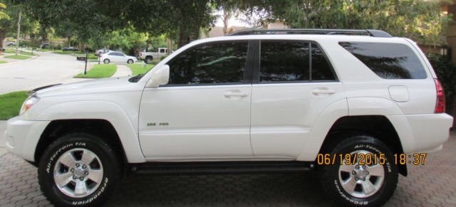

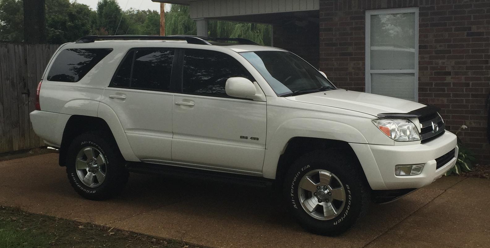

Hey guys. I have what I'm sure seems like a simple question! Does it look like I have a lift on my 4 runner? I have had several other runner owners ask what I did to the stance of my truck and the truth is I don't know. I have only owned it for about 6 months. I am fairly handy under the hood but lifts are something I have never been into! I like the way my ride looks but don't know if it is lifted or leveled or nothing? If you think it is lifted what can I look for under the truck to confirm what has been done to it. It is a 05 sr5 with stock 17" wheels. Thanks in advance for all your help!! image.jpeg

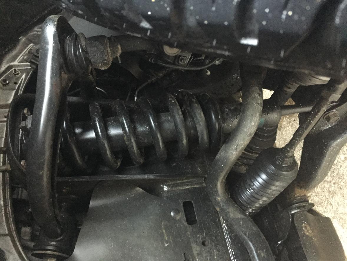

Sorry for the delay. Forgot all about this post til I was washing my runner this morning. Here is a front shock pic

I am stuck way over in west Tennessee. I wish we were further east, much prettier over there! So not to sound dumb but the space lifter some are saying is on my truck.... Is that the standard way to level the truck? Pros and cons?
It is usually the quickest, cheapest, and easiest way to lift it. The only advantages are it will maintain factory ride for the most part and allows more room for larger tires. You don't don't gain any suspension travel over stock like you might with a new suspension. It's a fine way to go if you want a little more tire room, IMO.
