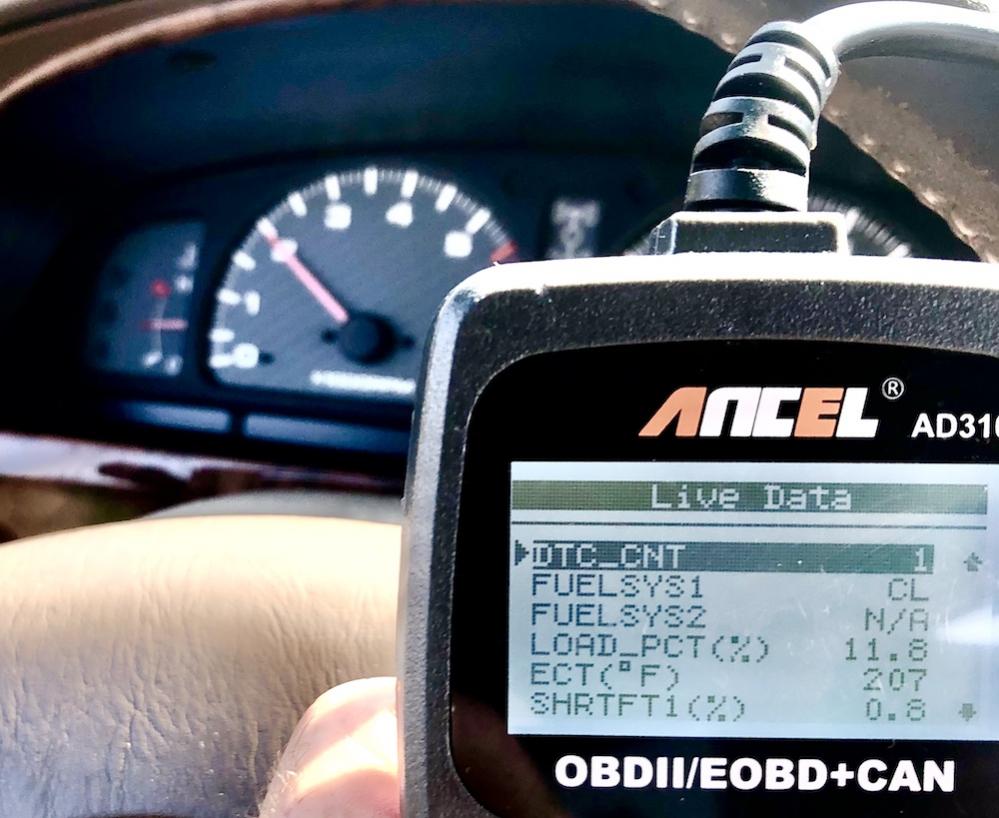

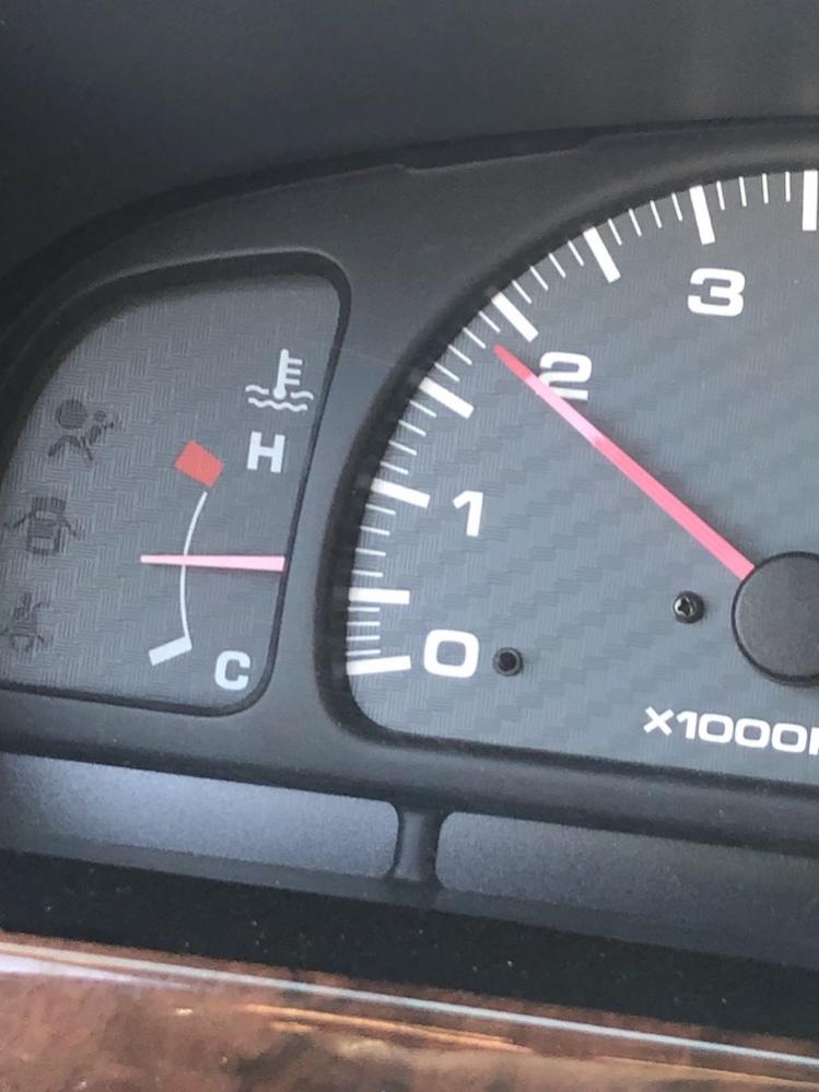

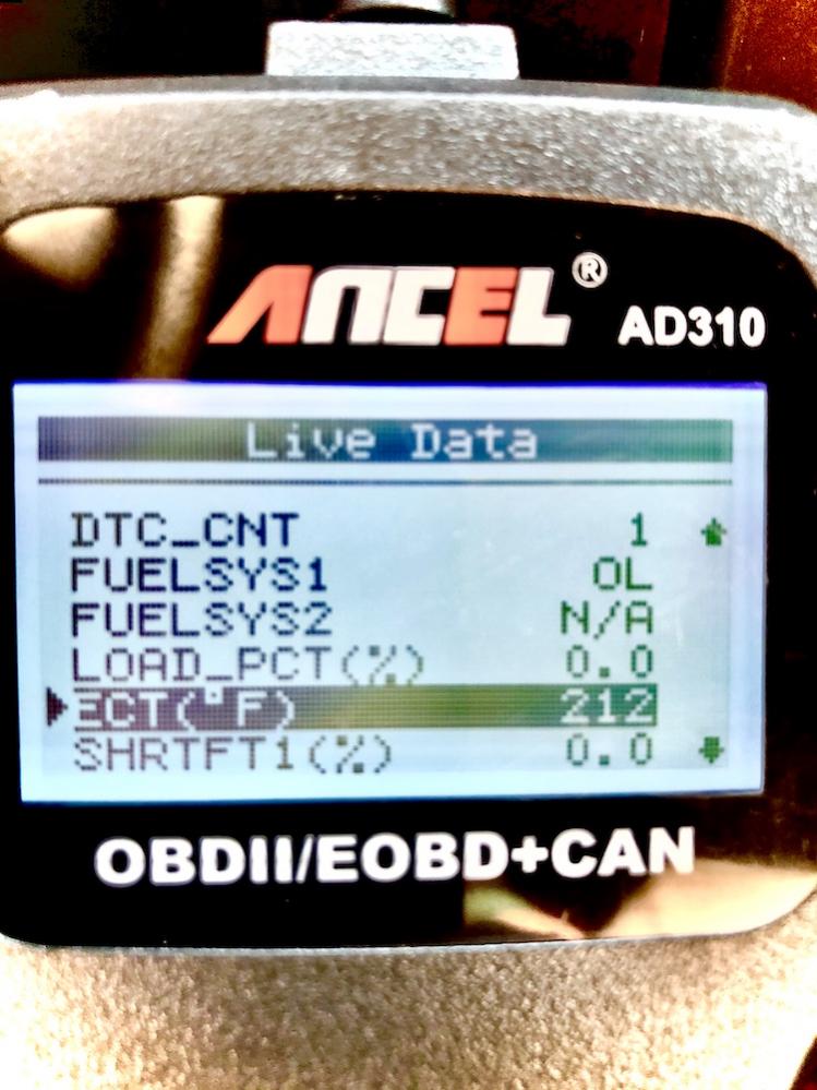

We're having a heat wave here in Norcal and I was planning to help my daughter move some stuff into her first rented (she's in college) house. My fam likes to run the AC and I thought I'd see what the temp was reading with a borrowed OBDII gauge. The dash gauge NEVER gets the needle up above the pictured level - just under horizontal. I was surprised to see the Ancel gauge reported a low of 196 WITH the heater on HOT and the windows down (fam won't tolerate that!) and a high of a frightening (?- maybe not) 212 with the AC on. That was at 65MPH and it was only about 90 degrees outside. Is it normal for the dash gauge to register NO change between 196 and 212? Is it stuck where it stops? Is the Ancel gauge out of its mind? The radiator is full and the top tank and cap wasn't unusually hot to the touch, the overflow tank was cool - the thing isn't 'overheating' so I'm confused. I should disclose that I'm almost certainly on the original radiator and some probably very old red coolant (the PO was a bit of a cheapskate). I had plans to replace the radiator and T-stat soon but I'm thinking I need to move faster. I've put 10k on the truck since I bought it about about 8 months ago - it has 235k on the clock. I googled the normal range for this engine and I can't explain 212 degrees unless the ECT data is off. Not gonna drive the rig in 106' until I know what's goin on. Thanks for any insight. I took a couple pics - one attempts to show the gauge needle in its happy place and a reading of 207.

I don't think it starts moving until like 225-230F. 212 isn't normal though. I've driven in those same conditions with AC full blast and I stayed between 191-195. I'd probably replace the rad, cap, and thermostat with all OEM parts first. Make sure the jiggle valve is at 6 o'clock when you do change it. Flush the coolant. Make sure to park on a incline or jack up the front when you burp it as that helps get all the air out. I'd also pickup one of these funnels as they make the job a lot easier. Amazon.com: Lisle 24680 Spill-Free Funnel: Automotive
It sounds like your truck is operating normally. Typical coolant temps will run between 190F and 220F on a pressurized cooling system. The key here is pressurized, and that function is controlled by the radiator cap. It's job is to maintain pressure in the cooling system up to 15 psi. By doing that, it raises the boiling point by 45 degrees.
As far as the temp gauge reading, that is normal for 4Runners and I would not worry about unless you have some reason to believe the truck is overheating.
Frequent stop/go and climbing hills without using OD override will do that yet it should cool down to under 200 after just a couple three miles of level driving or using OD.
As others said, if radiator is old (has a date stamp), replace it and its friends around it.
Make sure the area Between a/c condensor and radiator is clean of debris/tall grass, gotta remove front skidpan.
And yeah don't count on the stupid oem guage, by the time it moves its nearly 285 and too late.
It is odd how running the a/c raises engine temps, mine makes Zero difference if on or off, blows ice cubes too while driving thru death valley at 116+, engine temp remains at 194.

212*F is not overheating, but isn't correct. The gauge will be in the 'happy' position from around 165*F to ~220*F. Almost all vehicles are that way ("modern" - like mid 80's and up).
A good running cooling system will be 190*F +/-5*F in just about every condition.
Likely you just have an upside down thermostat, but take the opportunity to get an OEM one in there with the correct Toyota Red coolant mixed at the right ratio...
If temps are still erratic, check radiator cap (new OEM only!), fan clutch (Aisin or OEM), etc.

I drove it for about 5 hours in 106 degree temps and it was between 200 and 205 with heater off. Heater on blast it was 196-198. It was a pretty miserable day because I would rather be the one running hot. I am going to go all in with a new OEM t-stat, cap, Toyota red coolant (that's was it had when I got it, and as I think I mentioned, might be original!) hoses and probably a radiator as well (my friend has an unused Champion I can get for next to nothing). It might just be old coolant, but better safe than making a milkshake. Thanks for the support, all.
If you have access to a new rad....replace it along with the Toyota t-stat and a new rad cap.
And for the record my 96 had the jiggle valve at 12’O the clock and it’s temps were normal at 186-192.....
