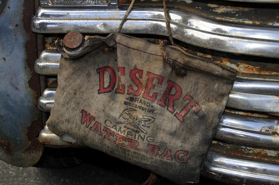

Get a Desert Water bag like they use to use. The canvas actually allows water to seep out, which then aids in cooling the radiator through evaporation.
