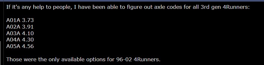

I have a picture of the door tag, and it says AO1 for the code. I'm assuming that's not good?
Here are all the stock rear axle ratio codes for 3rd gen 4Runners, models with 15" wheels typically came with taller ratios, 16" wheels (and 4WD) lower ratios.
Great info. It appears the 4Runner I am looking at has the highest gear ratio, if I'm adding bigger tires which I will pretty much immediately, how difficult is it to change only the gears, and would it be necessary?
Changing the gears is difficult, requires special tools if you want to do it yourself, built diffs that you can swap in from Ecgs would cost maybe $2000+/- for the front and rear. A regear may not be necessary depending on the size of tires you want and your tolerance for driving a slow as shit vehicle. I have 33” tires on stock gearing and it’s fine to me but mines a v6 so ymmv
Since it came with the 3.73 gears, is it a 2WD? If so, you can easily just swap the rear diff to a 4.10 version with no problem. I believe the 4WD 4-cylinders got the 3.93 gears if it was a 15" truck.
You will still have an incorrect speedo if your truck is ABS equipped due to the change in tire size.
