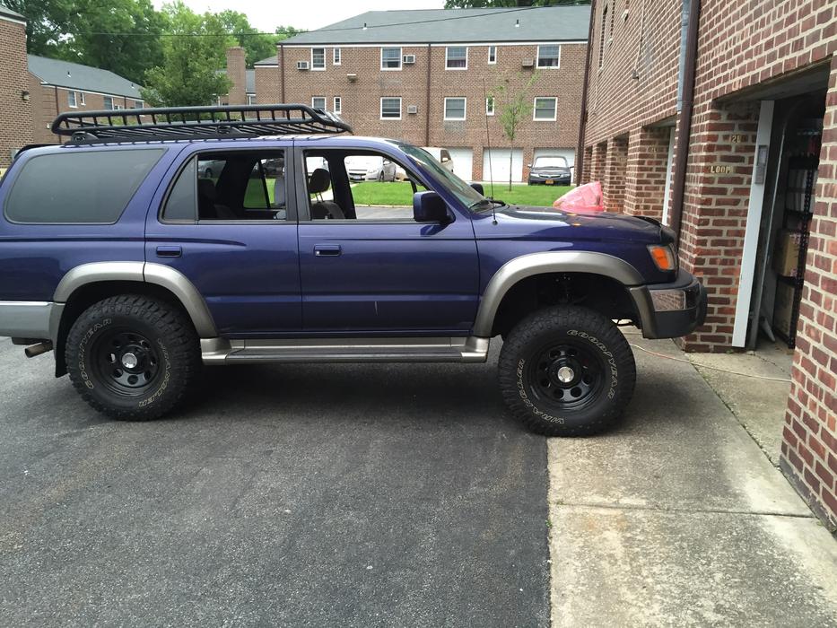

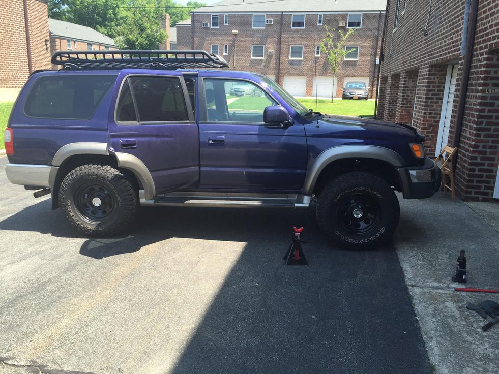

Did the speedys garage 2" lift and took me all day to do the fronts. Was trying to get some rusted bolts off.
Front tires are Duratracs.
Anyway took a pick and the front seems a bit high. def have them at the lowest perch.
Back is going on tomorrow with 906 coils and Bilsteins.
No that looks 3+ inches in the front. Do you have the spring cup
Installed upside down on the perch by chance?
give us a picture of the strut its self installed
Ok. Will get some closer pics tomorrow.
Don't think the mechanic installed them upside down.
Guess will see tomorrow.
yup. They put it on backwards. Guy told me he did a ton of these.
Although he did only charge me $20 a shock.
Hopefully will get some pics of this correctly installed.
Thanks for everyone's feedback!
