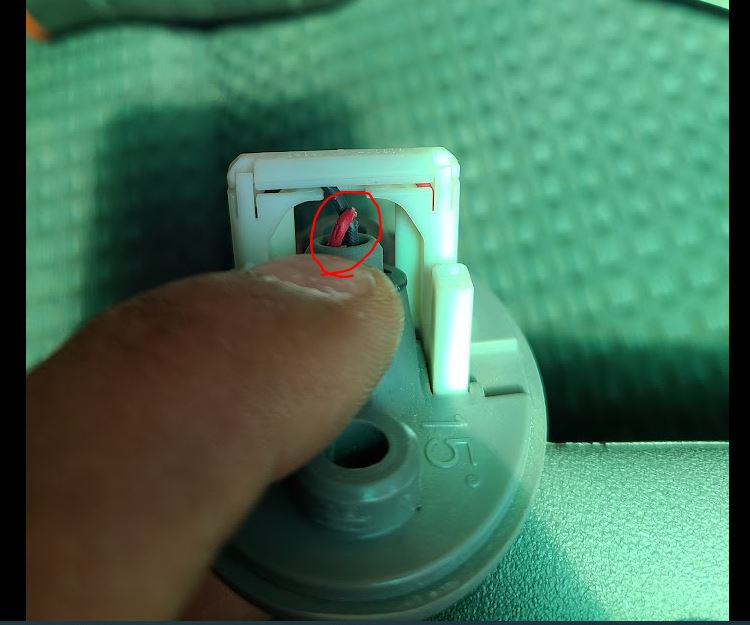

I wanted to circle back and close out this thread. I FINALLY discovered why my dome light fuse keeps blowing and you'll be impressed with the cause.
A while back I replaced both visors with OEM units and it was the passenger visor vanity light that was the cause.
No, it wasn't the bulb. :Cry:
It was the factory wiring INSIDE the visor that was causing a short and blowing the dome light fuse.
I used a resettable fuse to systematically trace out the dome light circuit and this is what I used amazon link. I don't suggest you drive with these fuses but they're great for troubleshooting purposes. One downside to these fuses is that they're a tad too short to sit in the fuse location so I had to extend the legs.
Anyway, here's the pic of me cutting the POS(+) leg of the vanity wire circuit.
One good thing about this process is that I really learned the EWD and how to use it as a resource. I also may have found a discrepancy in one of the circuit. I have the EWD book so it's in color and I drew on it like a toddler :p
I hope this helps out others.
