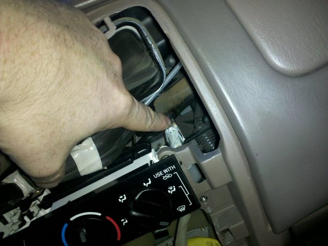

So it depends on the year and if you have the electronic or manual climate control. But on my 2000 I disabled the auto a/c with defrost. You just have to unplug an electrical connector right behind the climate control bezel. Best part is you can still push the A/C button if you need extra help defrosting. Heres a picture

This worked on my '97 SR5.

Same. Just did this a couple weeks ago when replacing bulbs. On mine it was a connector with two blue wires at the far right side (passenger) of the hvac control.

You can still turn on the AC if the connector is unplugged by pushing the AC button. This mod gives more flexibility when using defrost. Also as mentioned why have the compressor on just to use more fuel if you don’t need it on?
I like this idea...push a/c button if and when needed for extra defrost drying plus I can hit it occasionally to kick it on so it "lubricates" the compressor.
plus I have a few bulbs in that area that need replacement and have been stalling on it.
I have the dial style heater like you pictured in your post

The simplest method is to unplug the wires that are switched by the "defog" or "defog/ feet" position of the control. On my 2000 with the basic heat this is the pair of blue wires described by Charlie and myself.
