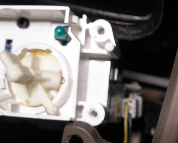

ok...thats a different picture from the picture on the first page. from the picture on first page I was thinking it was more visible...male and female and towards the upper back..i did kind of see a plug with wires going to the lower right corner of the heater controls and maybe a bit difficult to get to.The colors looked different too...but that could have been poor lighting. I was afraid to pull it as it looked like it would be difficult to put back if I was wrong...and like I said...I was looking for something to the upper right and more visible
Its not always as easy to see as the pictures make it out to be. I remember mine being kinda hard to get to. Also its not necessarily a blue wire. Pretty sure mine actually looked like this. It should be there though if you have a 2000 with the dial controls. White connector on the right side of the controls
thanks for that picture..that I saw. The other thing that cofused me was that in an earlier post ( not by you) it said blue wires. Since I did not see blue wires and not at top of controls...it thought....nope not it...don't see it...not messing with it.
will try to go back into it today and get that plug
thanks everyone else too for your help
Wire colors are always referenced to the harness on the truck, not the 'item' side of the plug. So, the yellow / black wires there are the wires that go in to the switch area on the control panel and would not be called out on the diagrams.
The plug is on the back right bottom corner of the control panel.
-Charlie

I had to dig a little to find Charlie's post about this. When I disabled my defrost a/c I did not take any pics. My harness wires to the plug were blue and blue/white just as in the pic below. It would appear the wire color and plug configuration of some units differed.

You just need to unplug this two pin connector on the back right corner of the AC controls. This only works on the manual AC trucks. It only affects the two defrost settings, and otherwise everything works normally. I'm smart enough to turn on the AC if I need extra de-humidifying at some point... I did the same thing on my '03 WRX with great success. My Camry doesn't turn the AC on automatically with defrost, so no worries there.
yep , thanks for your pictures..mine is a 2000 SR5 also...but I guess there can be color changes..mine is actually a early 2000.....build date 1/2000..so maybe some things changed.

thanks to all who helped...that is what makes this forum so valuable. I had to pull the headunit ( stereo) to get access to the plug due to my big clumsy fingers..and get a dental pick in to get it to bust loose...but got it.
