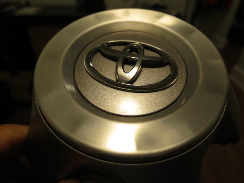

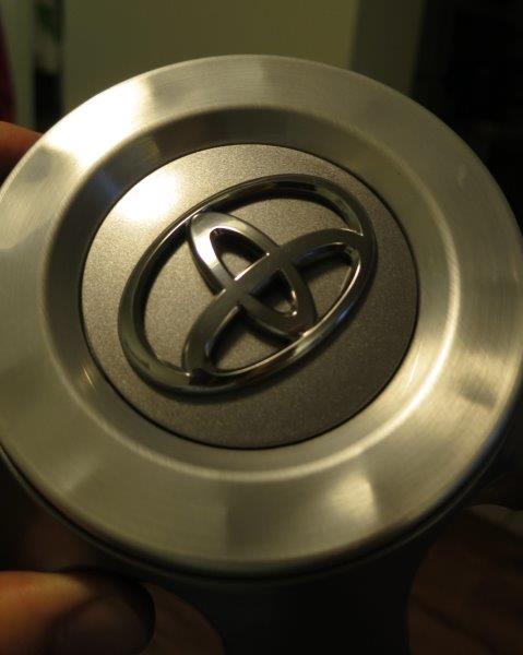

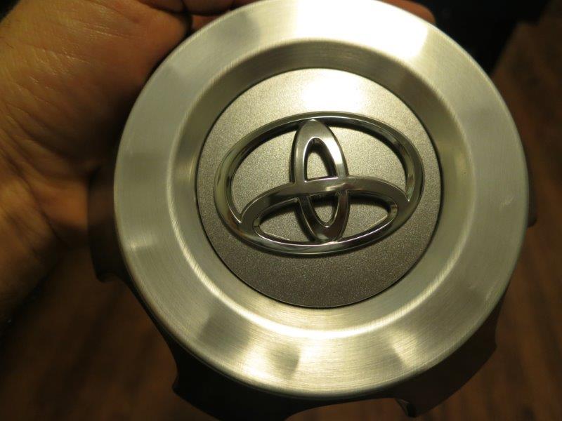

Check out the pics. Please let me know if your 2014 Trail edition Wheel cap rings are doing the same. PLEASE
So my brand new 2014 trail edition has 3000 miles on it, and I noticed dents forming on the thin aluminium rings around the wheel caps. My dealer said someone was vandalizing the vehicle, but I could not see how or when since it was in secure parking all the time, in a building of elderly people, and there are no other marks ANYWHERE on the truck or wheels. So toyota warranty will not apply. They never even took them off to look at the other side.

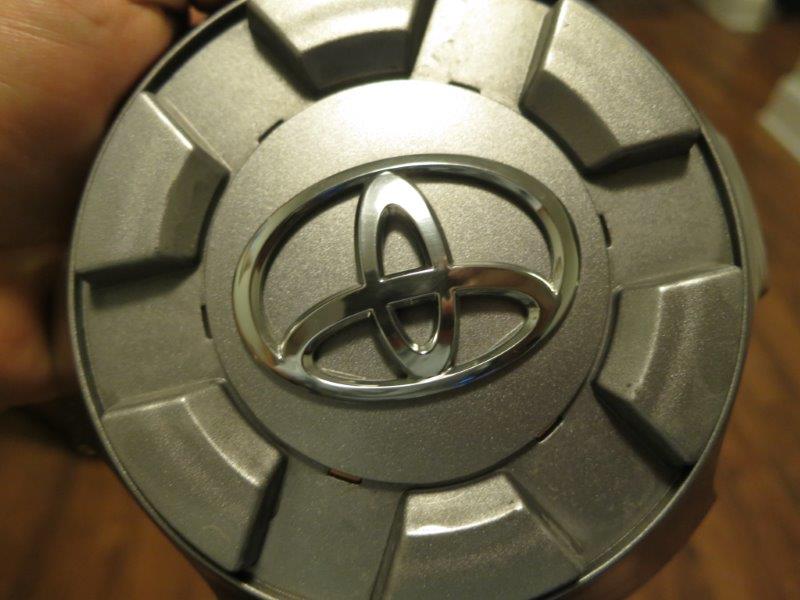

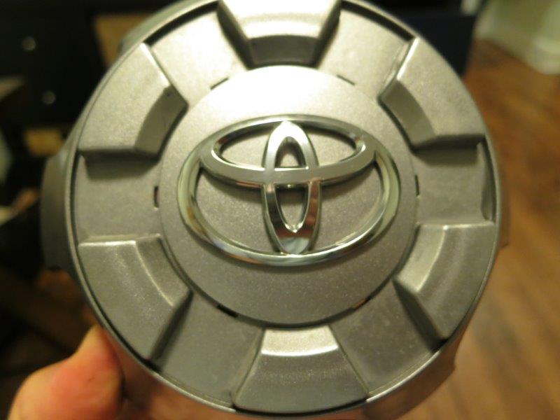

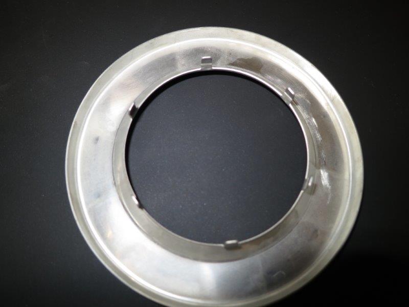

So I was furious, and took them off the wheels to discover the tabs that attach the metal rings to the uneven plastic backing where not tight, causing the rings to rattle against the plastic.. I also noticed that the dents are exactly the same shape of the plastic below, which is not continuous, but ridged.
I don't know if the rattling did this, or the touchless car wash I always use. If it is the car wash, it would be because the metal ring is so thin and flimsy sitting against an uneven surface. Either way I am very disappointed that Toyota will not stand behind a very inferior product. Two dealers refused to entertain the idea that this is a cheap product that is not well designed.
If toyota is serious about listening to feedback, they sure are not showing it. The attitude at service is "no way would toyota produce something inferior" guess what, they did.
If anyone else has a 2014 Trail edition, please let me know if you are also getting denting on these rings. All 4 of mine are showing the same. If i can prove a pattern, they may at least redesign them so they will not dent.

For reference this is how your wheel should look.

Sorry for your troubles, but you may be on to the answer in mentioning the touchless car wash. It is pretty apparent that the indentations on the aluminum rings match the pattern of the underlying plastic protrusions on the cap, indicating that some sort of exterior pressure on the ring is causing the dents. Touchless car washes can use an extremely high amount of pressure in applying he water onto the vehicle. The local washes around me all have warning signs not to use the car wash if you have loose trim pieces, flaking/chipped paint, etc. If could easily be that the water pressure against the aluminum ring is forcing the metal to bend into the cavities between the cap protrusions. If that is the case, I can see Toyota's reluctance in warranting the item.

not really the same. your handheld washer probably puts out 1000-2000 psi at 1" from the nozzle, so unless your washing your car with it 1" from the vehicle I doubt you can do any damage, unless your using the pinpoint nozzle which you shouldn't since you can peel paint with it at that psi.
now commercial touchless have a several hp motor pumping up the pressure and usually the nozzle openings are bigger and push more volume thru them so I can see that happening.

The only times the tires where off where with 10 miles on it when they put michelins on instead of stock, before I picked it up. No dents then. They have formed over the past few months as time goes on. The pressure wash is the coin operated type, $2 ones. I never get closer than 6 inches and the pressure out of these is not that strong. It just have a regular nozzle. I live in an apartment building so no access to personal pressure wash.
Let's assume it is the washing, should I not be able to wash my vehicle and not worry about denting it? I think these rings should be backed by flat plastic all the way around, not sections of plastic. They are paper thin and can bend with any slight pressure.

During tire installation they had to remove and reinstall those, and they typically aren't terribly gentle with putting the center caps back on. That is almost certainly when it happened.
