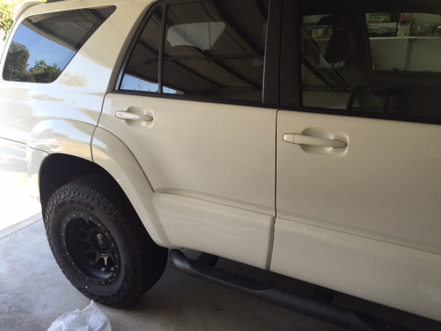

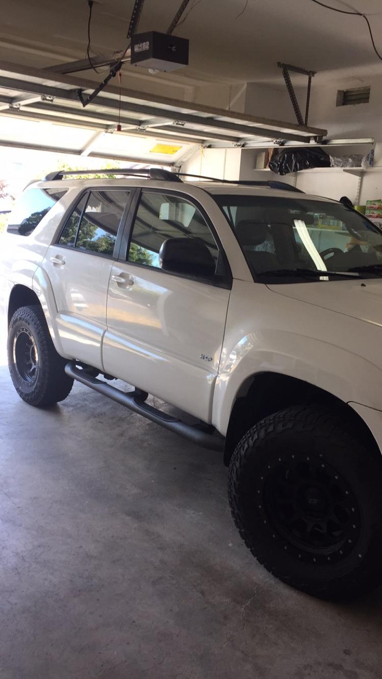

I just finished this and it ended up being really easy.
In the front the door panel doesn't even have to come off. It's literally one bolt that holds the cap on. Once the bolt is out, you pry off the cap and the handle slips right out.
In the back, the door lock mechanism covers the bolt that holds the cap on. So you have to remove the panel and unbolt and move aside the locking mechanism. Then you have access to the bolt and it becomes no different than the front.
I think the color keyed handles look much better than chrome.
And if someone happens to like chrome, the grill, tailgate trim, and handles are in the classifieds for cheap.
