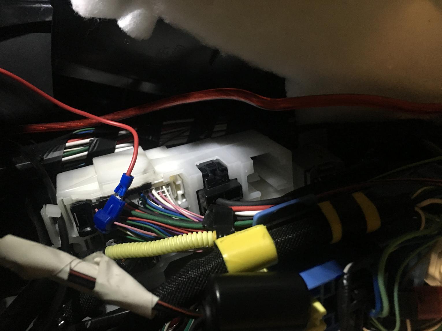

I did all as described, tapped the pink wire in the kick panel and my lights just stay on. Im grounded good, I think the pink wire is constant power in my 4runner.
If anyone has any other suggestions where I can easily get power when the doors are open (besides the dome light) I’m ready to try.

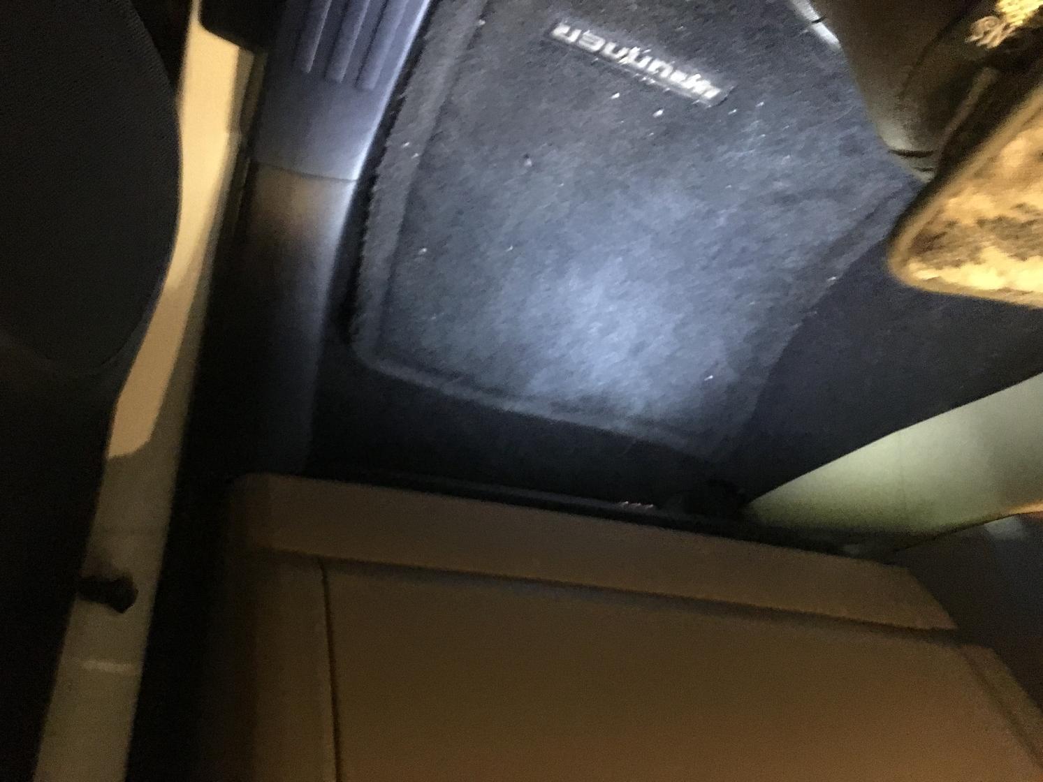

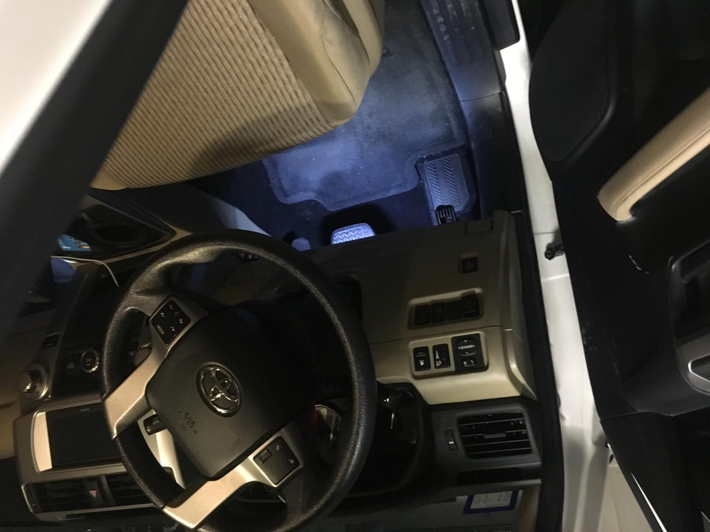

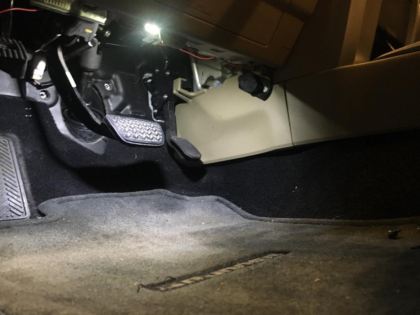

Never mind my previous post. I got it to work. Ended up using the pink wire that ant man described, and trigged the footwell lights from the door switch on each side. Was kinda a pita, but works great!

I’ve kinda given up on sharing photos, when I try to post photos they upload upside down or sideways for some reason and in the preview only one will be right side up, . (Btw, does anyone know how to get my photos to upload right side up?) Here goes...

They only work with the doors and cut off as soon as the door closes. They work together since it’s grounded off both front door switches, it will remain on until both are closed. I haven’t done the rears doors, but may do it soon bc I know how to do it. Then the passengers side maybe took me an extra 20-30min since 3 of the 4 wires were already in place from having done the drivers side first. And I placed and routed the lights wires first
