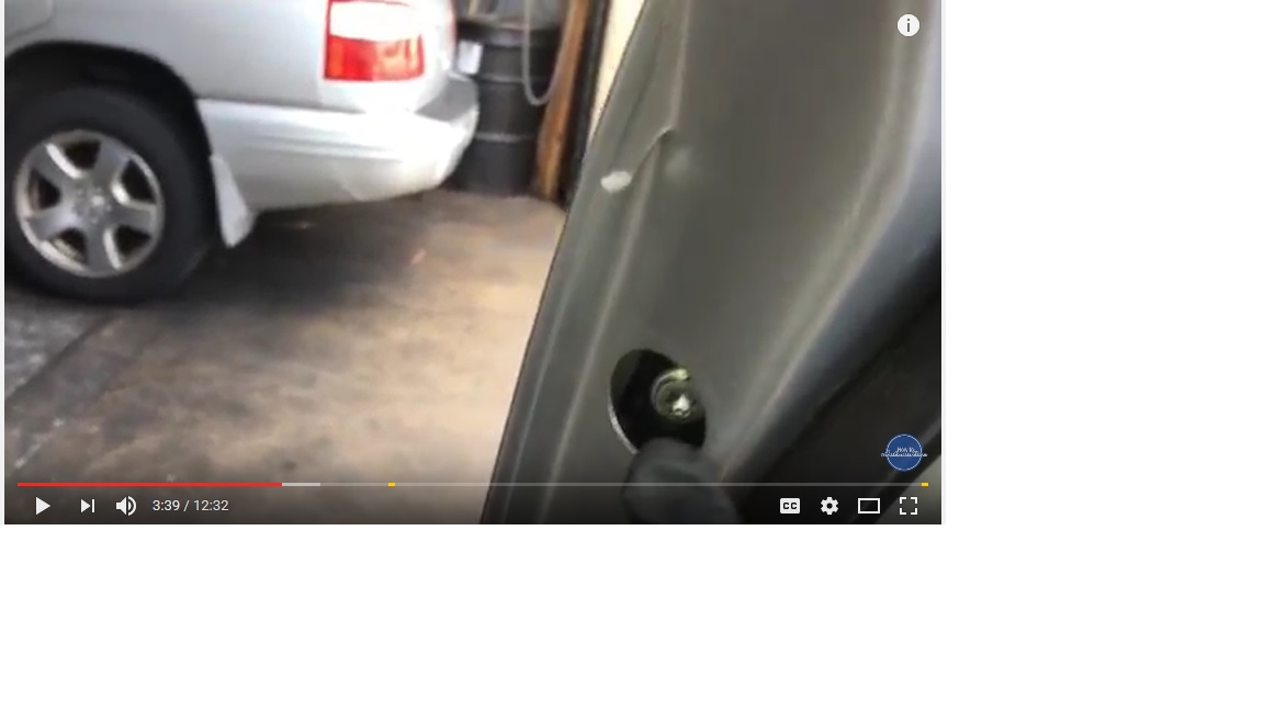

So for the last two weeks I've been hearing a rattling sound coming from the left side of the door. I thought it was some items I had in the rear door cup rattling around, I removed the items but I could still hear the rattling. So last night I tried locking the driver door with the remote and nothing happened. So I tried again and I heard this sound of gears grinding/clicking in the driver side door. Also noticed the inside door handle and lock didn't want to move but the unlock button still worked. Seen the YouTube video of the guy taking apart the 07 door panel, so I thought I would check the side of the door and check the
T30 lock screw (not sure what its called, see attached photo for the screw location). I found this screw completely loose and ready to fall out. I'm thinking that the loose screw may have caused the Actuator to fail.?
I may just add lock tight to the T30 screw when I replace the Actuator, that should keep it from getting loose.

Replaced the actuator today. It was pretty simple, it only took me 40 minutes. The part that took the longest time was trying to put back the window track. Here's a video before the replacement showing the lock actuator making noise.
https://youtu.be/mFeWPgLZ4TY
