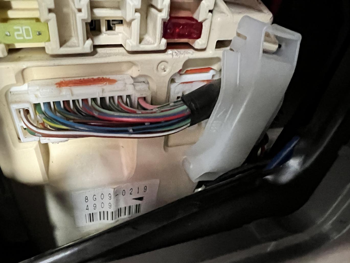

Today as it was acting up, I could also hear a relay clicking from near the fuse block. This makes me think the faulty signals are originating there. When I put my hand on the bottom of the fuse block on the main harness, I could feel the clicking. After pushing around on that harness (see attached pic), it felt like it stopped for a few minutes, before it began again. This might have been coincidence.

Thanks. I'll look into that pigtail. What's so strange though is the intermittent nature of it all. It's been fine for the last week - waiting for it to rear its ugly head again, and will then dig back into the door to catch it in the act. LOL.

The door lock motors also have a built-in position detection switch. If that is intermittent, the lock control system may freak out. Water can also get in through the firewall grommet in the back driver's side corner of the engine bay and get down on to the back of the fuse box + body ECU there... so, they are both possibilities.
