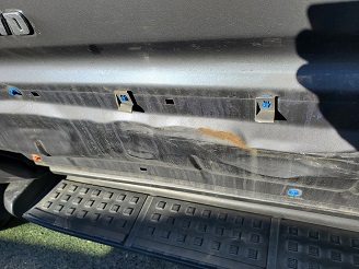

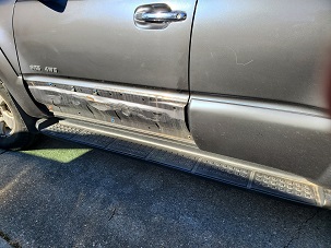

I have a 2006 4Runner SR5. The drivers door exterior panel came off.

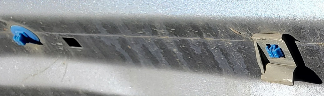

In the third picture,, I take it the gray piece is broken off the actual panel??
So other than getting new door panel clips, am I still going to have to "modify" or purchase a new door panel?
I hope I explained this properly.
Thanks,

That’s going to be a pita, a couple of your mounting points from the cladding broke off, I had to fix mine and used some jb weld to reinforce the weak points
I just moved coast to coast. My body guy is 3000 miles away. Talked to him and he said easier to replace the panel. The mounting points are broken off, gone.
I did find one ! Going to get it tomorrow.
Thanks
