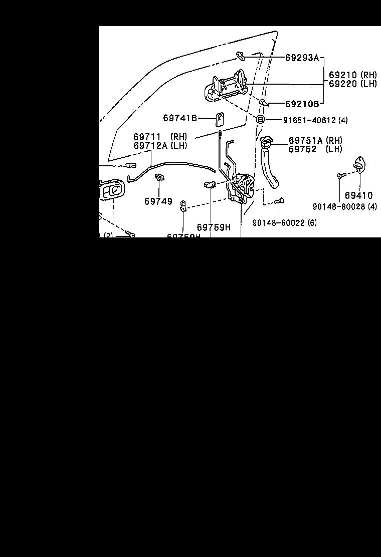

4Runner010 New member Aug 18, 2016 #1 So my door won't open from the outside and i need to get a door lock rod clip i think I'm missing the clip that holds the rod into my handle . What the hell is the damn part number!?!?

cfranck1 New member Aug 18, 2016 #2 RH Side: 69293-12030 LH Side: 69293-12040 Double check with local dealer to be sure they are still good numbers? Attachments 670458A new.jpg 54.3 KB · Views: 857
