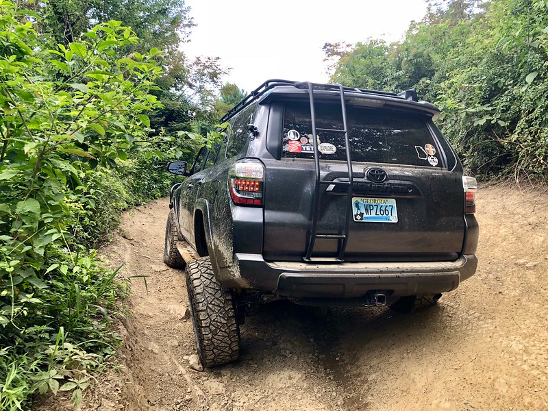

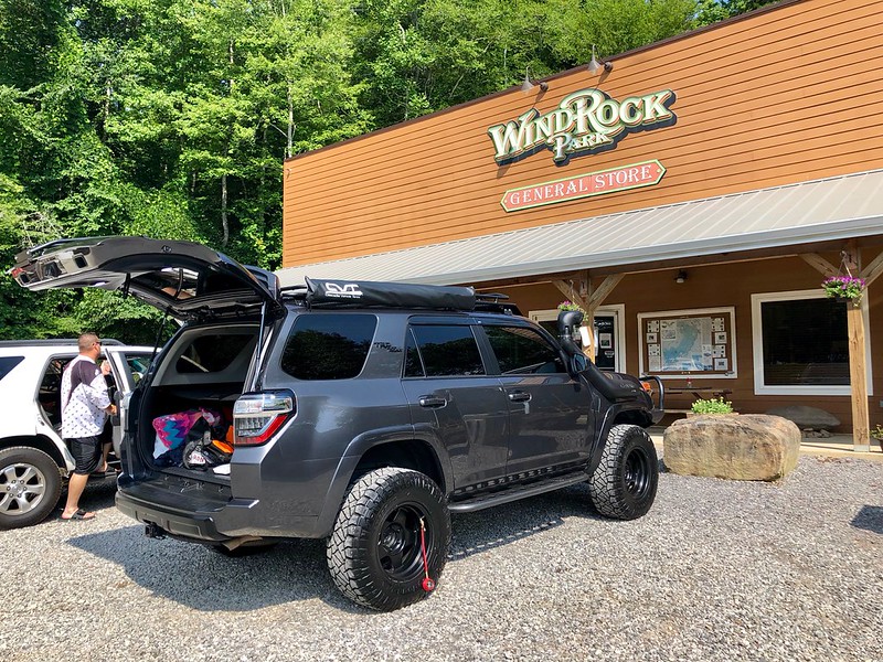

And here's a picture just for fun from my recent windrock tirp.

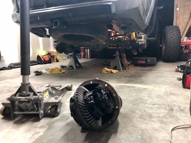

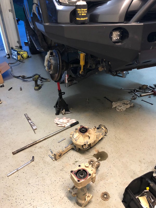

About 2 weeks ago I received my new third and clamshell with the 4.56's installed from ECGS. Took about 2 months to get. I was told '17 & '18's have a bit different thirds and they needed to wait for a newer third to come in??? ehh, I'm just glad I finally got them in.
Install was super easy. Nothing too hard about it, just time-consuming. I used a write-up/DIY for an FJ and it worked great. My friend Bryan helped with handing tools, lifting stuff, and drinking beers with me. These parts are heavy!
The rear was definitely the easiest end to do.
Did the rear on Thursday night when the gears arrived. Did the front the following Friday evening. Tip: Make sure to jack the vehicle up high enough to give you plenty of room and use big heavy duty jack stands.
After install, you can immediately notice how much power this thing has gained back. 295 and 4.56's bring back plenty of torque. I couldn't imagine how the 285's are but I plan to go up to at least 305's later this year.
Now that I am past the 500-mile break-in period I can comment on hwy manners. This thing will cruise at 80 mph no problem and pass with ease. The MPG has gotten worse for me. Probably because it's easier to mash the gas and get results. City is around 12.5-13 and hwy has been around 14 mpg. They say not to change gears for MPG, change them for the power and that has been clear.
I have not been offroad with the new gears but I like everything about the new setup. I was on the fence between Supercharger or Gears and this was the cheaper route to get power back to the ground.

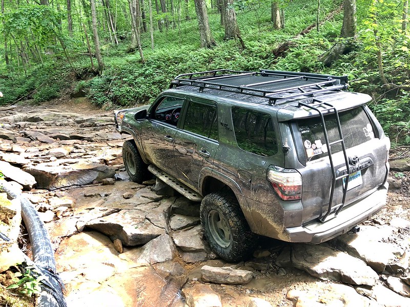

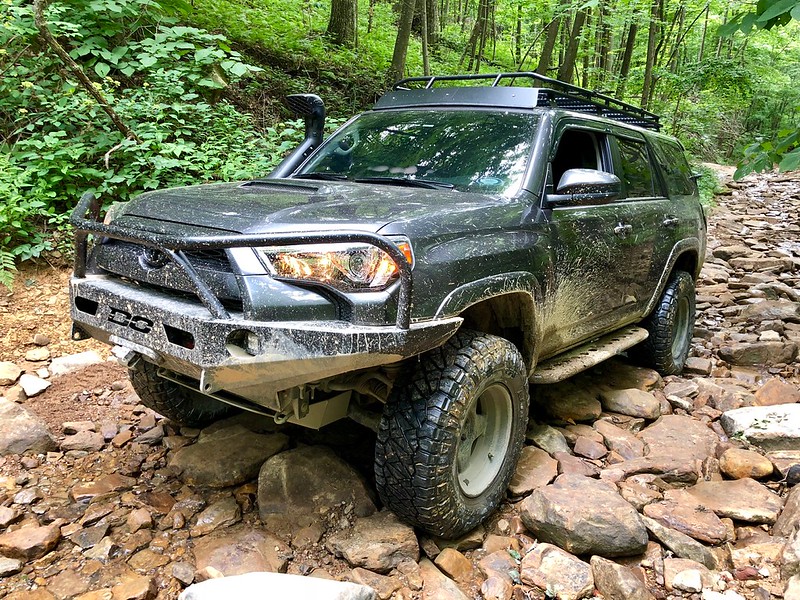

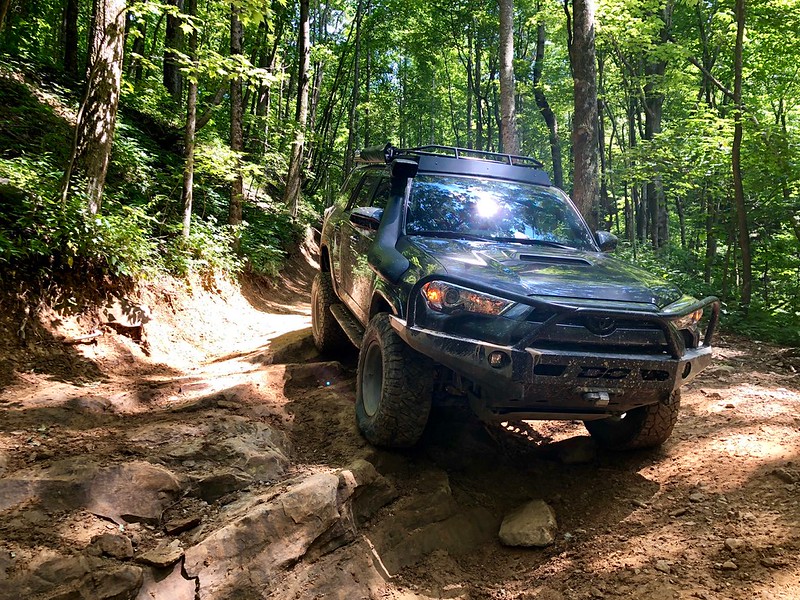

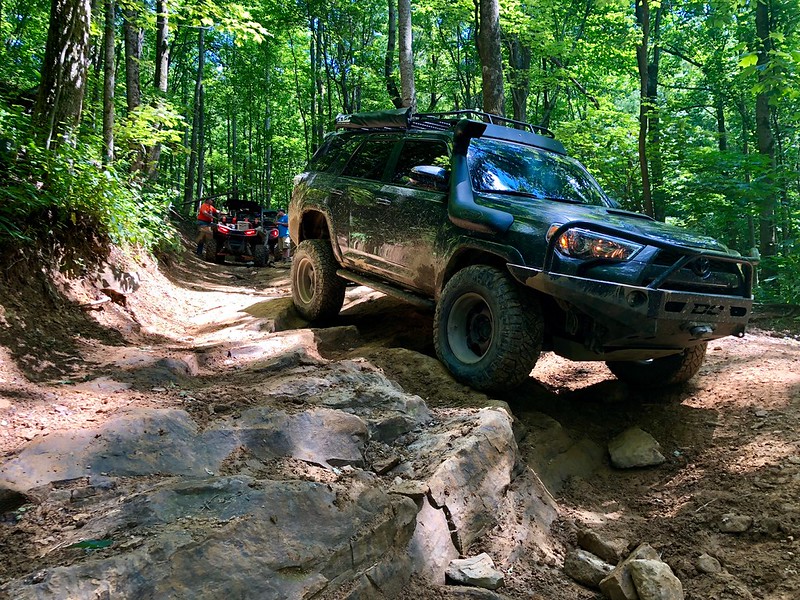

Hit some trails at Windrock this past Sunday. New 4.56's are great off-road! Before I rarely used 4HI due to the low power. I just always used 4LO. Now I am able to use 4HI to get through just about everything until the going gets rough.
