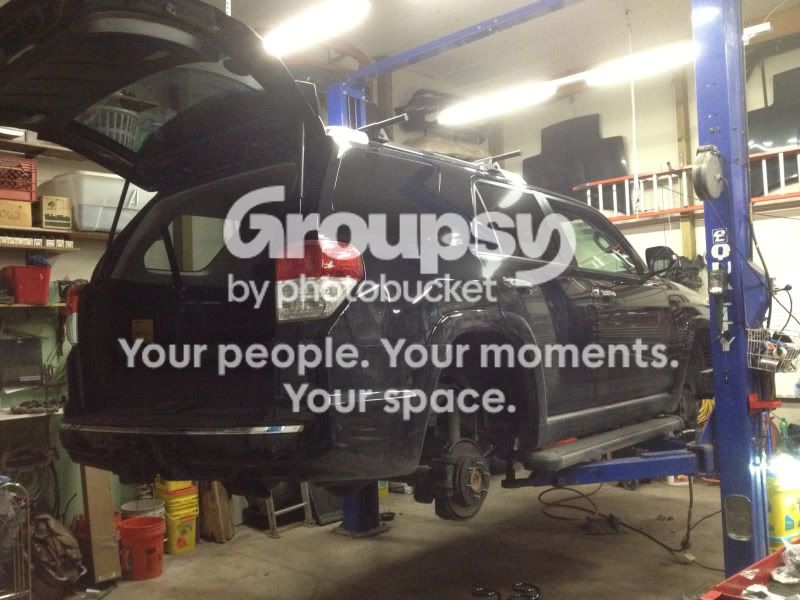

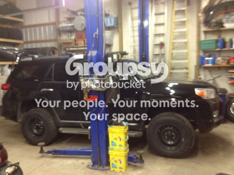

My friend had some vacation days to burn, so we used his barn and lift to get my lift installed. We put bolted in the toytec ultimate lift and threw on a set of fj steelies wrapped in 285/70r17 Bfgoodrich all-terrain KOs. Dash abs, vsc, and 4wd indicator is on, so we broke something in the process, but she rides good and there's only a slight rub with the 285s and only on slopes and uneven surfaces at full lock. I hope the fender liner mod should resolve this issue. Having a toyota mechanic friend look at the codes and perform zero point calibration this weekend.

The rubbing is getting worse. Before, it was a slight rub in the left front at full left turn lock. Is this a function of the suspension settling in? Scheduled for alignment on Monday...safe to drive in the meantime? I have fj steelies. Anybody try a stock 17x7.5 with 285/70r17 that has had this issue and was able to resolve?
search for specifics but, basically what you need to do is try to dial in more positive caster (as close to about 4 as possible) and also possibly move the fender liner forward a bit for better clearance. At least that's what I gather from reading posts here, my car is completely stock so no rubbing issues here :)
Zero point cal should dim the Christmas lights. Your alignment tech will probably be unsuccessful in getting you to 4° castor as well. Time to start shopping for new Uca's.
Cool, thx Jono. I have installed LR UCAs, will I be able to get the desirable settings?
Should be able to, yes. Popular wisdom suggests that even with uca's, getting the correct alignment numbers will depend on the aptitude and work ethic of the tech working on your truck. Try to get it into a shop with 4x4 experience.
