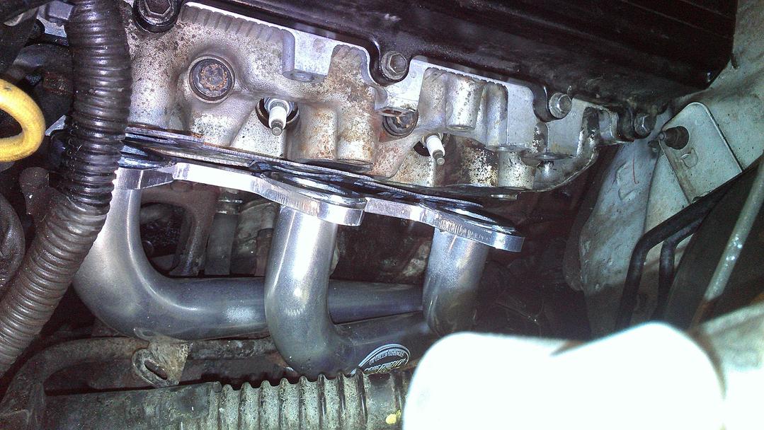

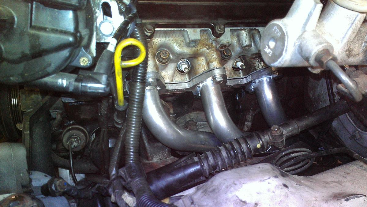

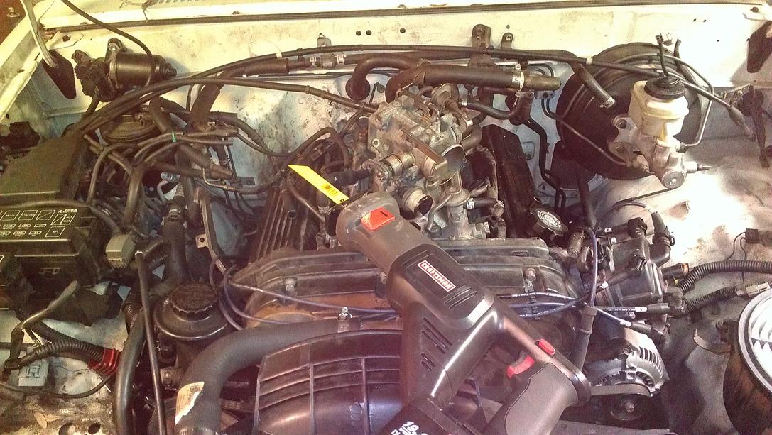

Here it is folks....I was going to do an engine swap but, goind=g with headers and high flow cat and dynomax muffler.Here's how it went down...
C:\Users\joe\Pictures\header build\IMAG0856.jpg

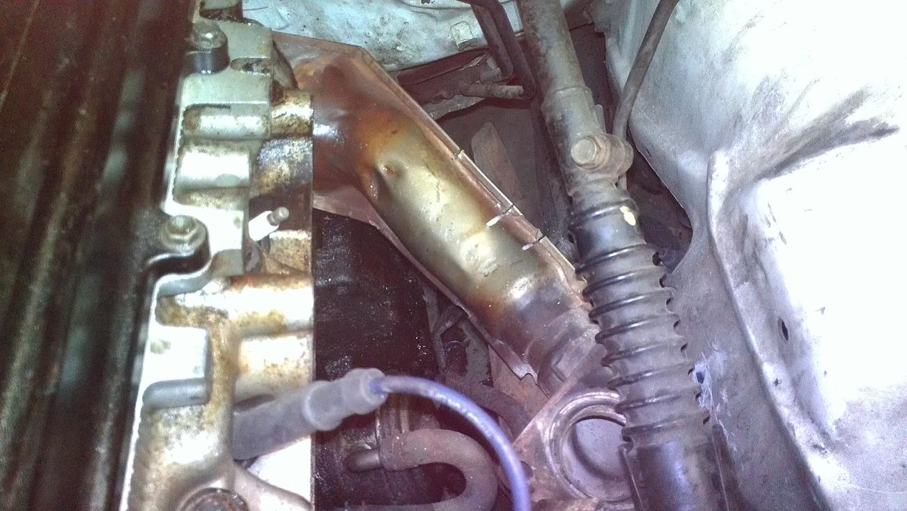

Here we have the illusive crossover pipe aka exteme heat maker!! Those little cut marks are where shes gonna get it!!! I lowered the transfer case about 5 inces to give me some more room. there is a shift linkage bracket about the ttransfer case you need to remove before lowering.
C:\Users\joe\Pictures\header build\IMAG0857.jpg

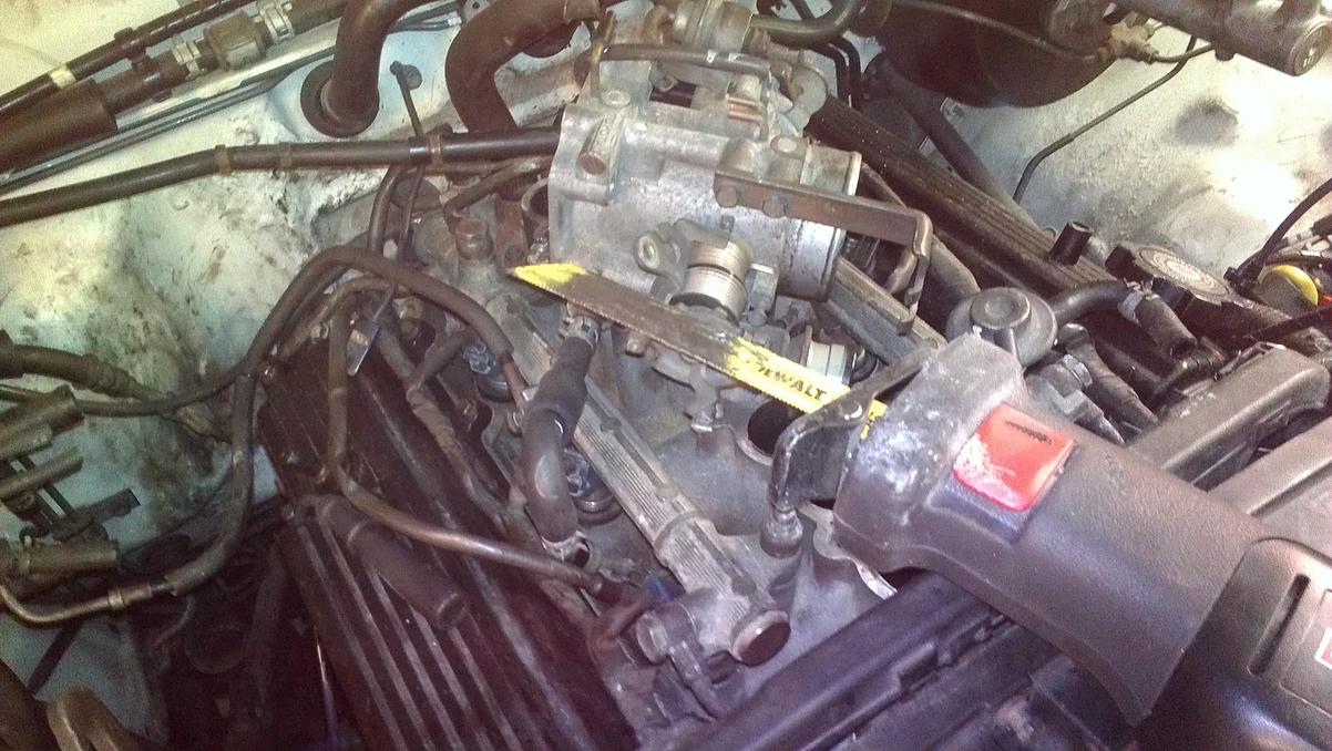

Here is special removasl tool for said crossmember!! hehe
more pics and up dates to come very soon

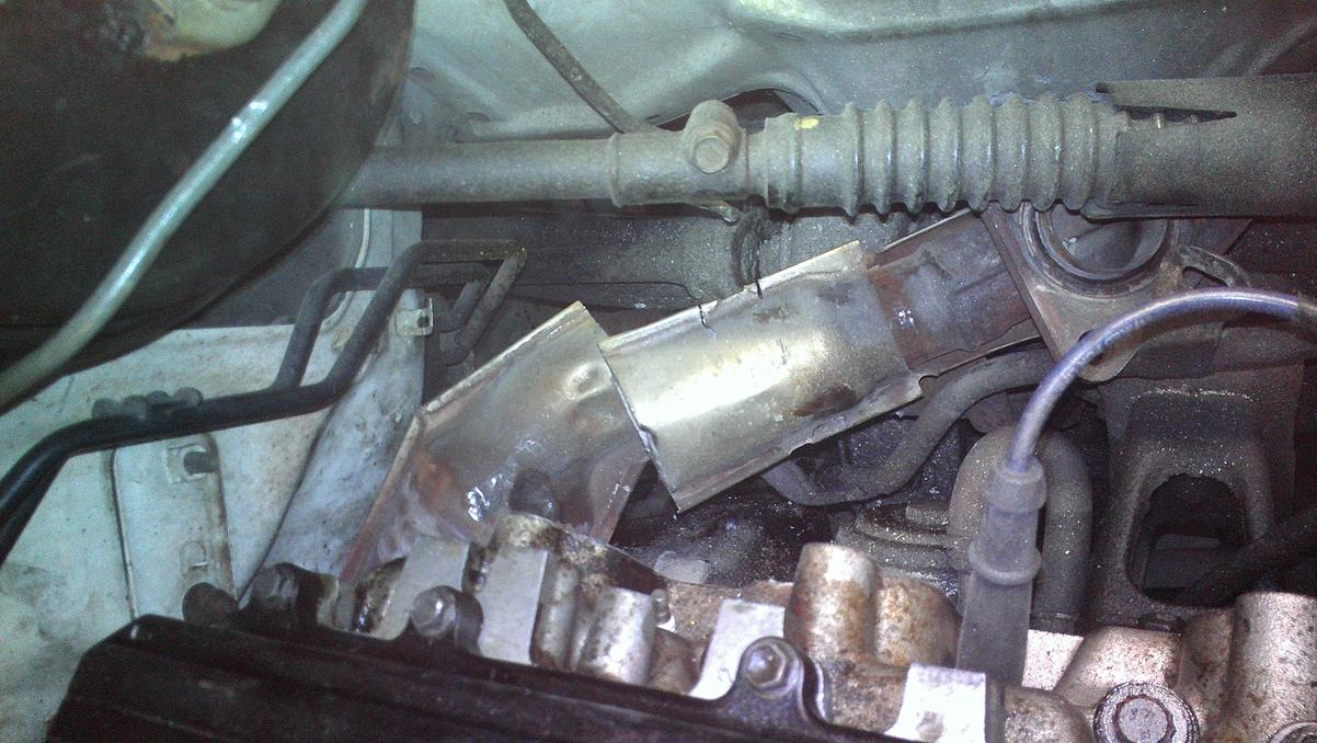

Here is that little.........crossmember pipe after removal and special took a beatin but it was fun!!

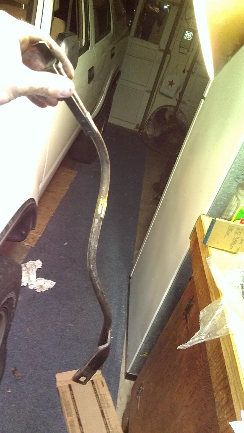

On the bottom right of pic there is a little bracket for the tans dipstick that needs to be removed and then the dipstick tube needs to be modified some bending is involved
