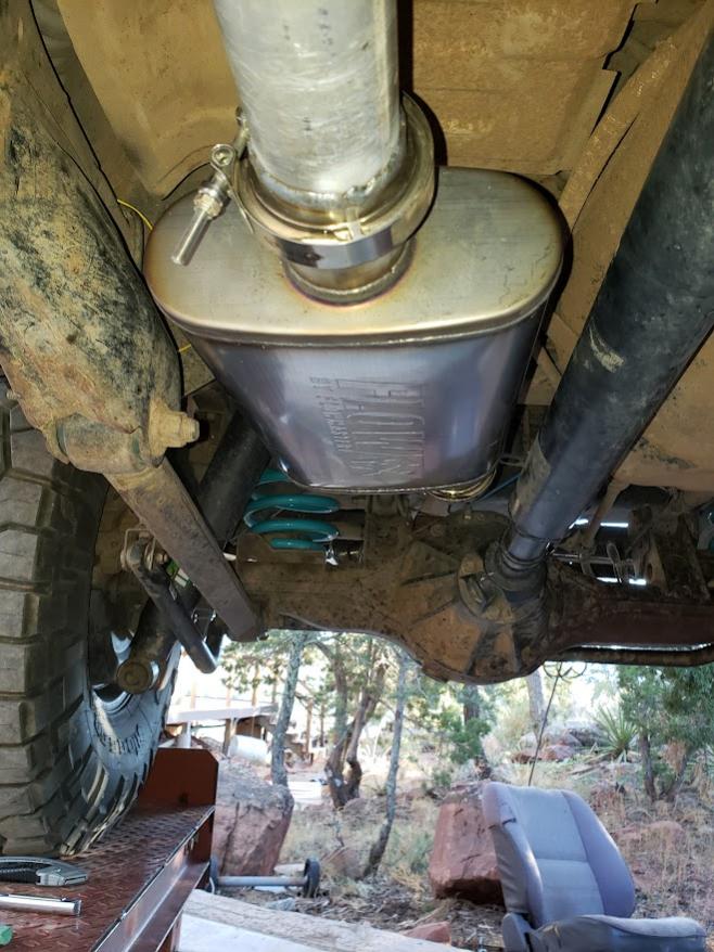

One of the Magnaflow cat might have the honeycomb matrix blown out since I'm now getting a "cat below threshold" CEL. When the time comes for me to swap out the cat, I'll install exhaust V band clamps, something like these. Knowing what I know now about exhaust pipe connections and the hardware, I'll use V band clamps on everything related to exhaust. Yeah, the upfront cost is higher but the ease of connecting/disconnecting exhaust sections from each other is a breeze. No more exhaust gaskets and junk. No more worrying about shitty hardware rusting out and such.
I did this V band thing when I redid the exhaust on my 80 series with 2.5" SS mandrel bent piping. Man, what a pleasure it is to remove exhaust sections, muffler, etc w/o a pissing contest. No more exhaust leaks, and so easy to bring two sections together. Pic is from the 80 series.
