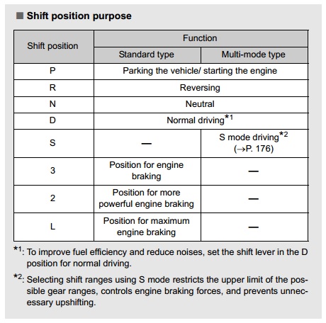

Out of curiosity what page of the manual are you talking about? All I see in the manual is this:
●Use engine braking (downshift) to maintain a safe speed when driving
down a steep hill.
Using the brakes continuously may cause the brakes to overheat and lose
effectiveness. (→P. 175)
Here's the nifty chart that the above paragraph is pointing us to. I doubt Toyota would publish these kind of recommendations if they thought it would damage our drive trains :)

The owners manual has a ton to say about engine braking. Nothing is cautionary from a wear standpoint and it explicitly recommends engine braking when descending steep hills.
