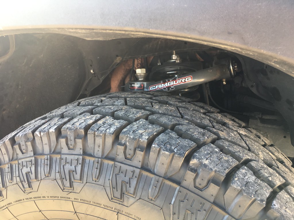

Upgrades and Mods as of May 2014
Suspension:
Bilstein Tundra 5100's with Tundra TRD Coils (front)
Bilstein Tundra 5100's with OME 891 Coils (rear)
Camburg Racing Upper Control Arms

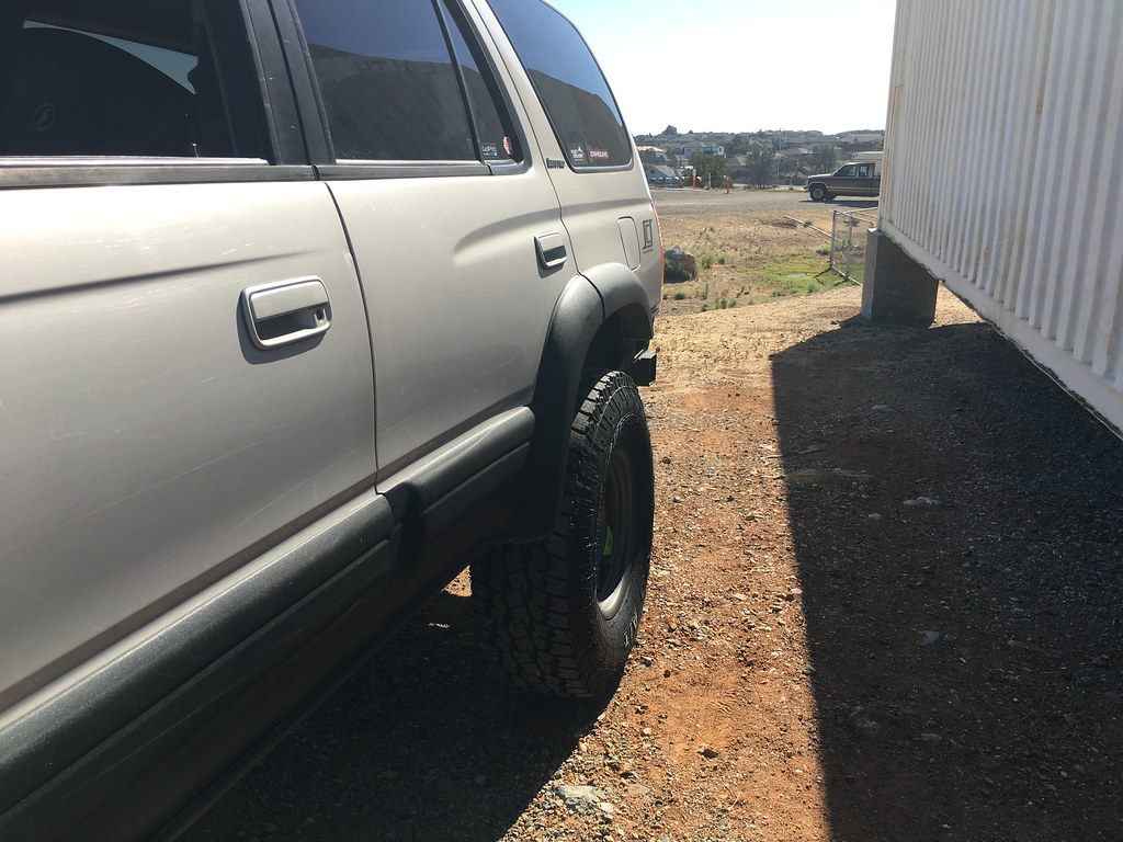

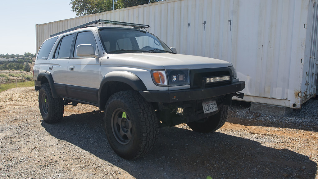

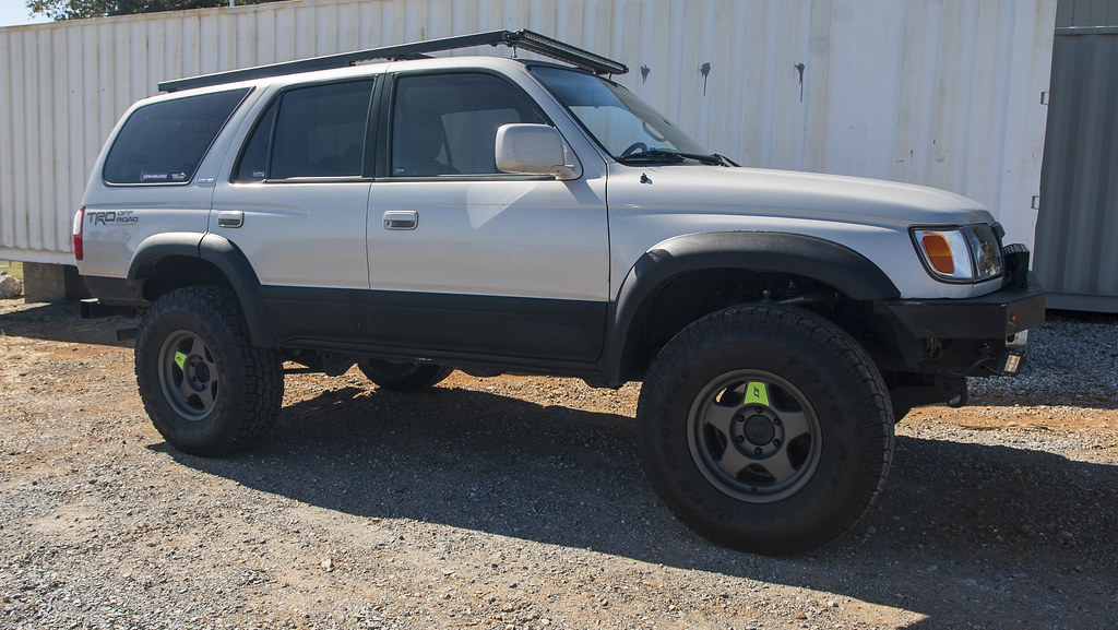

i wanted to post a quick update, sense I havented posted in a while. A few things that have been done,

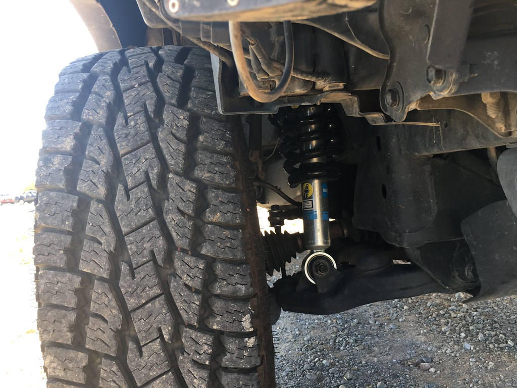

New Bilstein 5100 Tundra Suspension
Camburg UCA
Custom Roof Rack

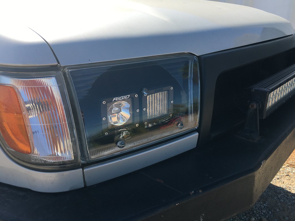

Custom Headlights

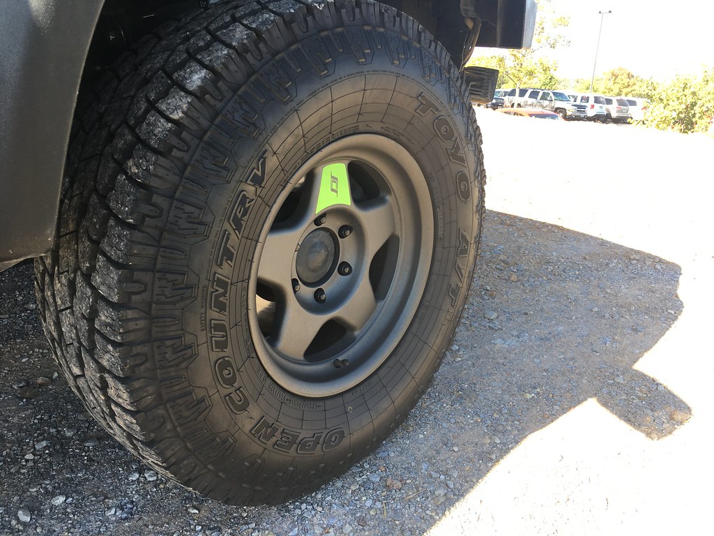

Toyo AT ii
Stealth F5 with Custom Vinyl Spoke.
Also just want to say my good friend <a href="https://www.instagram.com/chasewarner2/"> Chase </a> had the idea for the custom color spoke and stealth had the idea to use vinyl, after which we started seeing everyone start adding it! I just wanted to give credit to Chase for the idea!
Here a few photos!
