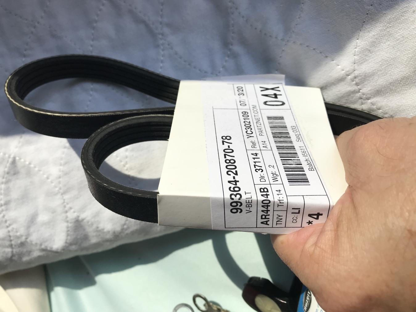

2002 4runner : Got the 4pk870. Mcoo brand on Amazon and does not fit my ac compressor even with the idle pulley removed still can not get it over the 2 other pulley
Ripped it out and measured the length at 34.5 inch that is 875mm
Not sure why it does not fit.
Read in a post another guy with this issue who used 5pk890
Any idea what is going on and what belt should I use?

I purchased the a/c belt pictured below directly from Toyota dealer and had no fitment issues on my 02……not to say it was an easy install as lots of four letter words flying around the garage.

Yeah the 870 belt does not that well on this car, 890mm fits so much nicer
toyota uses that 870 for a lot of cars, I have feeling they were trying to save themselves from adding one more belt to their inventory of parts
