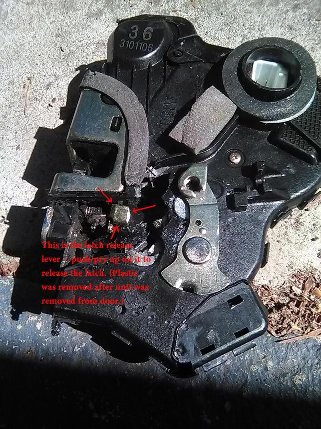

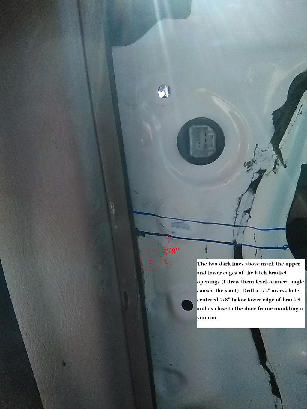

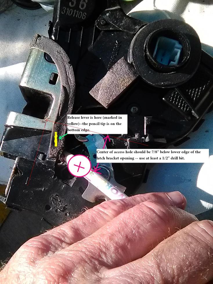

I recently had the driver's door actuator go out on my 2004 4runner. Of course, it failed with the door closed and NONE of the yanking cables type attempts would allow me to open the door latch.
So....
1. Removed the lower back seat (optional but makes it easier to take out the front seat and sit on the floor) and then the driver seat.
2. Removed the screws from the interior door panel, pried and propped it open as far as I could.
3. Unhooked the cables from the handle unit.
4. Drilled a 1/2" access hole centered 7/8" below the lower edge of the latch opening bracket (you can see it between the door and the door post) and as close as I could to the door post moulding. This hole goes through the sheet metal and into the plastic case ~1/4". See attached pictures.
5. Stuck a flat tip screw-driver in the access hole and pushed/pried up the release lever while pushing on the door.
QED (a mathematician's version of "got 'er dun")
