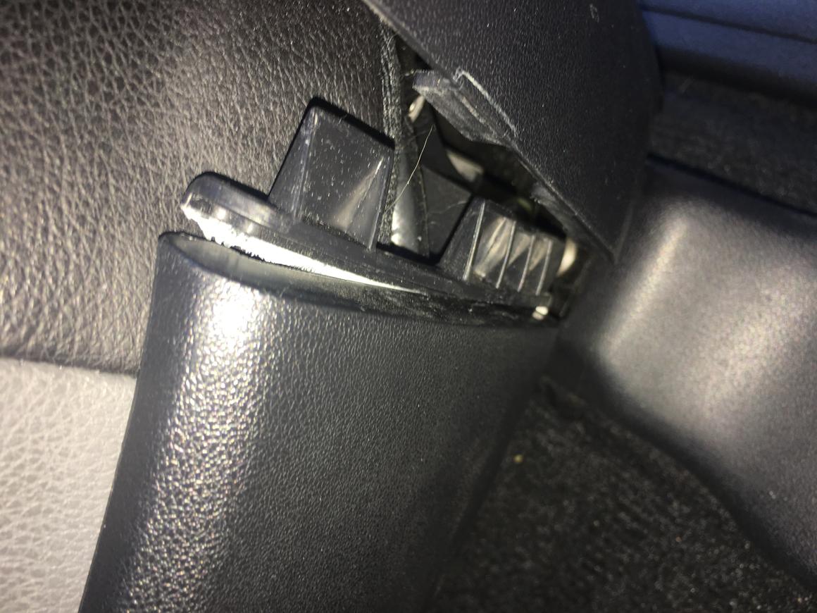

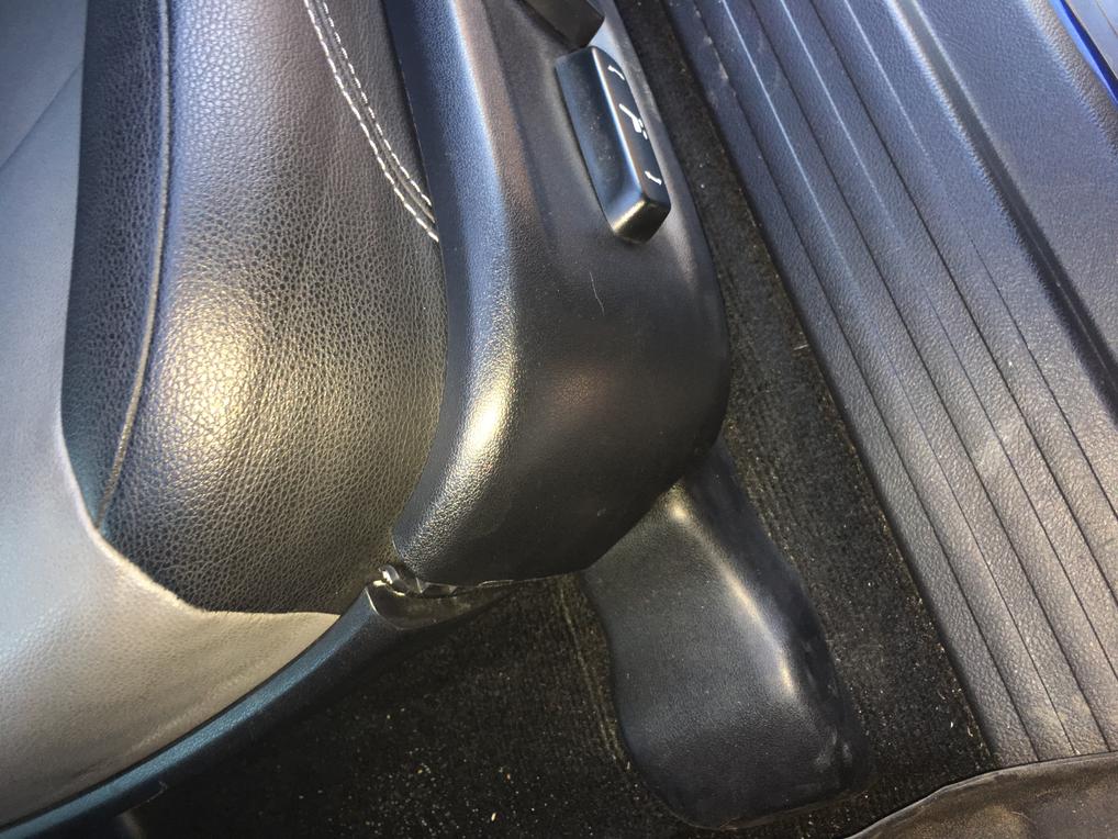

Hi. My apologies, I should have been more detailed. For a while where the front plastic piece is joined to the left (side) piece, the male fittings would not be seated all the way into the female pieces. Now it appears the front piece has the male attachment clips pulling away from the plastic, so the corner where the left side and front side meet no longer connect
(Sorry I’m on my iPhone and can’t figure out how to rotate the images)

No worries, the pictures are clear enough. Let me look at my front seat again tomorrow to make sure I understand which part is broken and take some pictures of my front seat tomorrow evening for you, to show you how the trim part is mounted to the seat frame.
From what I see in the photo, the plastic part on the front of the seat is still attached to the "slip join" of the outer left hand trim with the seat switches, while that trim part has basically broken.
Going to be honest here, the easiest way to replace this is going to involve pulling the seat from the vehicle. If you are ok with doing that, i.e. undoing electrical connectors after the battery is disconnected, and undoing four bolts holding the seat to the floor, you should be ok. If not, I would recommend the dealership.
This is maybe a one hour repair for the dealer, which even with the cost of a new part is less than the warranty deductible you listed.
