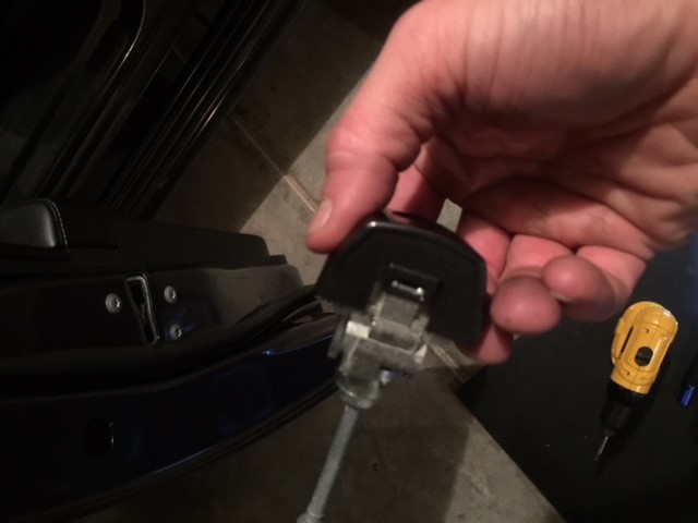

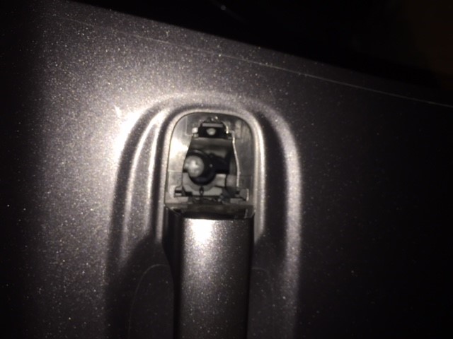

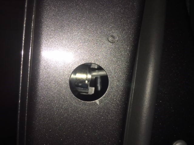

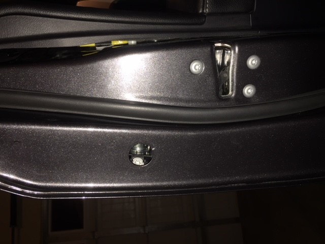

ok - so I answered my own question - there is a 20mm or so blanking grommet on the door jamb - I took this off loosened the torx screw behind it & this let the lock barrel come out - I could then thread the shaft back into the actuator - took 3 minutes - hope this saves someone time in the future if their keyed entry doesn't work after an actuator change! Feel a bit stupid but then doing your own car repairs is always a humbling experience at times.........
You made me check, and turns out my own "fix" didn't get that part right either! Did you do this with the door panel off, or did you just back it out, then screw the torx back in while everything was "operable"?
I really appreciate you guys putting up all the pictures and information. I am just wrapping up my install. I'd say this took me about 3 hours. Removing the door took about 15 minutes, the actuator only took about 15 minutes, but putting the stupid panel back together...holy crap. Anyways i just wanted to say thanks. Also, i had the same issue with the actual key lock not catching the barrel. You do not have to take the panel apart.

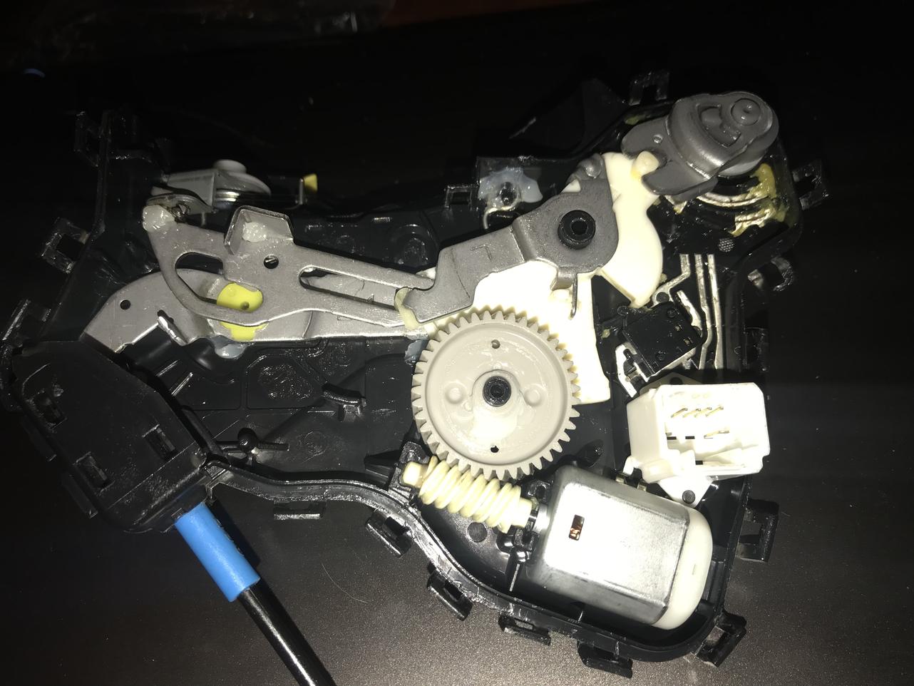

Does everything look correct in this pic ? I think the metal piece with the “L” on it is causing my problems

Nothing in your picture jumps out to me as being out of place. Look at the OP’s pictures and compare it to what you have now. Also, put everything together outside of your vehicle and pull on the cables by hand to make sure everything works as expected (lock and unlock, unlock by pulling the interior handle cable).
If you can put up another picture with more light and a different angle and I’ll check again if anything looks out of place, or maybe someone else will notice something.

I think the piece with the "L" should be in the halfway point of the slot it "attaches" to instead of all the way maxed out. Not sure if that would fix it, but when I did it I recall that being a specific part of it - to have that slot piece in the 'halfway' position.
This should make the "L" piece and the "slot" piece effectively straight across instead of an angle like it appears in your picture. Hope this helps!
