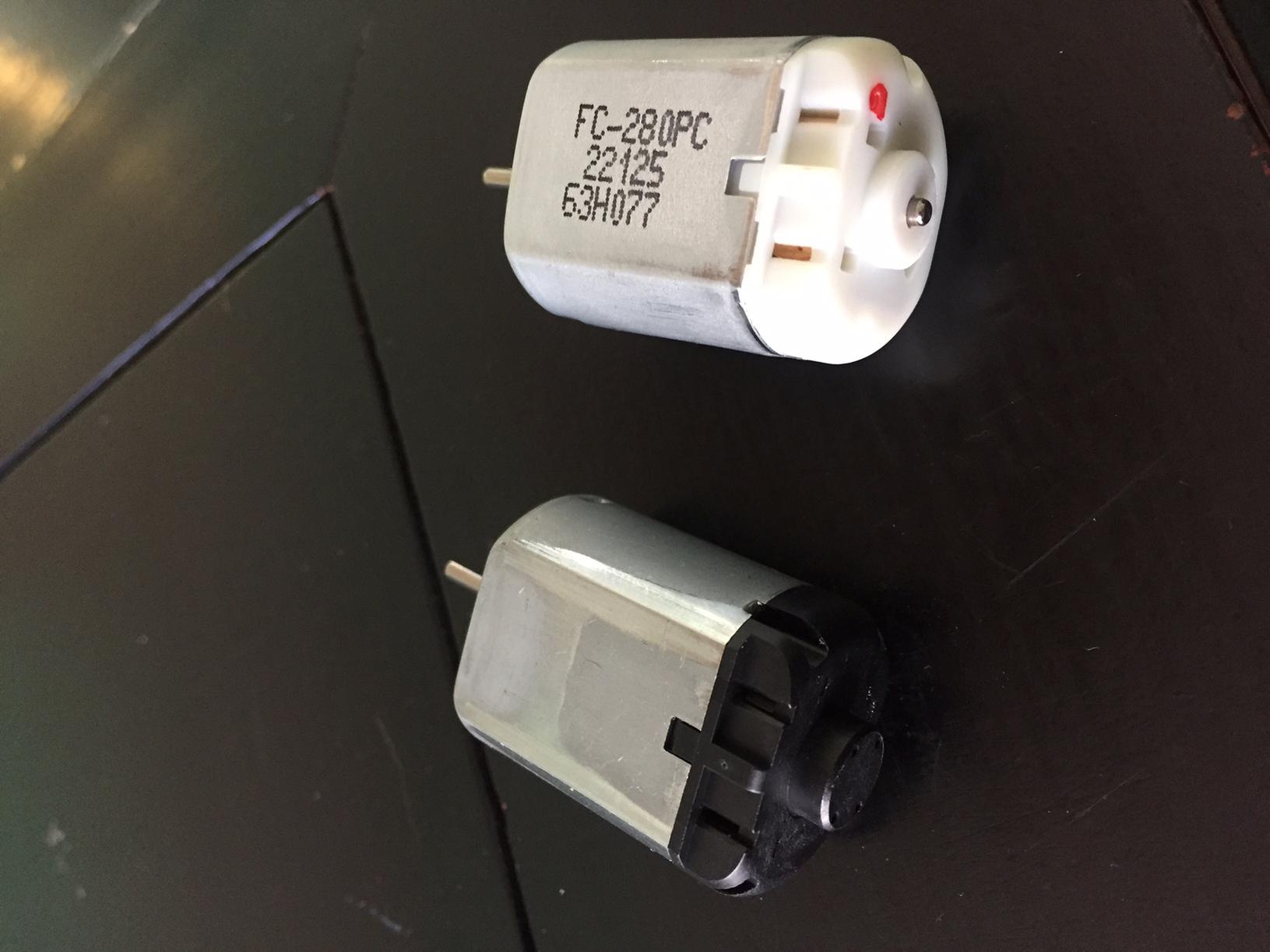

Can't thank you guys enough for the help. I brought my 2014 Trail edition to the dealer for oil change and inquired about fixing the driver side door lock that had not worked for about the past year. They told me that the part, I believe they were referring to the actuator, was about $350 and labor would cost more than that. I follow the instructions on the two videos and purchased the motors from the Amazon link. The actuators appeared different from the ones in the video but the motor assembly was spot on. I've attached a picture of the old black motor pictured next to one of the white replacement motors. You guys definitely saved me a ton of money and I am grateful. This forum continues to be a wealth of knowledge. I'm a psychotherapist not a mechanic and I was able to pull this one off. I did forget to attach the bar leading from the external door handle to the unlocking mechanism and locked myself out of the car for a good 45 minutes. My loving and supportive wife found this hilarious.
