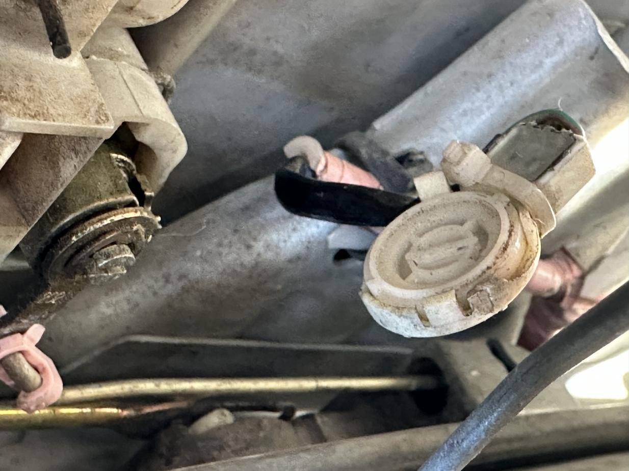

1998 - Where to find that D20 rotary switch?
Hi- new member so I can’t post yet. I got a 1998 that has a similar problem as the original post. Pulling stuff apart on the door I noticed the ( attached photo) rotary switch floating free around the LH door lock. It looks like some plastic is broken on it and the slot looks like it would sit on the slot at the end of the lock cylinder. Following the wires of the D20 connector- this appears to be the Door Key Lock and Unlock SW according to the total shop manual. I manually rotated the inner tab and voila the motor activated and locked the door. Otherwise only the key outside can mechanically lock the door. Does anyone know where (another part name maybe?) to find this switch other than a junkyard for a 1998? I can’t find any photos or videos that show this switch.. kind of at a loss for googling..
