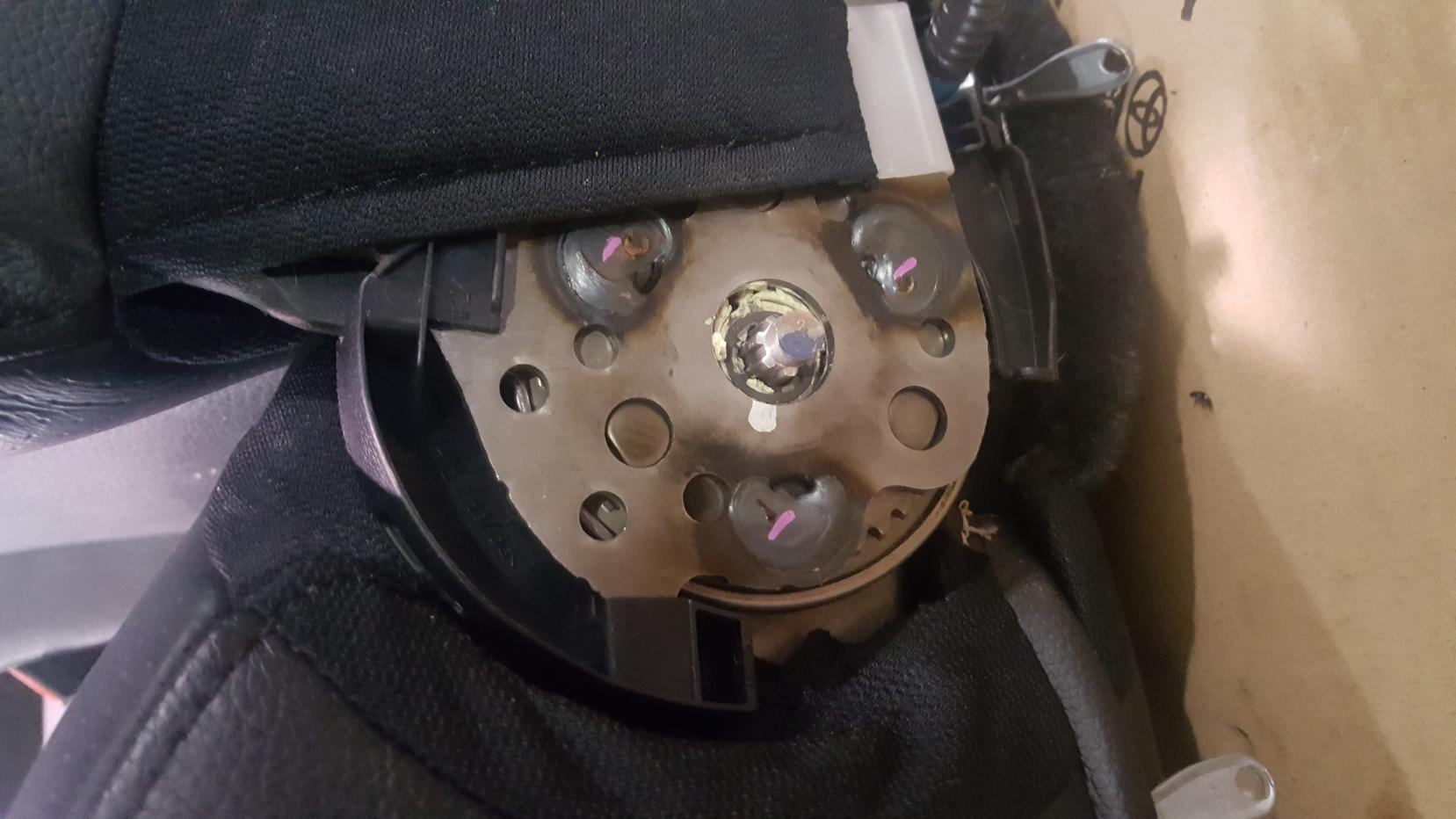

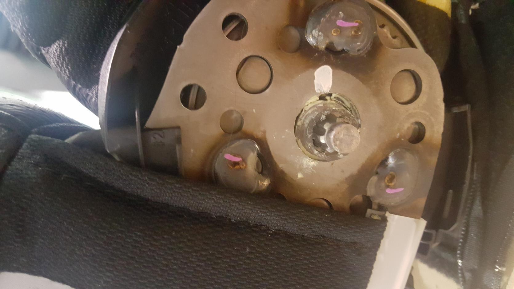

Hey, figured out this one-sided recline issue! The drive shaft that rotates the seat back and forth popped out on one side. They use these cheap-shit clips to keep it in place and one was missing or never put on to begin with. Took off the plastic housing on the sides and saw that the shaft was pulled all the way to the door side of the passenger seat. Only thing keeping it from shooting out of the car was the housing! Pushed the shaft back in and used an aftermarket circlip in place of the missing one. Voila!
Skillet, right in. Had to take it apart to figure it out on my 2010 Toyota 4runner limited. Here is a pic... The rod that reclines the left and right parts of the seat is slides around.

Forgot to come back to this. Mine was easy but not really fixed. Pop off the plastic shroud that covers the hinge point where your seat reclines. Most likely a metal rod will be sticking out or there will be a hole where a rod should be. Mine was the former. I had to play with the seat a bit to get the rod lined up with the other end then I tapped in back in place with a mallet. It will keep working its way out so you do it again every now and then. Have not tried to figure out how to keep it in place permanently because that will require removing the seat. Good YouTube vid on the seat removal I just have not had time.
