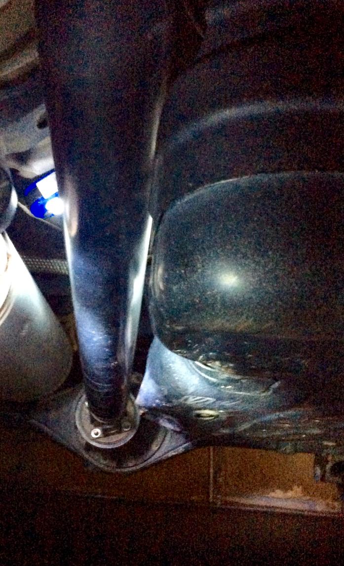

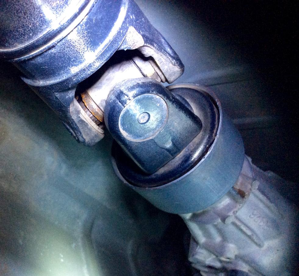

So I roll on under and start lookin around ...not even a minute and I locate the culprit ...she like really?
So of course she wants to see..something she doesn't even know what she is looking at but hey ok.
Something looked wrong ...ya think!!

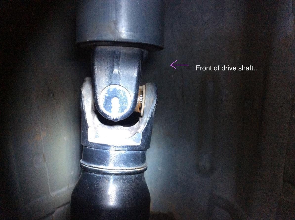

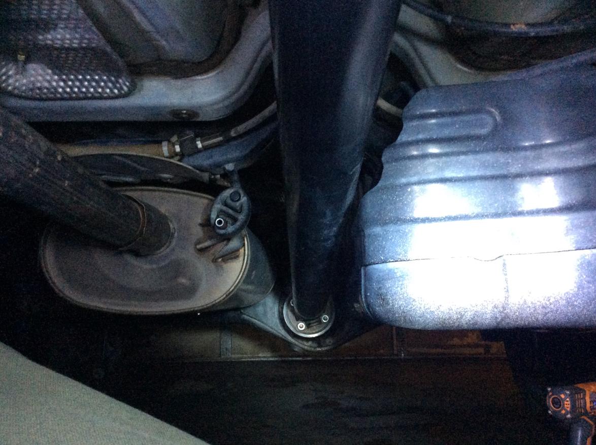

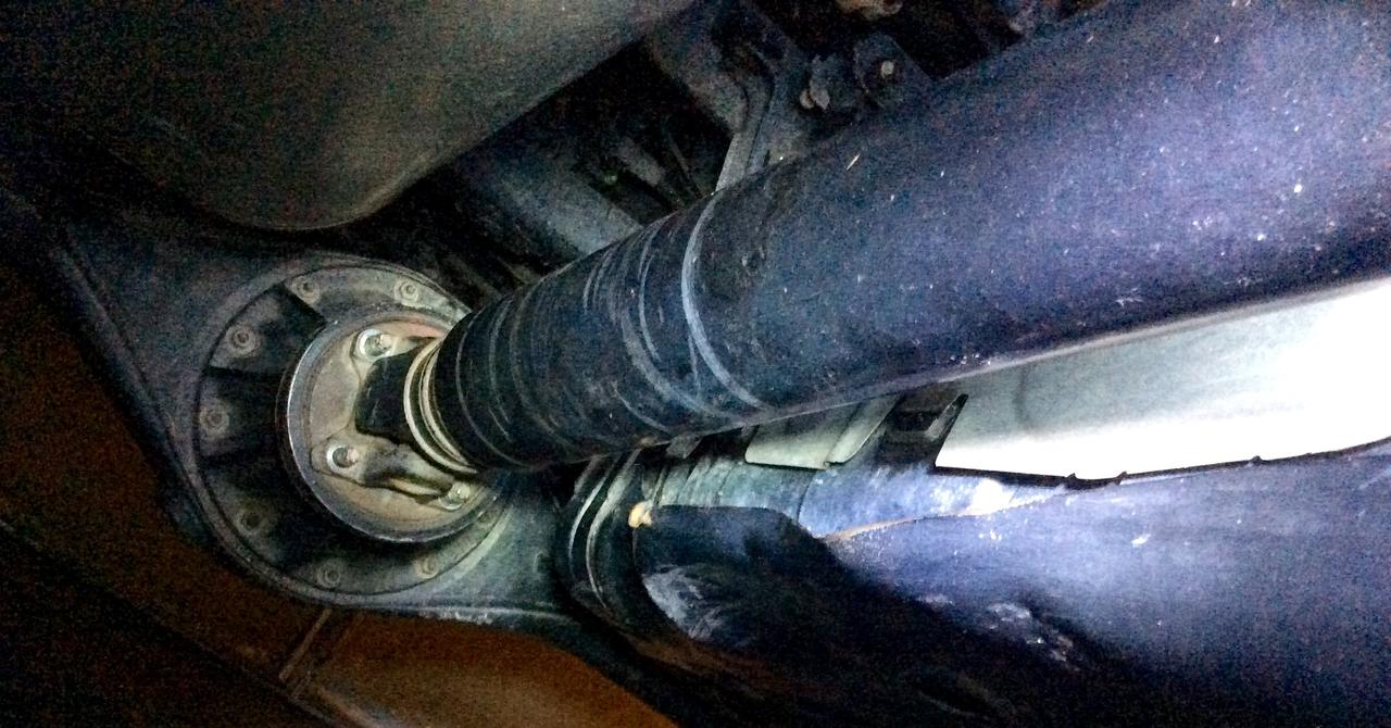

Uhhhhh. Something doesn't look right hahahah. Wonder if you can get a 4wd driveshaft with the zerks? And how the **** did you bend it?
