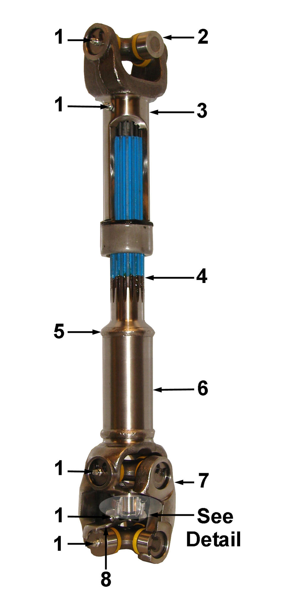

Tom Woods Custom DS all the way. I paid around $416 for a 3" dia. shaft, OEM is only 2.5" & I upgraded the u-joints & Dbl Crdn to 1310 Spicers so it can be rebuilt at any local DS place now. Their u-joints are guaranteed for life too. Check out his website. Bullet Proof!
Awesome! Glad to hear of a good experience, especially with a non-factory driveshaft. Did you take any pics of it before installing? Would like to see the Tom Woods construction, balance weights, and max angle offered by the double cardan.
Here you go...
