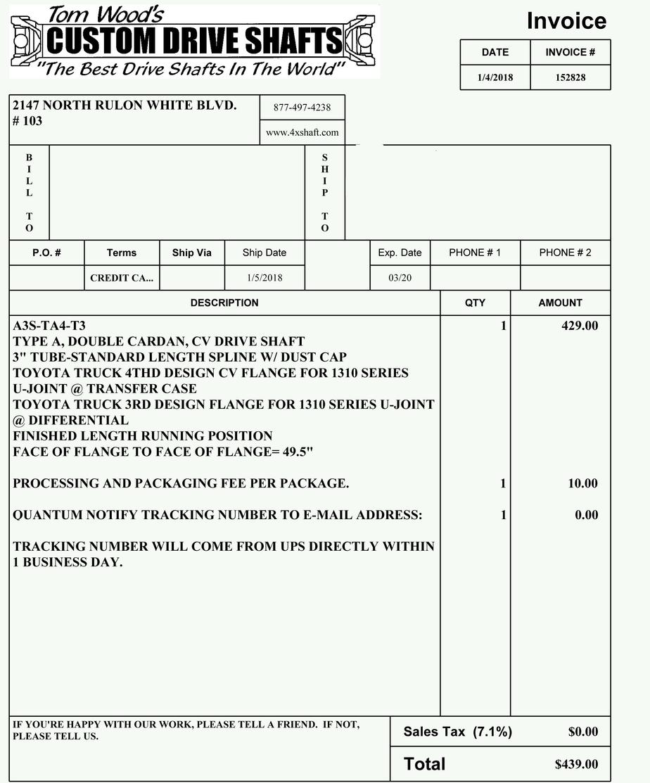

FYI, Tom Woods has renamed the flange at the diff to "Toyota 3rd Design Flange". Here is my invoice if anyone needs the measurements. Built and shipped in 1 day!

The problem I'm having is that I put in an e-locker axle from a 2000 limited & it seems like I have to pull the axle forward a lot to get the driveshaft to bolt up. Maybe the diff/flange length is different between 4cyl/6cyl?
EDIT: When I look at Chuckles DS measurement above his is 1" longer than mine.

I made the uninformed mistake of buying a complete rear DS that came out of a V6/auto with the standard non-multi-mode t-case. When I tried to install it, I found it to be about 1.5" too long. Our driveshafts have the last few inches of the tubing neck down to a smaller diameter ( compared to the diameter of the main part of it ) making it impossible for my drive shaft shop to shorten it enough for re-use.

Toms has a terrific page that pretty much spells out how to measure for a custom shaft.
