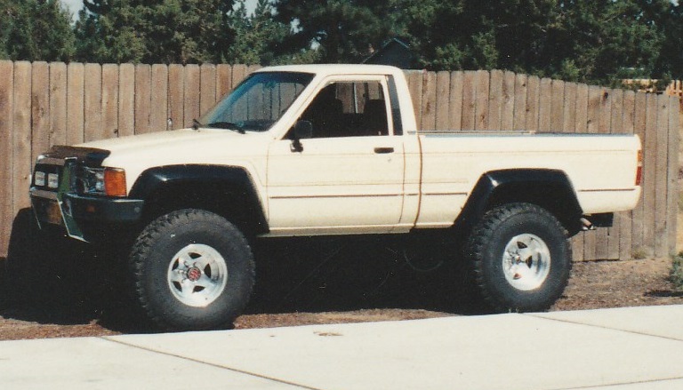

I had a 1985 Toy pickup on 35's... it was hard on the drive line stuff i guess.
The front U-joint on the rear axle failed/exploded.
Was in a school zone so i was going slow...good thing!
BAM! Clunk! Clunk! Clunk! ...pull over.
Put in in 4x4 and tied the axle up then drove a couple blocks to a friends house.
It put a small hole in the floor bottom where the axle bounced up off the pavement and slammed the truck.
This was way back in the late 80's.

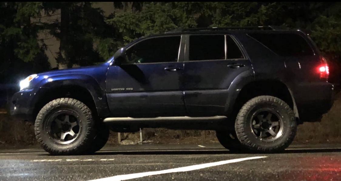

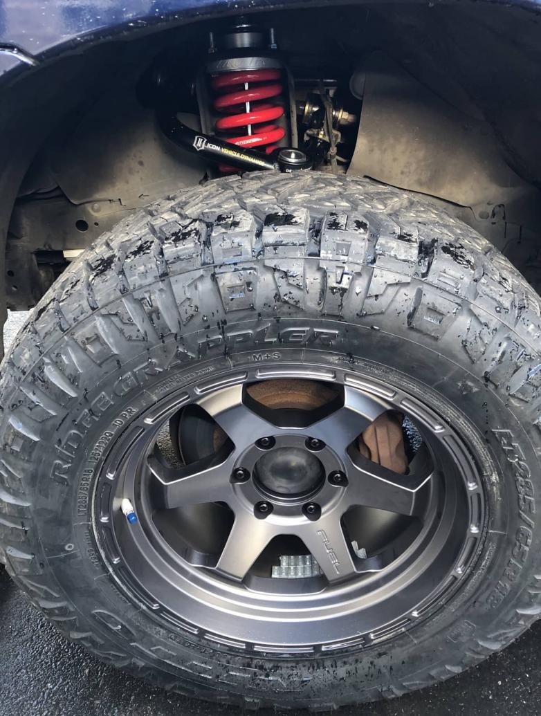

Also V8 AWD. Toytec 3” lift is on. Whaddaya know... vibration at highway speed. Wheels and tires just balanced. Had the U joints greased by installer. Any other ideas?

Apparently the rear slip yoke can be overgreased. When overgreased it impedes compression of the yoke which results in vibration at highway speed. Simple solution is to remove the 7mm zerks fitting on the rear slip yoke. Back up over a curb and compress all the excess grease out. Tighten zerks down.
Will have my install shop try this out and report back.
