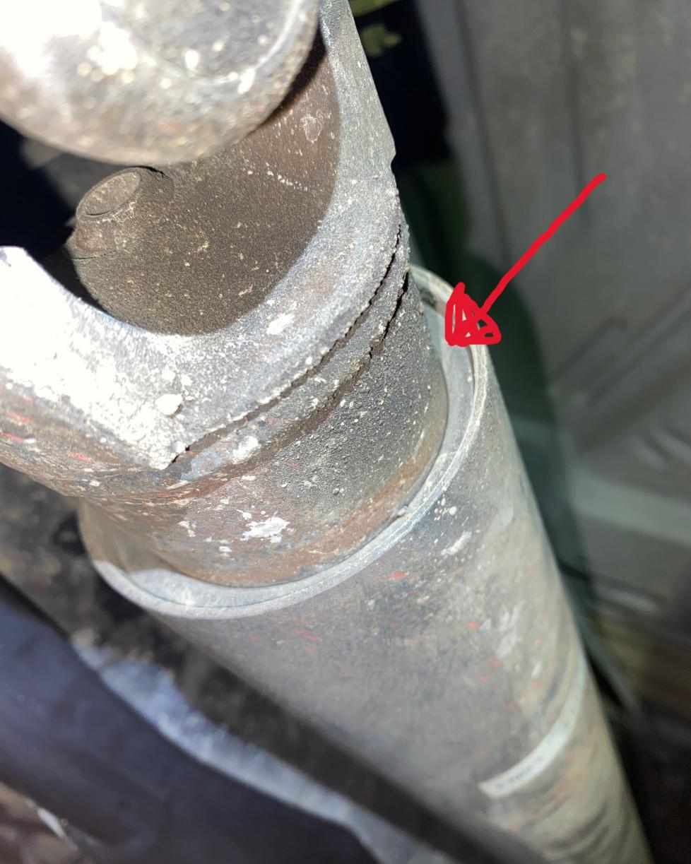

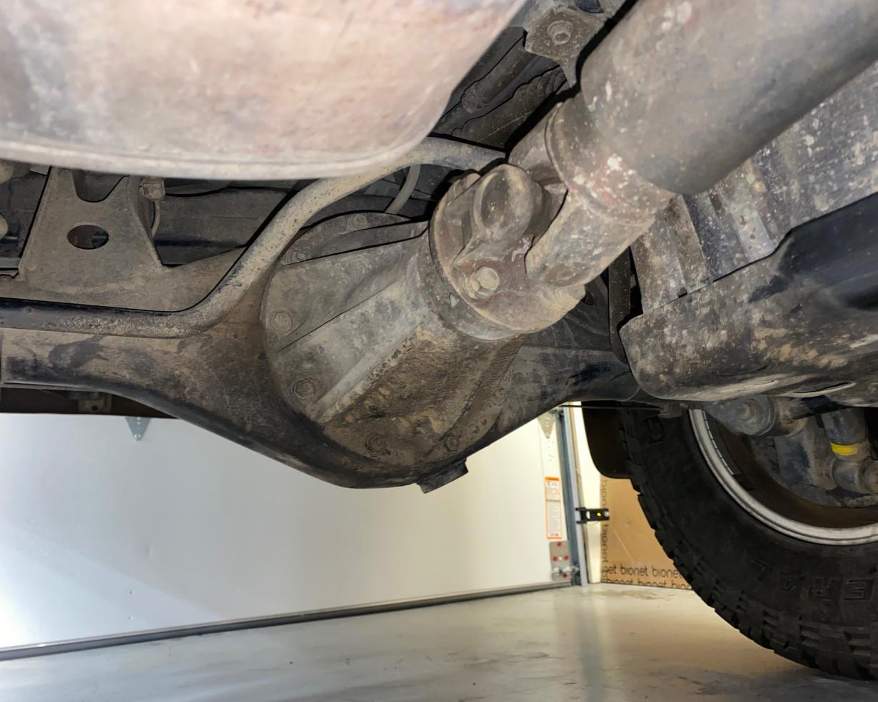

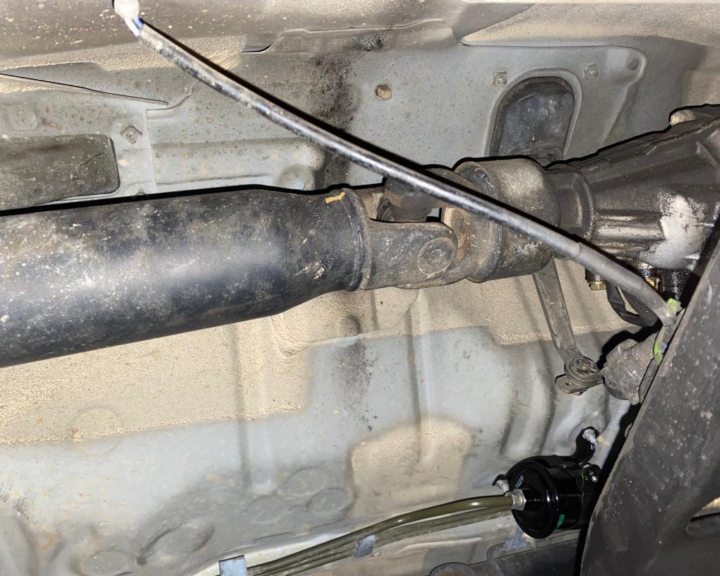

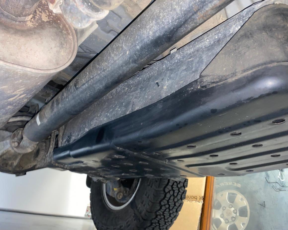

What both of you guys are saying makes a lot sense to me. I guess a bit unfortunate. At this point I think I'll just be buying a whole new driveshaft lol. Those who know old probably original universal joints are probably worn out and along with what phattyduck said about the two piece part. Which I just discovered! Man how did you know that?? I just went out to my truck and took a good look underneath again, I was confused what you were talking about since I've seen my driveshaft before it seemed like it was always just one big piece. I didn't realize it was a smaller inner piece with rubber around it and the outer piece. I will attach some pictures I took I was looking at the back of it on the side connected to the pumpkin and I saw what looked like something separating the two metal pieces and I got my knife out and poked it and sure enough it's rubber. Interesting. Since what phattyduck says is true it would probably be better off to just replace the whole unit. Hopefully that includes new universal joints on it? At least it's easy to do haha!

Just started looking around on the internet. Looks like they just sell the whole driveshafts as a unit. Fresh prop unit with new universals. I'll just do that. I see that rock auto has some and I looked on O'Reilly's. Would this be something I should go OEM (not sure if I can even buy it) or would like a dorman or something be good? Seems like the aftermarket ones have designs where you can replace the u joints easily any recommendations for which one to get? Not even sure what the part # for the OEM one is either it's prolly discontinued or something haha Thanks.
