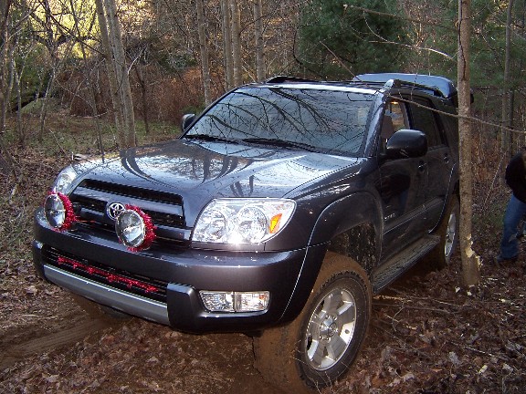

I mounted my LightForce lights directly to the bumper. I did use a backing plate to make it a bit stiffer and some large washers on top as well. I first set it up with a bracket but it stuck out too far and shook at speed. Then just drilled right into the bumper. They sit flush with the bumper so not worries about bumpeing them and they are plenty hight so no bashing on anything. Plenty of room under there to work. May not be the best solution but works for me.
What did you use for a backing plate? Is your installation of the lights solid. I mean is it very rigid with whatever you used for the backing plate?
