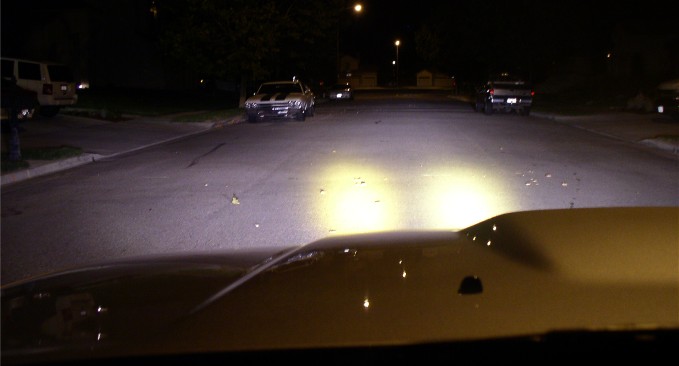

here is a picture of how my lights are adjusted now, i havent even had the chance to adjust them right. how should the really be aimed? apart more? farther up? please help...

If you installed new bulbs, the dealer probably will charge for adjusting it. I haven't checked, but the owners manual may have an adjustment procedure?
I would say the left-right looks pretty good, but bring em up a bit. Park the car 20ft or so away from a wall or garage or something and measure from the ground to the middle of the light, then measure the same distance from the ground to the middle of the beam pattern on the wall. That should get you about right.
